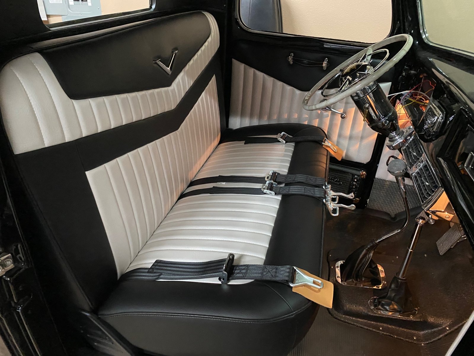

  16. Bandit Billy
    Joined: Sep 16, 2014
    Posts: 16,471
    Bandit Billy
    This is exactly correct. Imagine sitting on the floor with no seat or riser, there would be no place for your legs from the knees down. Keep the riser, and a decent thick seat bottom.
    That is what I did. Glide seat and foam, I had the foam shaved in half in the back. It looks a bit flat compared to the padded seat bottom, but it is still comfortable for both my wife and I. She is only 5'3" so I had to compromise on pedals and column (tilt) position to fit us both.
