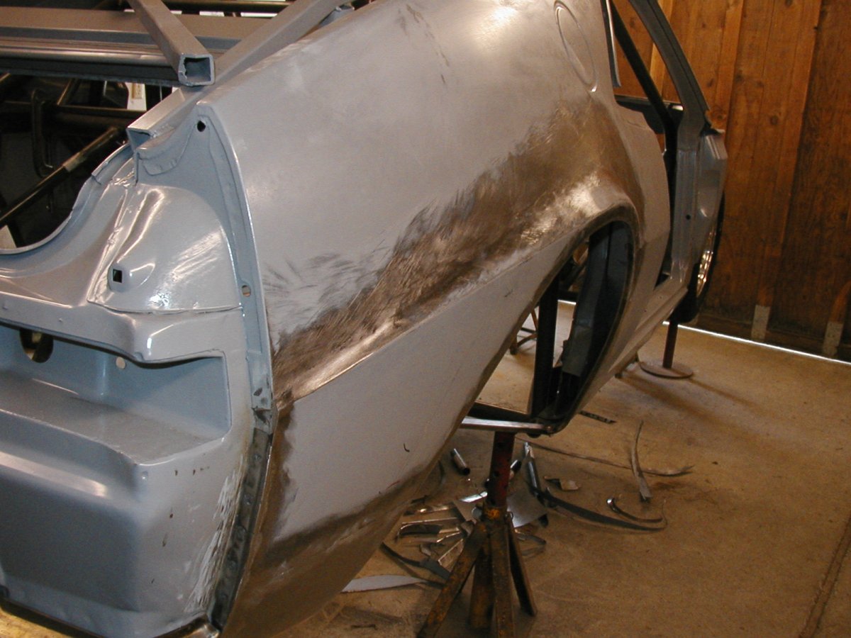

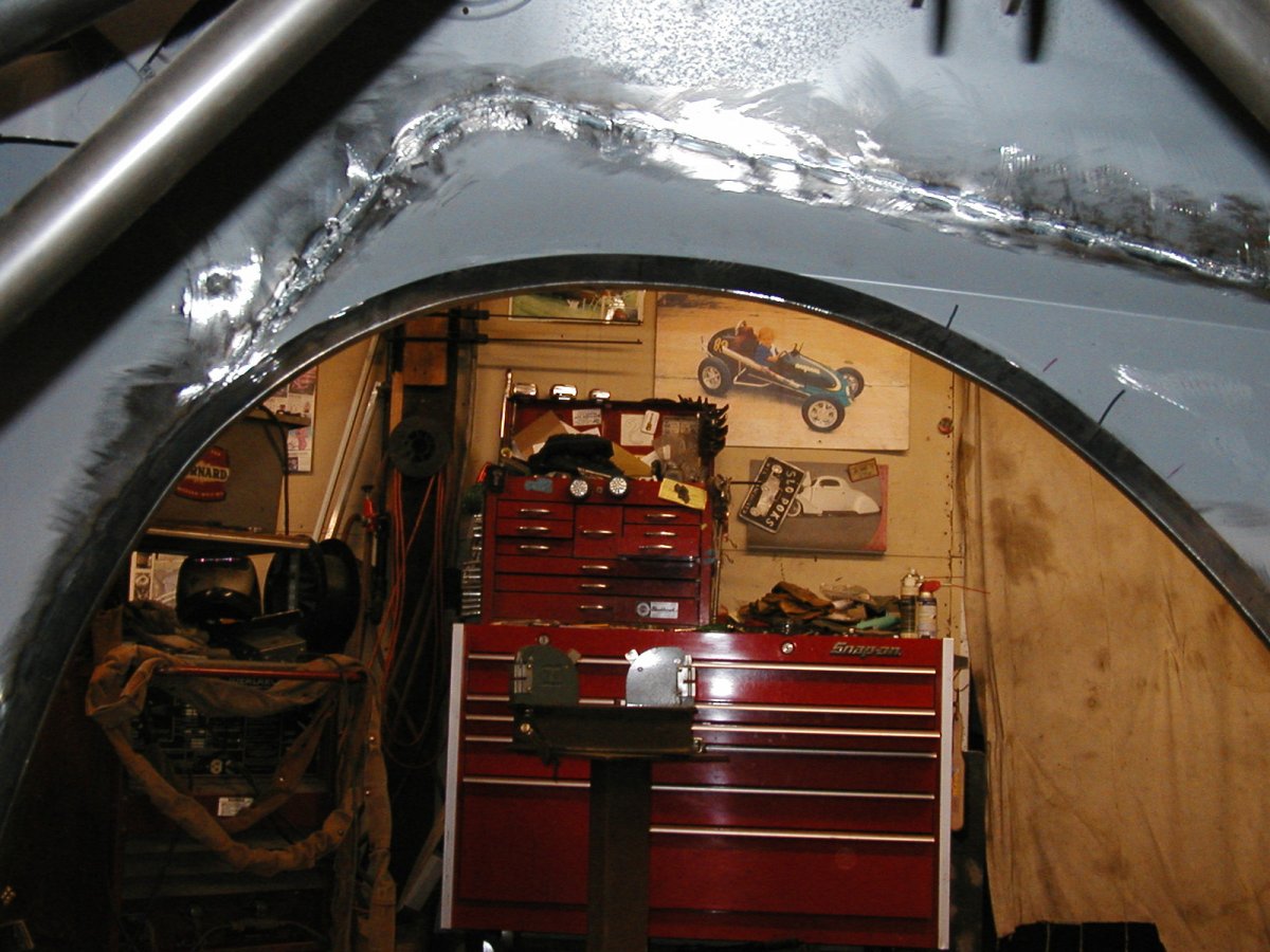

  7. This statement tells me your a production "Body Man" not a metal finisher.
    Disclaimer; I can not show more of this project due to being scolded by monitors because it's on an "Off Topic" vehicle. These photos are just for reference to metal working process:::::
    I've tried several ways to "Metal Finish" seams where access is tough. In places like the wheel house I actually remove it when possible or at least cut access as needed to get behind it with my hand tools. Trying to use leverage just doesn't do the job for me in that what ever your prying against with the Tool ends up with witness marks that then need repair. Then there's the recoil with contact you can't stop. The other reason to have good work access is to dress off the back side of the Weld so it don't fight your finish work.
    Case and point. This weld is pretty fair but not ready to set a dolly on (or bump with a H.A.M.B,er) . How do you dress it if you don't have clear access to it?
    Here is what you can end up with when you have total control of the seam.
  8. In areas where back side access is simply not possible, I use the mig welder and limit the heat affected zone as much as possible to reduce the heat affected shrinkage.
  9. I hear this heat equals warpage and shrinkage often. I do know when excessive amounts are applied it will happen. Part of the job as a welder is to find or know the correct amount of it to make a proper weld seam. When all you apply is the correct amount and control the zone you won't have either. When you get to that point of being a Welder all you have to contend with is the weld itself. Once the weld is planished out any movement in the body panels will return to where they were before you started welding. I never chase a wave out across any panels. Looking at the inside of my panel the work zone is about 3" wide and none of the primer outside it has changed color. That's a controlled work zone. No panel movement outside of it. The piece of tubing on the inside of wheel opening is 1" wide. It is welded on the very edge of the rad. to the tube. Look at the outside, no burned primer and metal finished on the edge. Ya, it took a little while to learn this but it sure make the job a lot easier.

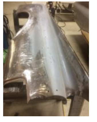

  11. I sometimes remove the part.
    Drill out the spotwelds.
    Metal finish the part and reinstall
    like this 59 qtr.

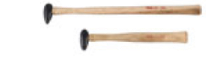

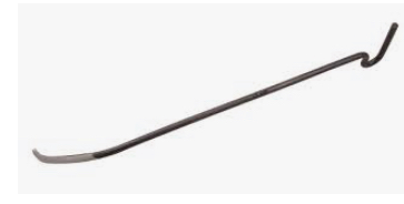

  17. Don’t have a picture but if just a niece of tubing welded to a cheap dolly.
    I recommend these
    C93DB649-7D6E-475C-8602-07585D9C3CEA.jpeg C3F43DD8-BBDC-4D63-9ADE-1F5CE647BD04.jpeg
    the long handled pic hammer is the best hammer ever for bumping on these old cars
