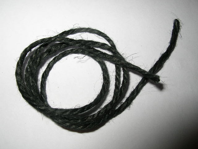

  16. The bench riggers in our sail loft call this Serving or whipping, they finish with a twine called tarred marlin. A very tidy way to finish off the end of a rope. I`m guessing some old Bosun came back from the war with these skills and adapted it to his steering wheel.

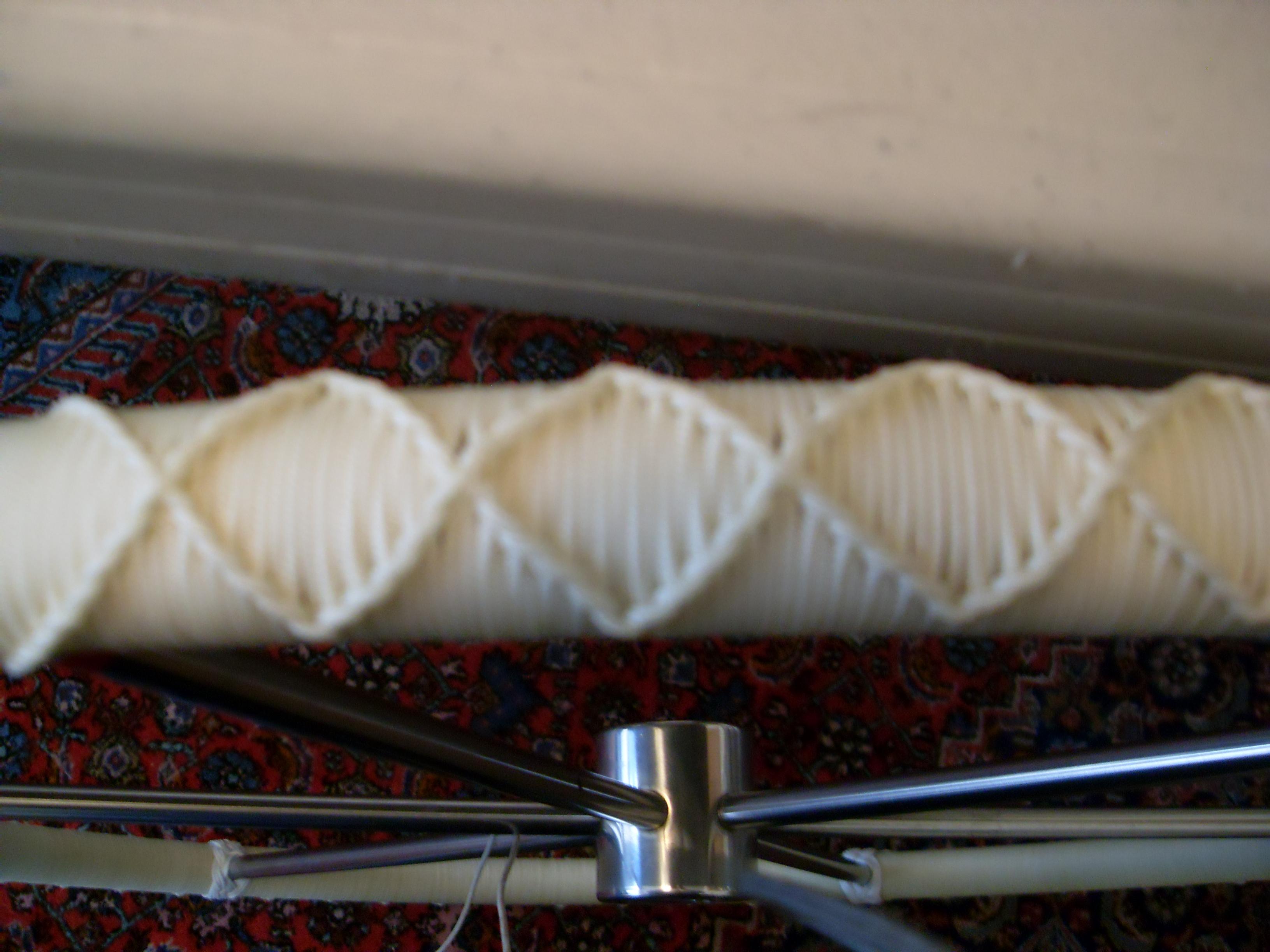

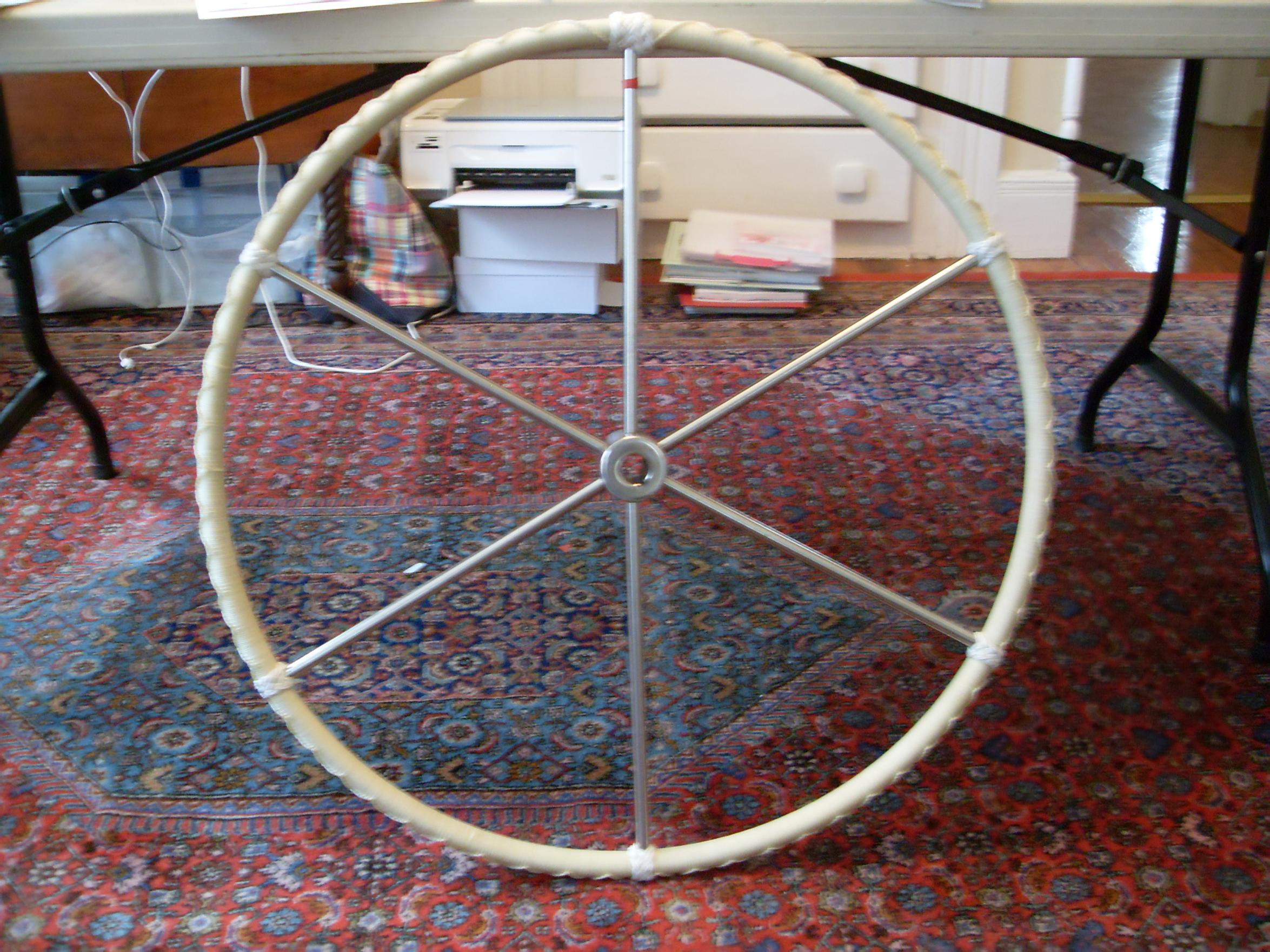

    It can be done and I do actually do this on wheels for boats. The idea is that on a boat with a wheel wrapped in nautical terms is called coxcombing would provide more grip in foul weather. There are a few patterns to use with different difficulty especially to get it to look right. As for the spokes a turkshead knot would cover the gap between runs and spokes. Then a few coats of poly to seal it and your set. Here's a wheel I did not to long ago.

    However this was worked out around the spokes is so smart – I'd like to know specifically how this was done. I think that's the key to making it look good.

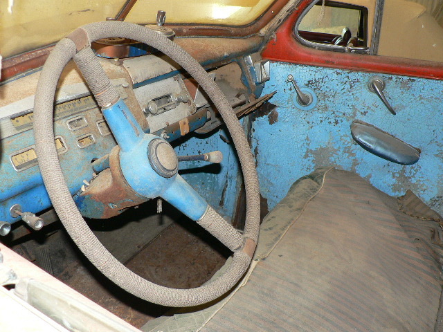

    Here's the one in my '40 Mercury, it came that way when I bought the car. I was thinking about removing it but I think I have changed my mind.

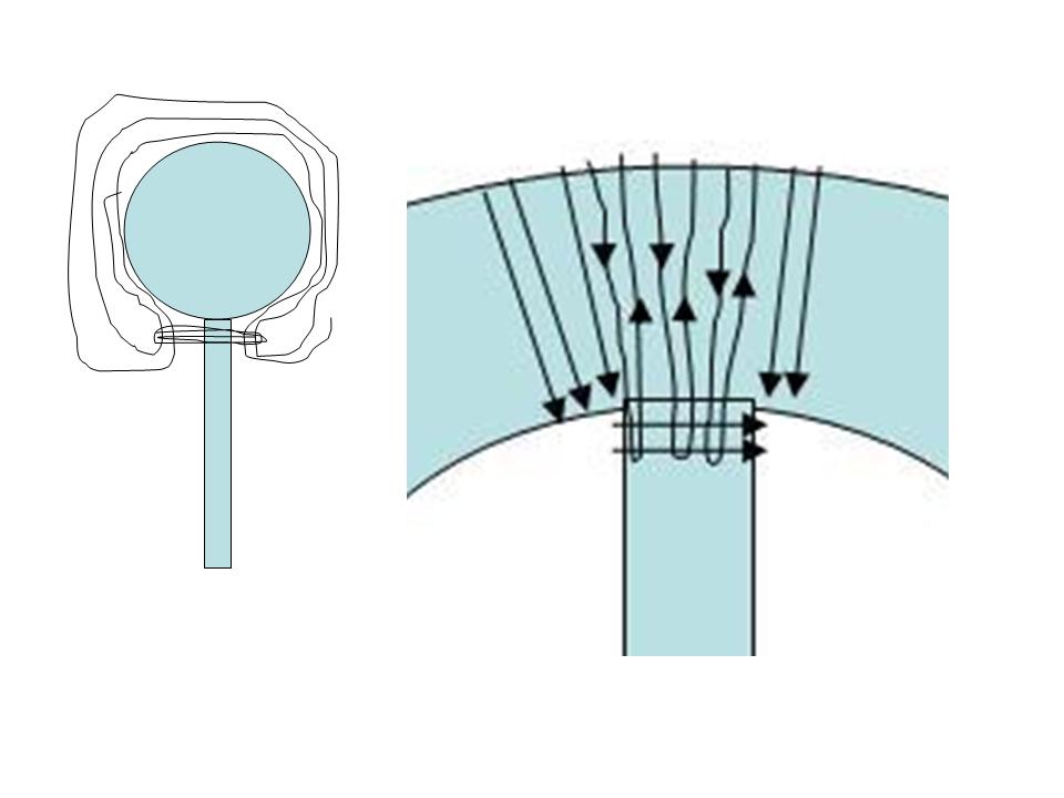

    Kevin, I think this is how it's done. Refer to the really ****py drawing I just did, and start on the left. You are wrapping the twine in the same direction around the cir***ference of the steering wheel. When you get to a spoke, you make a few loose wraps around the spoke, then thread the twine under this loop, around to the back of the steering wheel where you then thread it through the backside of the loop around the spoke, then back to the front, etc. until you get past the spoke, then proceed to once again wrap in the same direction around the wheel. I also made a side view of how I believe the wrap is done through the loop around the spoke. Of course the real deal would look one hell of a lot better.....
    Hope you understand what I''m trying to convey.....
