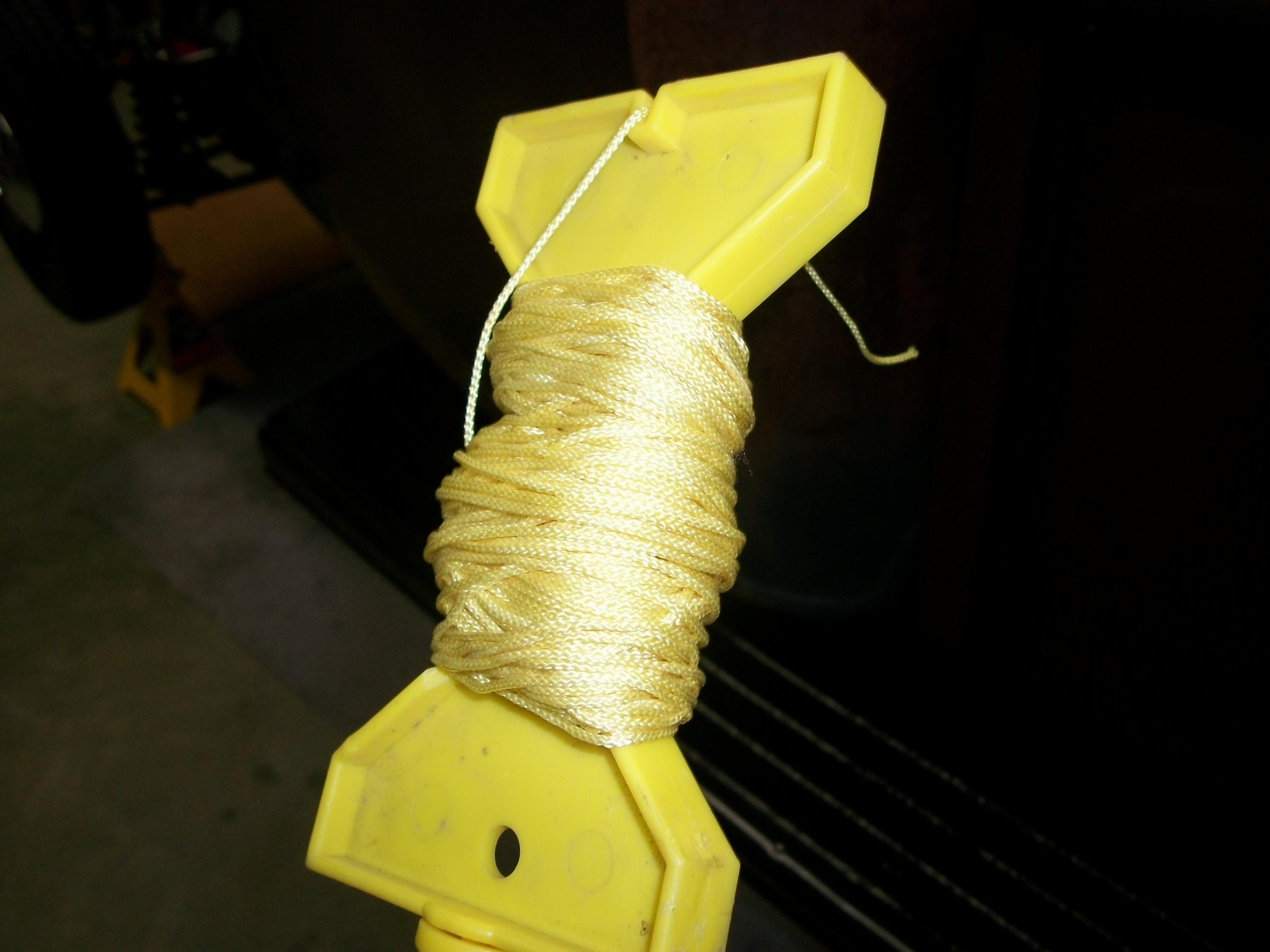

    Ok cool the single French pattern- all the half hitches is the design I also wanted to use if my cord were smaller diameter. Any tricks to doing it that you can p*** on? Pulling nearly 50 foot of string threw every hitch and twist got really tedious is there a quicker way?

    I just wrapped the original wheel in my truck with marking twine and painted it black. Took care of all the cracks and imperfections.
    Sure took a while though.

    Just finished wrapping mine today. Tied the ends behind and then used a paint brush and thinned glue to saturate the tied ends so it wont come untied, and I wouldn't have to make a big knot to finish.

    I used coton packing twine. Then I made a mixture of Elmers glue thinned with water and colored it with acrylic paint. Brushed the mixture on the twine and let it dry.

    Well there is something to be said for thicker stuff, less wrapping! My wheel is 13" diameter, had a padded suede cover that was toast. The rim underneath was about an inch diameter. The rope is 1/4". It feels good to me, not too thick.
  21. Paracord works well, just finished this one today. After I had it all wrapped, I gave it 2 soaking wet coats of water based polyurethane mixed 50/50 with water, and a third coat unthinned. This is an 18" wheel, took 250 feet of 3/16 cord, including 30 feet in each of the turks heads.
  22. Put your string in a bag and p*** the bag back and forth as you work. When I did mine, I had 3 65 foot cords each in a bag. I worked with a maximum of 6 ft out of the bag, when that got used, I would take the cord out of the bag and straighten out the twists, stuff it back in the bag and continue. This is a tutorial that I used. http://www.morethanknots.com/Hitchin.../RBhitch1.html
