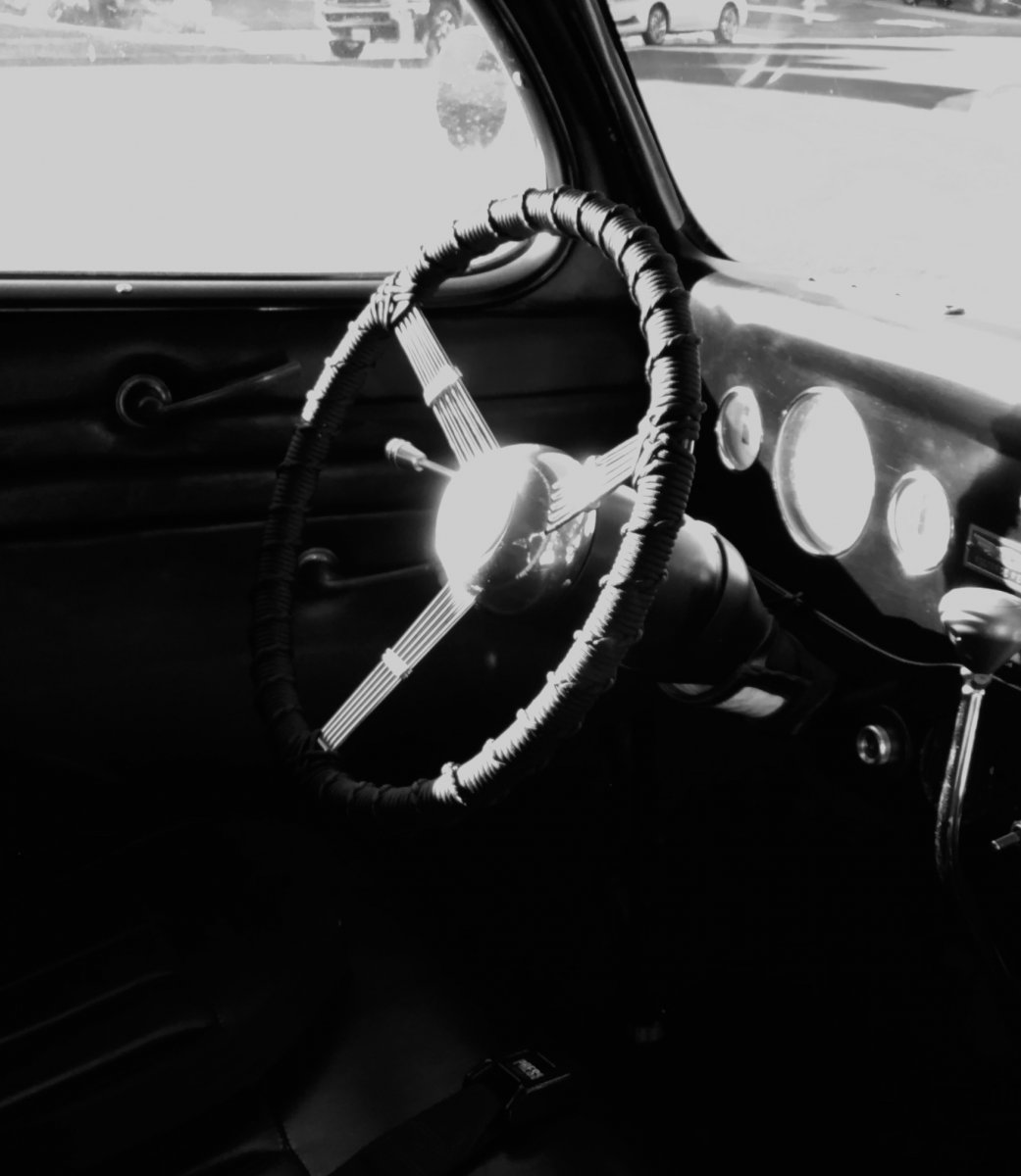

  5. Nice to see this thread back up. Here's a picture of my wheel. I was at the Circuit des Ramparts in Angouleme in September and there was an English guy advertising string wrapping for steering wheels and leaf springs. FB_IMG_1574670935799.jpeg

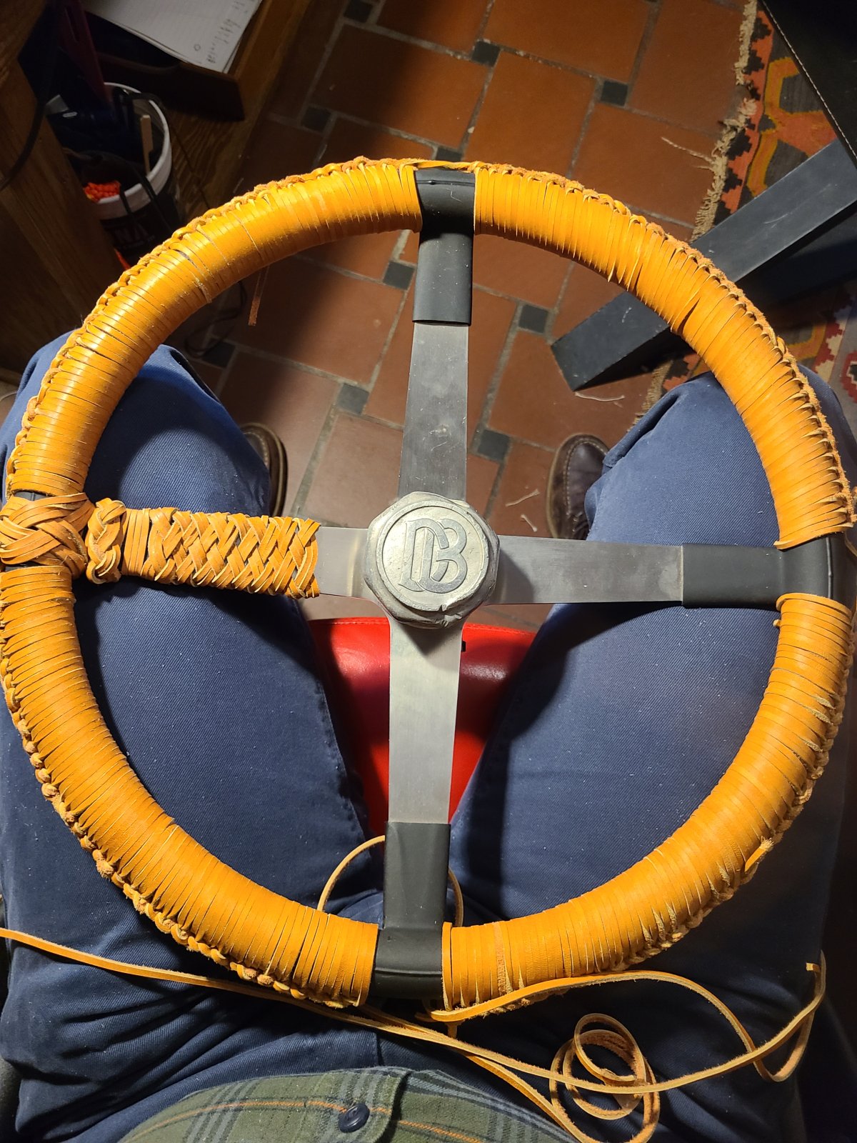

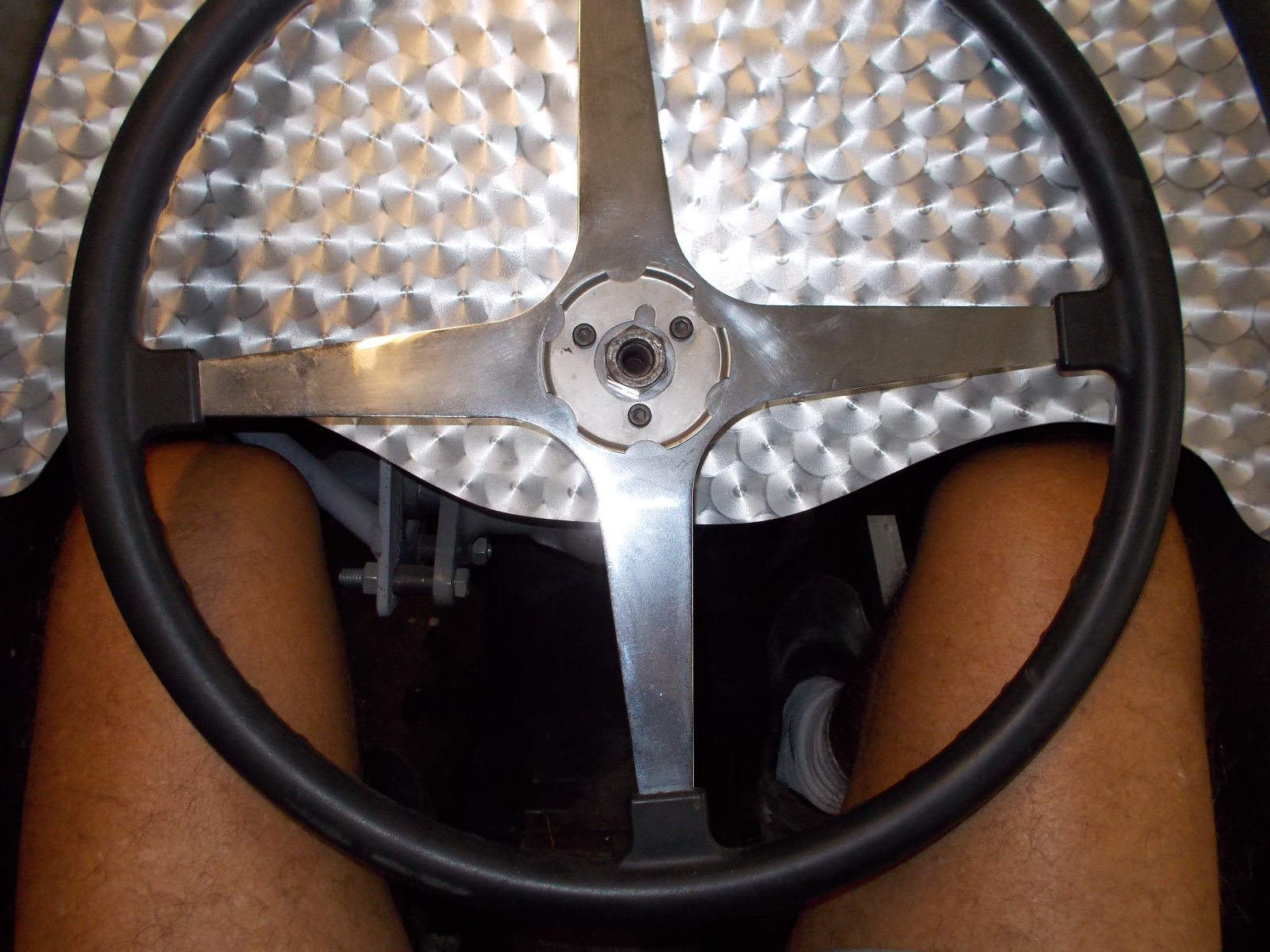

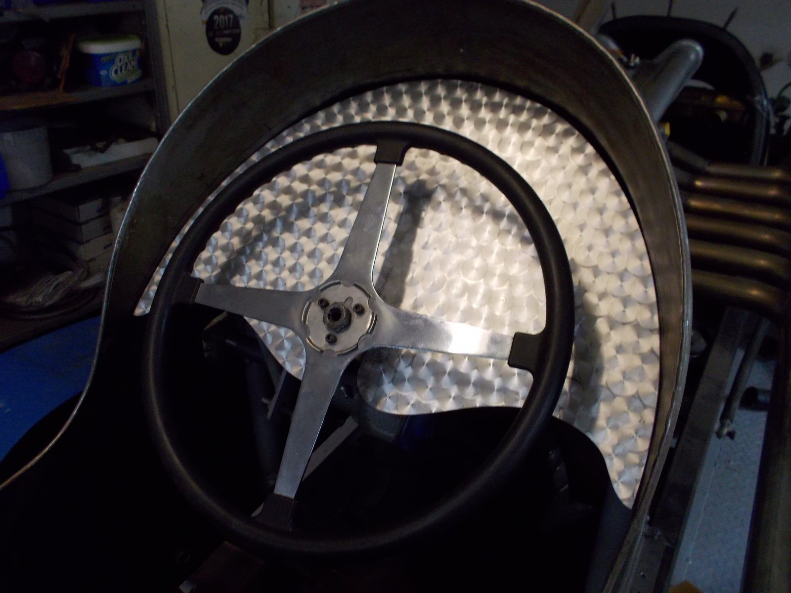

    20230111_095604.jpg 20230111_095053.jpg 20230111_095036.jpg Here's two pics of a Speedway sprint car style wheel I wrapped with leather from JoAnn Fabrics. About to do the other spokes with the same pattern. BTW not a real Dodge Brothers wheel...that's a DB dust cap I will fasten to the wheel later. Making a 'faux' Dodge Brothers speedster.
