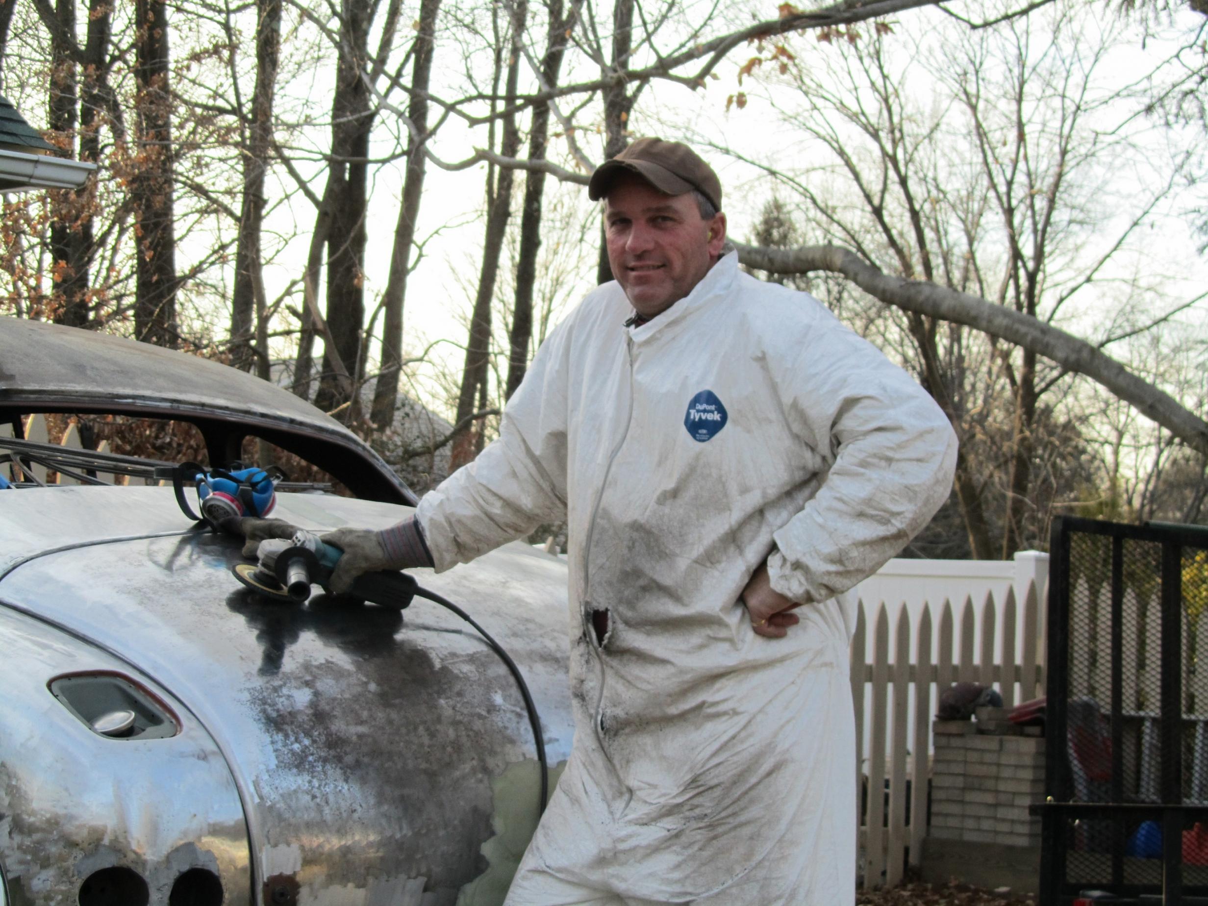

  1. Spent a few more hours today with the 4 1/2" grinder stripping rust areas to clean white metal with flap discs.
    A very time consuming effort...however much needed.

    When I read this title I pictured a 7" angle grinder with a 1/4" thick grinding wheel! Thankfully it looks like you're using a flap disc! Looks good!

    What type of disc are you using exactly? Im in the middle of the same job on my 66 Chevy. Ive been using chemical stripper and a DA
  4. Very cool. What kind of discs were you using in the grinder?

    no flap disc! use a paint buster its easier on the metal, flap disk sands the metal while paint buster does just that busts paint off..

  8. Lowes has their "DeWalt" brand flap discs wich seem to hold up the best. I've tried local hardware stores and their off brands just don't hold up. They were too stiff and not as beafy.
    The troubled areas I started with 36 GRIT --- 60 GRIT--- then 80/120 GRIT.
    I didn't want to spend the $$$ to get her blasted...call me cheap, so I did it myself for about $55.00.

    that was my thoughts. i used about 5 of these and about 15 hrs.

  11. Skyrodder, these are awesome! I used them to cut the painted surfaces to the metal and then took care of the rust!

  13. I still have the roof and "A" pillars to do and so far the clock was 14hours. My guess is another 6 hours

    i am not completely done myself. it really is not that bad to do. less mess than stripper and cheaper than blasting. car looks great by the way

    I use a 3m pad on a polisher/sander does a good job but I still hate it:rolleyes:

    I used a twisted wire wheel(s). I did a whole truck with them. They don't remove metal. They do bust rust and take out seam sealer/bondo too.

    Rapid strip is the way to go. Works very well. Your hands will be shaking like a old man at the end of the day but it's cheaper then blasting!

    i also like to strip with aircraft stripper and the "da" but i like using the larger "hog" sander it has been the best for me.beside walnut shells

    the paint buster discs tend to clog with paint and primer in a few minutes and don't work so well after that. i'm stripping a '50 cadillac now and that's what's happening. some paint may be easier to strip with them. this stuff doesn't wrinkle with aircraft stripper either, just turns into a drooly goo. i guess it's going to be the drooly goo method, after spending $100 on a bunch of those pads.
