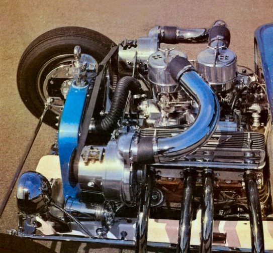

    Slight change of plans on this engine build. Im going to build a lakes style car with a twist. I will be running a VS57 McCulloch supercharger and a Marine interceptor intake. I have already had the air tube made that will connect the 2 side draft carbs to the supercharger. It only needs the T section made to run to the supercharger.
    The carbs on the interceptor intake are the same ones used on the turbo corvairs so I know they will work being pressurized.

    Corvair carbs were draw through not blow through-
