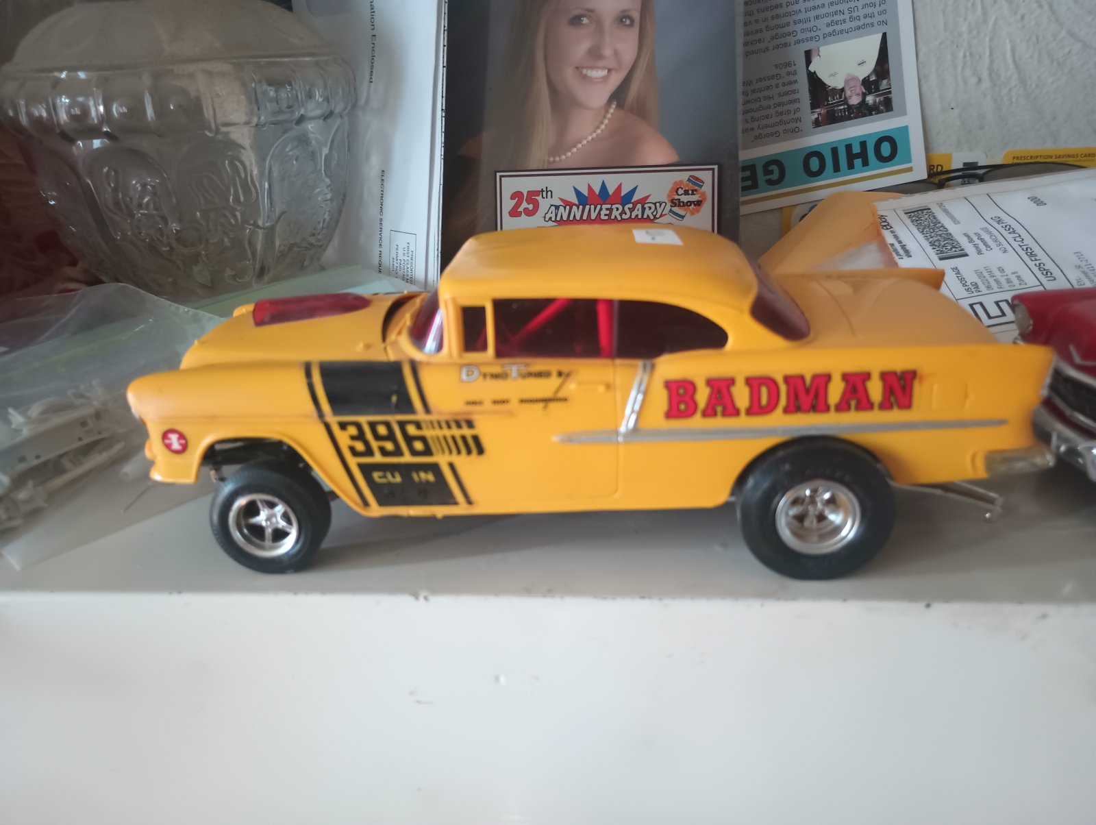

    Picked up this 55 Chevy model today and the decal says 396 but it actually has a small block,I built this model back around 1973 and did not know all about the engines available back then so that gets me wondering could a small block back in the 60s be punched out to a 396. Most likely typical model false adverti*****t but could it have been done IMG_20240629_133727411.jpg

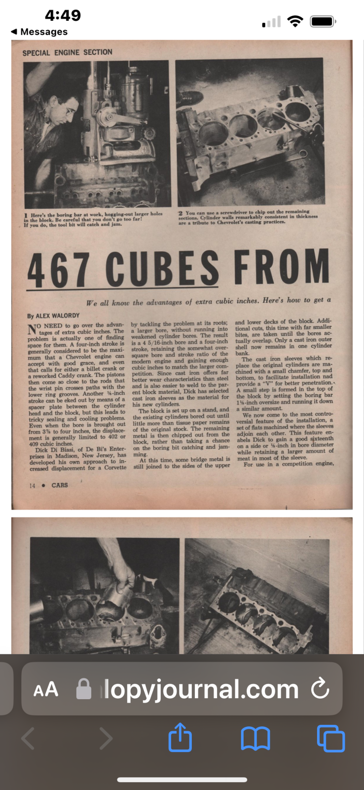

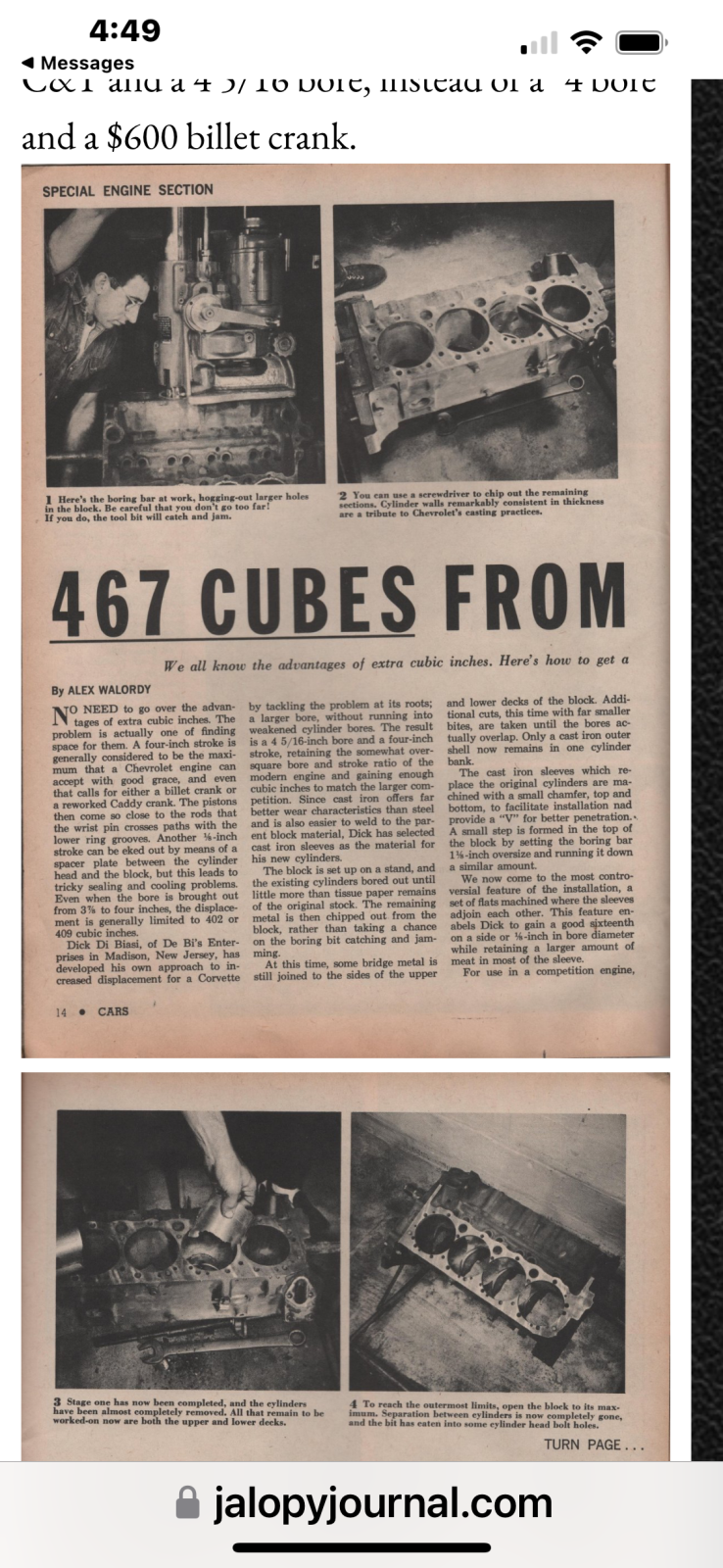

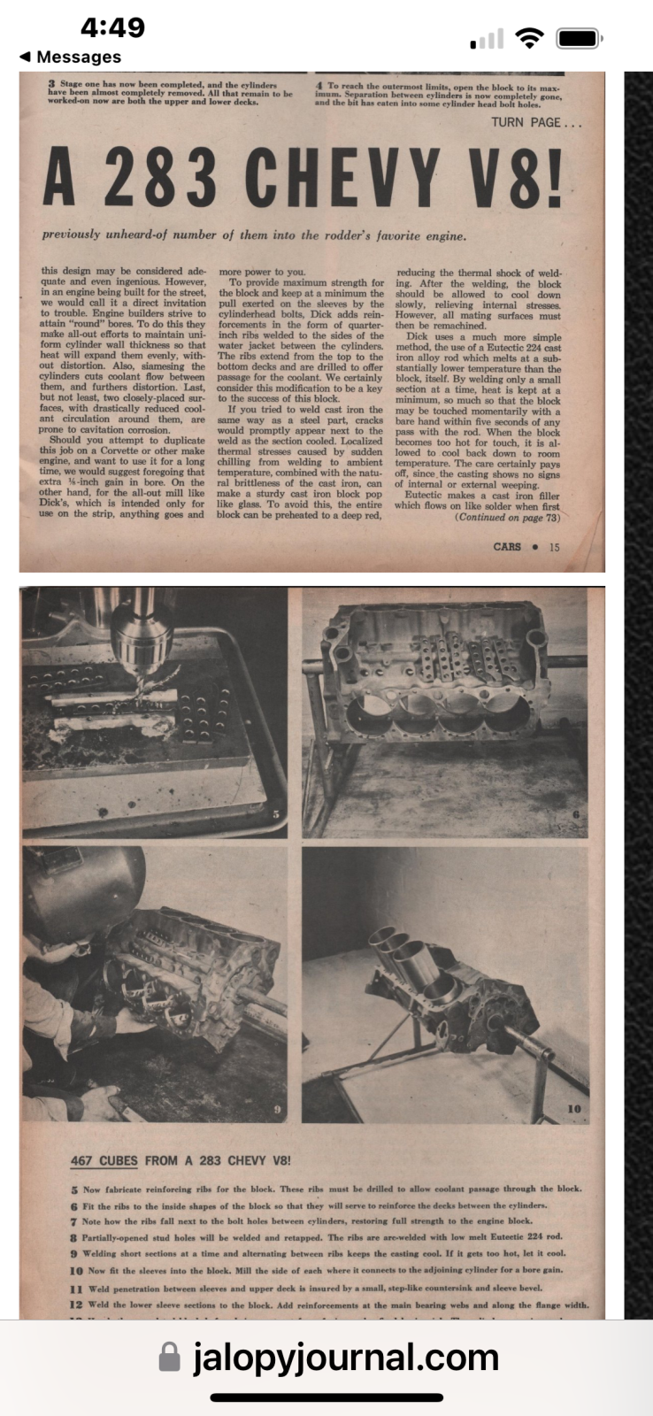

    View attachment 6113158 View attachment 6113159
    Yes sbc 283 to 467 cid
    In 1958 ish just needed look/ know one that thought out side box!!! IMG_1828.png IMG_1826.png

    I don't believe there was ever a 396 small block. Someone used some leftover decals on your model. A bored out 283 might be called a 292 or a 301 depending how far it was bored but that was about the limit. For stroker cranks who knows.
    Of course later on Chevy made 327, 350 and 400 cu in small blocks but not in the fifties.

    Those 396 decals actually came with the model as I built one but at that time knew nothing about engine sizes and most likely thought that was what was in it but I know better now. Just false adverti*****t and most kids would not know the difference and could imagine that amount out of a small block back then was very expensive. Thinking about putting a big block in that model if I can get it apart with out damaging as I think.its a early 70s model but most likely will go on the shelf as is

    I will look for complete article ,
    5-6 or so pages
    Between 1958-61 but I believe 58

    Gimpyshotrods
    Here is thread/ post from a few years ago , CARS The Automotive Magazine
    article was in September 1961
    As some might remember a few years ago i posted a thread about how to get 402 cubic inches out of a 283. https://www.jalopyjournal.com/forum/threads/402-cubic-inches-from-a-283.1004739/Recently I found a copy of "CARS The Automotive Magazine" from Sept. '61, on fleabay with an article on how to get 467 cubic out of a 283!:eek: The main difference is the crank is a Cadillac crank reworked by C&T and a 4 5/16 bore, instead of a "4 bore and a $600 billet crank.
    [​IMG][​IMG][​IMG][​IMG][​IMG][​IMG]

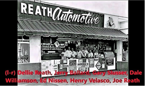

    Our local "go to" place and for most drag racers in the So Cal area Reath Automotive was all things hot rod/drag racing. Later on, when touring was in vogue, out of town racers all headed to Reath Auto for parts, motor work and information on builds, etc. The staff on hand were some of the hot rod/drag racers that were the fastest racers around and regulars, at the local Lion's Dragstrip.

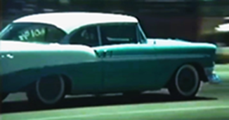

    One of our other friends did have a two door 1956 Chevy Hardtop Sedan and it was very nice. Plus, it was one of the fastest cars in Bixby Knolls with a modified 265, then a bored out 283 + dual quads, then a larger 283 block bored to a 301.

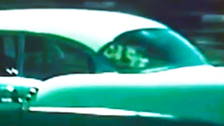

    upload_2024-7-9_3-21-43.png The guy with the 56 Chevy was one of the early guys who started modifying his car. He liked being the top dog at the teenager hangouts and gabfests. The facts were slowly coming to light.
    The reversed photo to show white shoe polish cl*** identification... C/Gas or C/Stock?
    The reversed photo shows the Lion’s Dragstrip cl***ification. We knew back then, but for all of these year later, the cl***ification is a mystery. A 265 would put the 1956 Chevy in C/Stock... whereas, the 301 or 352 SBC mods would have put him in C/Gas.
    There were very few 301 SBC motors in a 1956 Chevy or for that matter, any Chevy sedan back then. The only other guy may have been Tom McEwen and his string of 55, 56, 57 Chevy sedans with modified motors… Of course, we all have seen the Lion's Dragstrip cl***ification photos showing D/Gas or C/Gas... Same neighborhood, same high school, same Chevy sedan type, but different timeline listing.
    But, the topper was and still is a mystery, the 56 Turquoise/white Chevy may have had a Stroker Kit from Reath Automotive to create a huge 352 C.I. SBC motor. No one alive ever had proof, although we did see the 56 Chevy Bel Air in action.
    Then he ruled the streets for a while. I filmed him at Lion’s Dragstrip, but cannot remember if it was in C/Stock cl*** or C/Gas Cl*** and which motor. It all looked stock at first inspection. If we ever got to raise his chevy hood. But, closer inspection only gave anyone a stock appearing Chevy v8 motor.

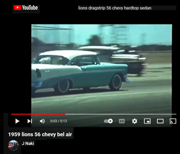

    Lion's Dragstrip
    As far as the tech inspectors were concerned, it was never torn down under protest and when the hood was raised, it could have been in a stock car cl*** or any designation given. It was stock appearing, even with orange factory colors.

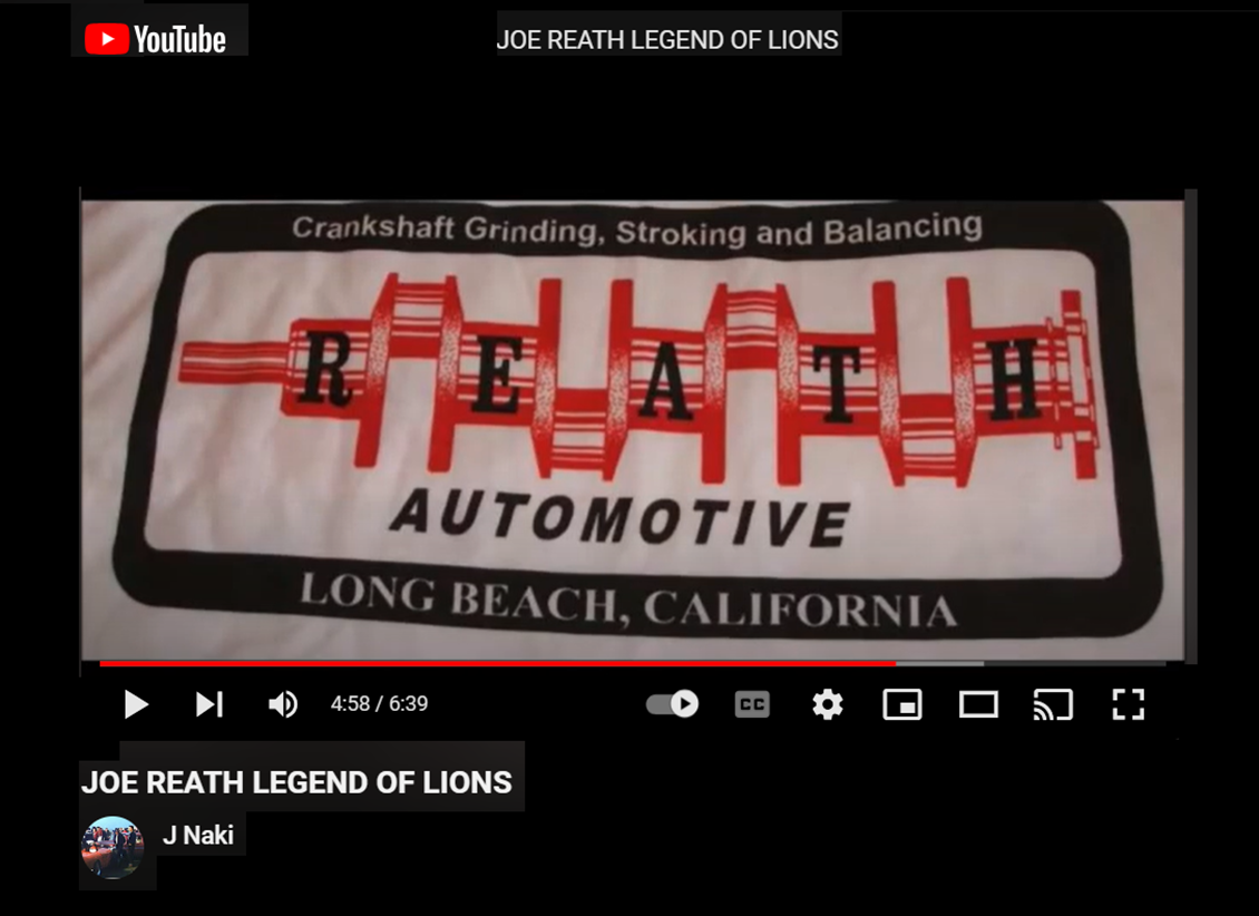

    At each “rumored” build, he denied any improvements… (“it came that way…”) But, the last straw was a 352 c.i. SBC, bored and stroked Reath Automotive crank kit and pistons… for the street superiority at the time. A very strong “rumor…”
    https://www.youtube.com/watch?v=gCb8smHguN8
    So, what was the mystery ?

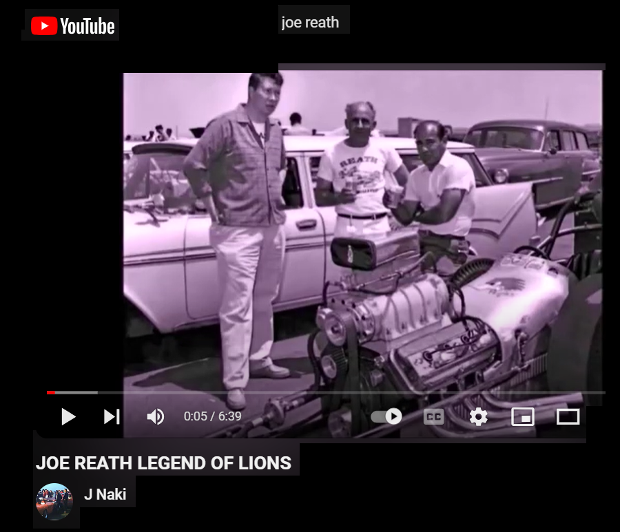

    upload_2024-7-9_3-28-44.png Reath Automotive was well known for its fast flathead builds. He even tried to sell us a stroked flathead that was the main floor display model. But, a lot of local racers had Stroker kits from this shop in Long Beach, at 10th and Cherry Avenue.
    When they moved to the big corner lot in Signal Hill area of Long Beach (still on Cherry Avenue) that same old homey feeling was waning. (But, the new, big corner store was a couple of miles to the famous Bixby Knolls, Cherry Avenue drags location…that was handy.)

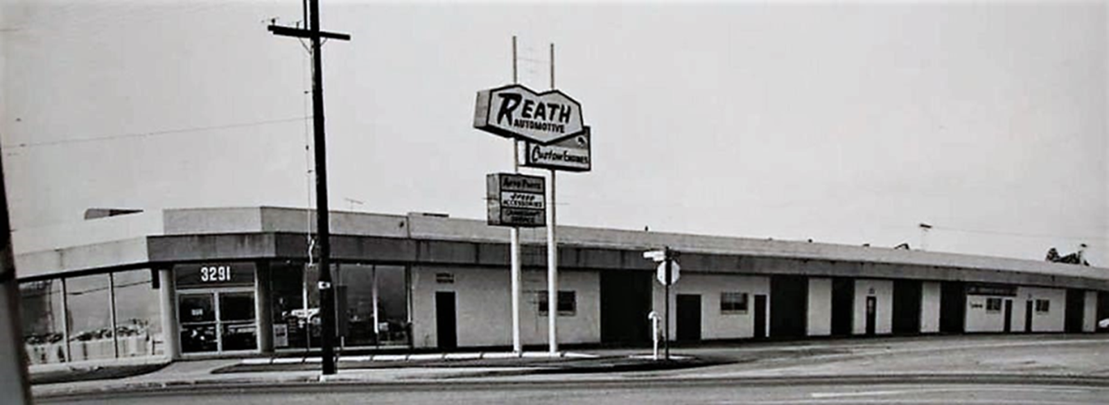

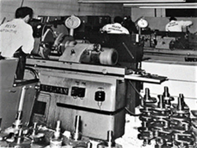

    upload_2024-7-9_3-31-47.png It was a far cry from the early beginnings in the small corner shop on 10th Street. This was the epitome of a speed shop and build/machine/working hot rod/drag racing garage that almost took up a whole block.
    "This was the hot rod/drag racer's dream shop... plenty of space for machining, building, on the spot repairs, and a huge showroom full of the latest stuff. Everything possible in parts and service was in stock. Including more words of wisdom from the big master himself, Joe Reath. But, we all could see the glory and different at***ude of the whole drag racing parts/racing/building scene with this new shop and in the coming years, the whole drag racing scene was changing, too."
    The huge corner store on Cherry Ave and 33rd had everything, a large showroom, multiple machine shops/ working garages, tons of ready to buy motors, parts, and the displays were like a museum, all laid out in an orderly fashion for every hot rod/drag racer. They had hit the big time and outgrew that original small store on the corner of 10th and Cherry Ave.
    After moving to the huge corner store on Cherry Ave and 33rd and staying for several years, they finally moved to a small industrial building on 28th St. in the Signal Hill area of Long Beach.

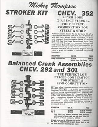

    Later on, even Mickey Thompson got in on the Chevy crowd’s hungry appe***e for the “need for speed.”
    upload_2024-7-9_3-43-23.png A safe modification for street and drags in a safe and sane build kit. No outlandish "who could make it bigger or biggest..." etc as in some articles.
