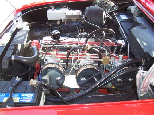

    Here's what I built for my 292 , I mateded a Clifford and 2 datsun 240z manfolds together and a lot of other creative re engineering . I've haven't got it running yet but I'll let u guys know how it turns out when when I do .
  13. squirrel
    Joined: Sep 23, 2004
    Posts: 58,622
    squirrel
    That's neat! Did the datsun use SU carbs or a copy of them?
  14. Cody Walls
    Joined: Nov 14, 2008
    Posts: 1,574
    Cody Walls
    Yes datsun made there own copys of the European verson , the early verson are good carbs , the later ones are junk .
