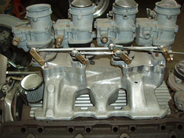

    With in line set up,you could just use 2 mid carbs an bring in the 2 ends last/late=Would just be a mod 3x2 prog. with two center carbs moving together. Something like this. Look around. https://www.speedwaymotors.com/97-9...DwN1IjuypWukui6WamodVh2xUZyHIXgxoC0FAQAvD_BwE
    Or do all 4 at the same time; Thats what I do,with my 4x2,mine is home made intake and linkage
    =but my own are not in line{ its a box lay out/so can't do them anyother way. I'm using 94s, homemade linkage n fuel log. 001 (4).JPG

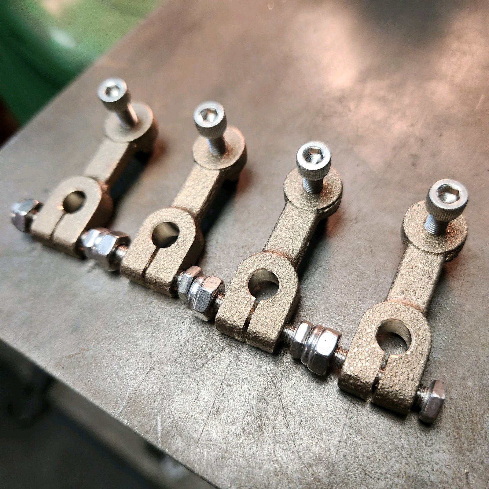

  8. NealinCA
    Joined: Dec 12, 2001
    Posts: 3,592
    NealinCA
    [​IMG] We initially set this 4x2 straight linkage up using cheap Speedway type arms. As stated above, they can and will slip on the shafts, especially with the amount of load 4 carbs adds to the linkage. I ended up finding some heavier cast bronze arms and that solved the issue.
    The RH/LH threaded heims do work nicely for straight linkage. I am currently setting up a similar linkage for the 3x2's on my 32 5w.
    GordonC and Tim like this.

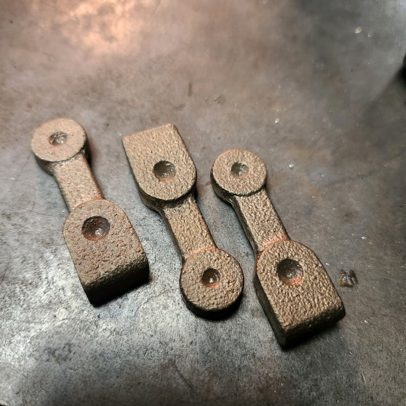

    The roll pin idea was plan B, but these did the trick. A friend bought a box of these unmachined bronze castings at an Edelbrock yard sale (when they were moving). I drilled and reamed them for a tight fit and they have stayed put.
