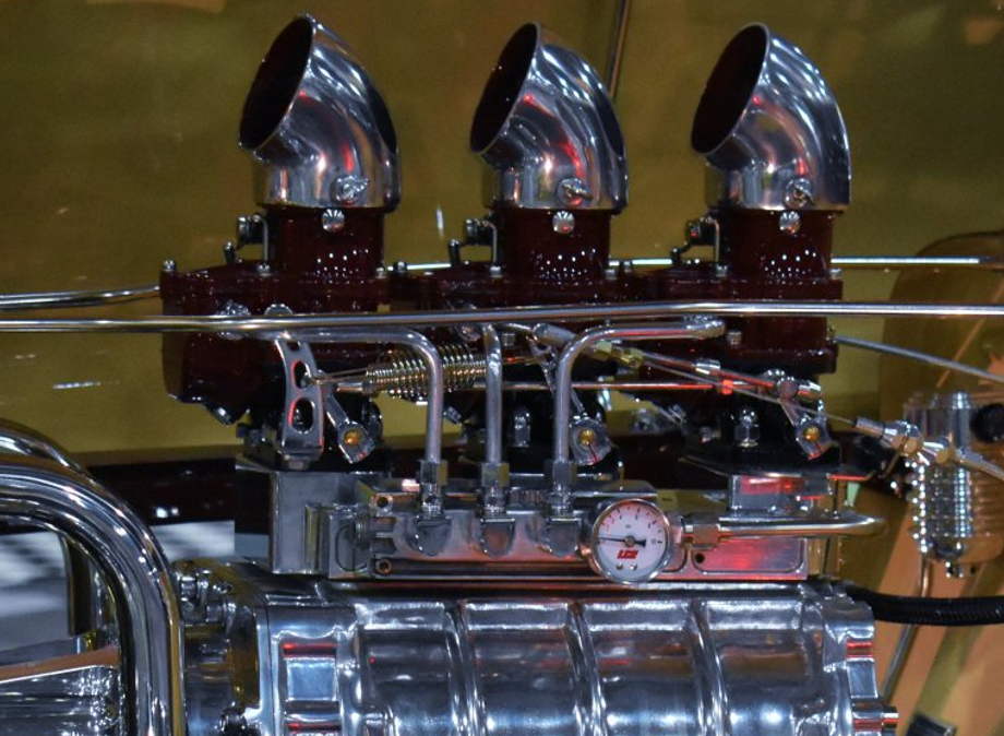

    I have three 97's from Clive on my roadster and I installed snap back springs on all 3 (heaviest in the center). I still encountered the fast idle issue. I ended up using a Stromberg block pin, in lieu of the ball/spring in the fast idle/choke mechanism on the fore and aft carbs since only the center one is choked. That helped as my blower was ****ing the blades open at WOT on the outer carbs.
    The issue remained however, and I added a return spring to pull the carbs closed. To be specific I found that pulling the center carb closed with the additional spring, dragged the other two closed with it. I think it is more to do with my progressive linkage than the carbs themselves. It works fine now and has for a couple of years. I stretched the spring to ease the throttle pedal tension and it drives with little effort on the loud pedal. I am not crazy about the look of the spring, even though I fancied up the forward bracket, so I am paying attention to your fix. Regardless of the looks, no more 1200 RPM stop lights.
    I see in this older pic I used 2 springs originally, that was overkill, I now run only the outer (larger) spring.
