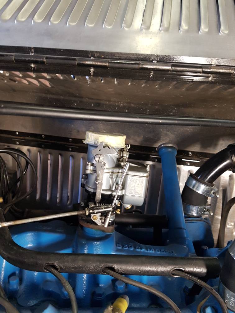

    I've fitted an 8BA into my speedster. The 8BA manifold is designed for a tilted engine. As it sits, my Stromberg is tilted forward 5.5 degrees.
    My question is: is this going to effect the operation of the carb? 20181210_093905.jpeg

    Not a problem. Your carb will just think it is going down hill a lot!

    Stromberg floats are hinged at the side. I wouldn't think that tilt should matter.

    Normal manifold. Early Ford v-8's sat level in chassis, late models and also Model A's had significant rake.
    I never hears of any negative symptoms from using the late raked manifold even on cars with dropped fronts adding to the slope. It the look is bothersome go to a PCV system for (better) ventilation and some simple parts swapping to get early carb and pump in there.

    Ed, There are carb shims for 97's available. Try Ebay or vintage speed in Florida. Joe

    I've used a 1932 K-member. The engine is only as high as it needs to be to put a very slight incline on the torque tube. So that the axle oil drains back.
    The engine itself is then absolutely level, like it is in all early cars.
    The reason for the carb tilt, is that's it's an 8BA, an engine designed to sit nose up over the front crossmember.
    I place my engines much lower than most builders do.

    The 8BA style engines are tilted to allow a lower drive shaft tunnel because of the new Hotchkiss open drive lines and hypoid third members.
    The '49-up engines actually sit behind the front cross members, not over them, just like the early V8s.
    One solution is to use an early intake on your 8BA to level the carb(s), as I have done on my '32. :)

    Early intake with a PCV or other tinkering to keep the fumes moving out, or correct the tilt. I think the easy way with this engine with iron manifold would be to simply anchor the studs (if they are even moveable after 70 years) with Loctite, stuff, saw them off, and mill the area flush. Drill and tap vertical...should not be hard to achieve sufficient accuracy! Or the probable best way: ignore the whole situation. This sawap has been done forever, and is now even more common as the supply of 59's runs low, and I have never heard of anyone noticing a problem. It just looks like your carburetor is in a hurry.

    The Navarro tripple intake I'm using on my '32 is unique in that it has early style level carb bases along with later 8BA provisions for road draft and oil fill, allowing stock 8BA plumbing if desired, or hiding a pcv under the intake like I did.
    Crankcase ventilation is something that does need attention when using early/late intakes on late/early engines.

    My solution for fixing the carb tilt on an 8BA is to mill the carb surface parallel to the bottom side of the intake.
    About a 20 minute job including setup.
    The carb studs or bolts don't care if they are a little crooked.
