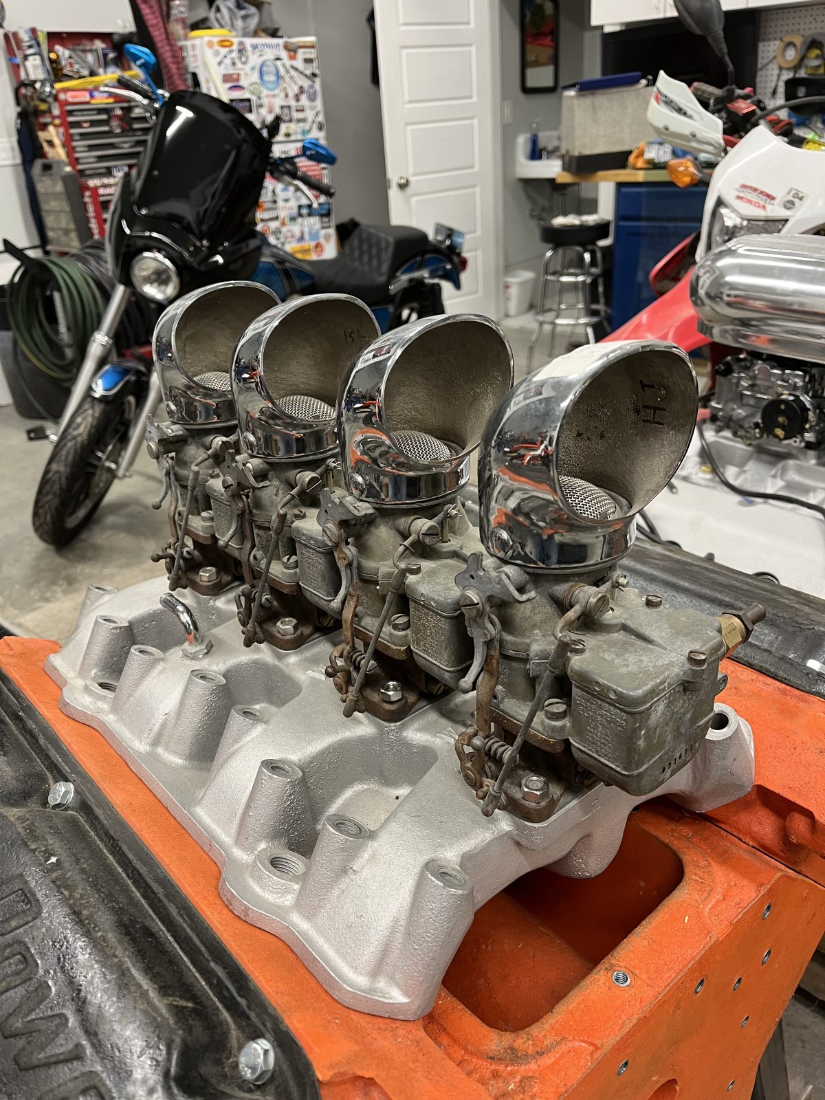

    Are the Stromberg 97 and Big 97 physically the same size?
    My Weiand manifold currently has the standard 97s on it and I’m wanting to upgrade to the big 97s but there really isn’t much extra room between them. This Hemi is pretty ****y and I’m thinking it’s going to perform better with a little more flow. It’s scheduled to go on the dyno in late January and I need to have things ready to go by then. IMG_8713.jpeg IMG_8706.jpeg IMG_8707.jpeg IMG_8708.jpeg

    i believe they are the same size, these are big ones, i can compare them to the 81's i have on my dodge weiand 4x2 when i get home.
  3. IIRC, the carburetors are physically the same outside dimensions, but the difference is internal. contact Max Musgrove as he is the Stromberg Guru as well as a dealer for the new Stromberg carburetors. " info @ 97express.com"

    I am currently running one of the new large 97's on the 401 Nailhead in my new coupe and seems to be OK. After I get a few gremlins sorted I'll sort out the other two regular 97's on each end of the manifold and the linkage to suit.
    And for the OP, I replaced an OG 97 with the larger new version with no problems.

  8. IMO, and that of others, pay the price and get the Stromberg carburetors from England, through USA distributors. The much less expensive knock off carburetors are made in China. Do I have to say more.
  9. I'm with Nick . . . stick with Clive and the Genuine Strombergs. The Big 97's flow 250 cfm (versus 162 or so with the regular 97's). I have no idea as to the specs on your engine, but it would sure seem that the larger carbs would make more top-end power . . . the question is whether or not they hurt low-end power. My guess is that you'd probably be just fine with 4 of them. Heck, worth a try! LOL
