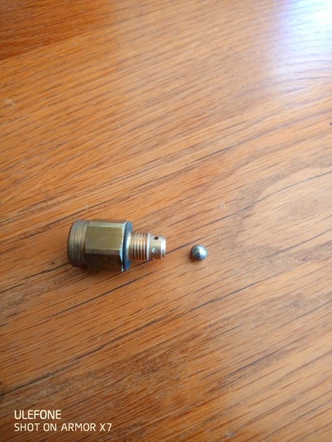

    The fuel inlet valve, the Grose type in new Stromberg carbs it has two ball bearings instead of a needle.
    https://merakgroup.com/weber-needle-seat-versus-grose-jet/
    The swaging on mine was faulty and the balls fell out, I retrived them both out of the float bowl, but the tiny one rolled off the table never to be seen again.
