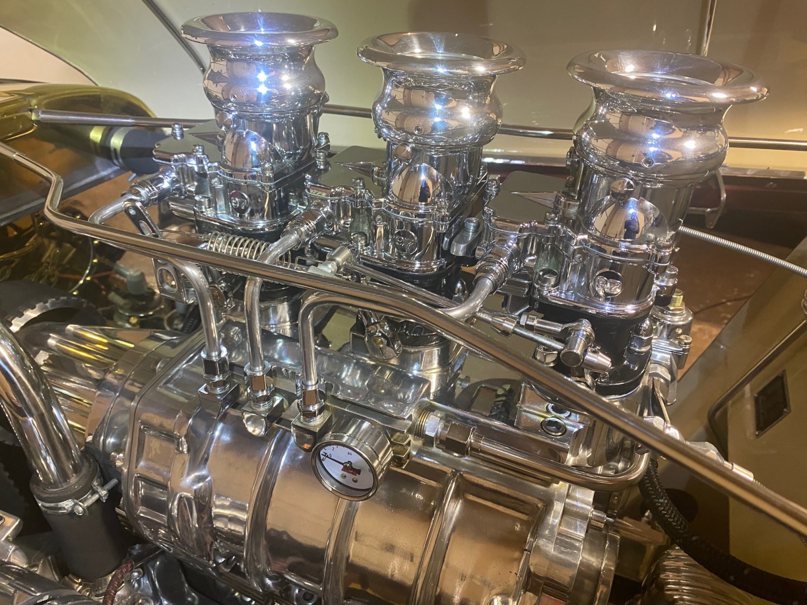

    Let me tell you a little story. 7-8 years back I purchased three new 97's from Clive @stromberg-97 on here, they were not cheap, but neither is building quality Hot Rods. He even asked for my paint code for my flathead and painted them to match, added chrome linkages, polished progressive links and chrome fuel fittings and S valves and they were everything I was expecting.
    Fast forward a bunch of years and a bunch of miles and the paint started wrinkling around the gaskets on the carbs. I reached out to Clive, not to have him take care of it but to purchase some chrome bodies to replace mine with. Clive said their chrome is not high quality, but he would paint up 3 more or send me 3 bare castings for my guy to chrome. I chose the latter and received at no charge 3 new bodies. I took them to my chromer for some traditional plating, but it didn't stop there. Clive then had me send the 3 chrome bodies plus my 3 97's to @uncle max in Reno for complete building of the new carbs. That was all done under warranty replacement. Max even tossed in some new gaskets to put 'em down with. I paid shipping one way and chroming. Cheapest carbs I have ever purchased! Now, y'all go order your carbs and save a few dollars by buying facsimiles. Or contact Clive or Max and do it right the first time.

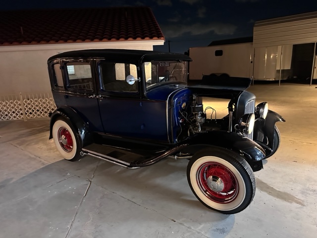

    ALLDONE
    well, I tighten the screws and it runs pretty much spot on.... still have to do the chop off plug reading... but I have a feeling it's real close now...
    it's a built "B" Banger,7.1 head,.. split custom header feeding the 2 live lake pipes 9super7 carb, 39 trans w/od ,centrifugal advance dist..

    It's funny that at first glance it looks like there's no engine:
    Desoto291Hemi and 2FORCEFULL like this.

    it looks a little better with the hood closed, I took the side off to let people see the motor with out me having to open and close it ever where i stopped... IMG_1294 - Copy.jpg
    29A-V8 likes this.
