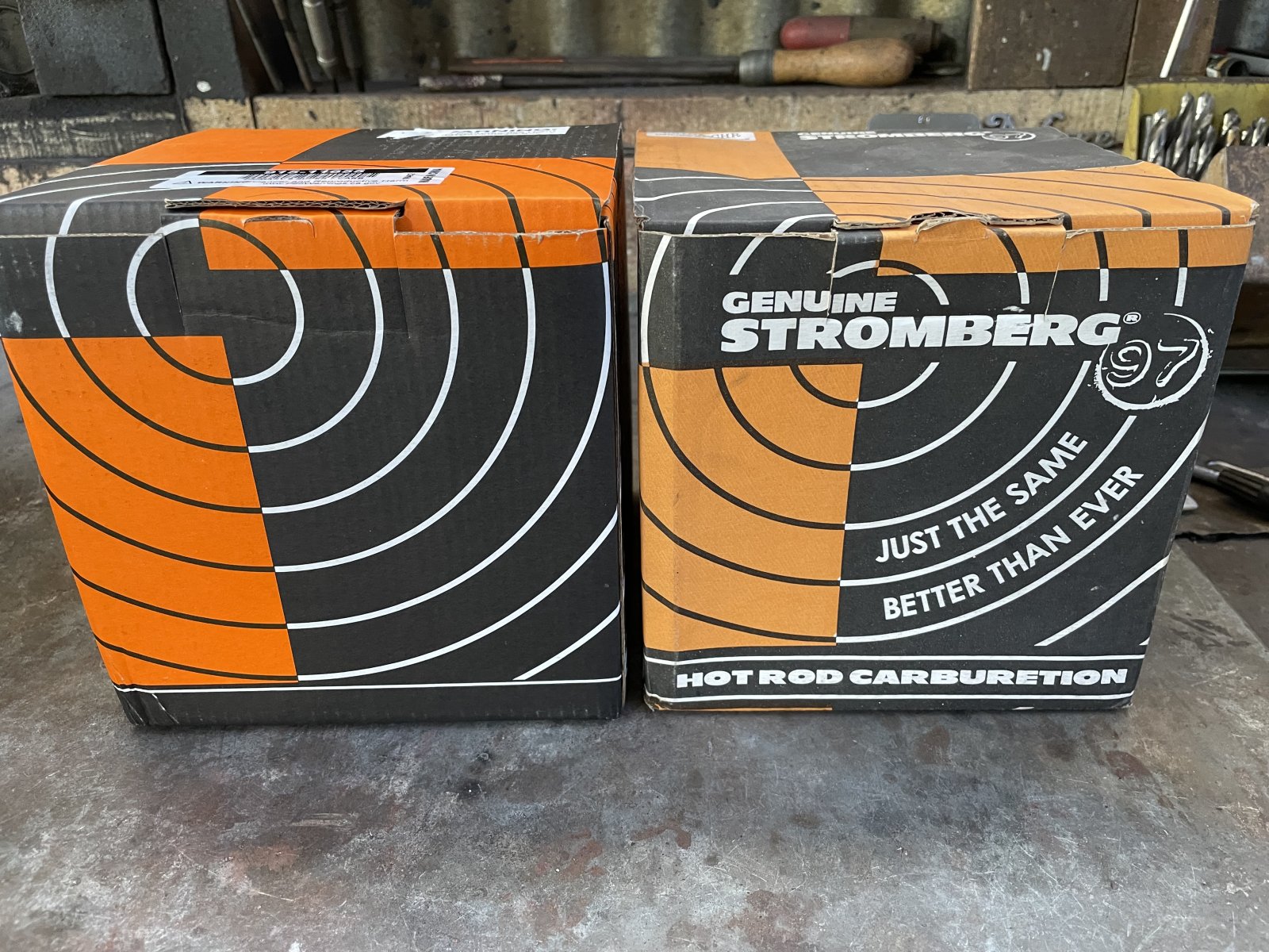

    IMG_3035.jpeg IMG_3034.jpeg Saw this at a swap meet , they can’t even make an effort to create their own packaging .

    actually, even the parts interchange on those two, where as the china ones don't... and it wouldn't surprise me one bit that both those boxes come from china as does the castings for the carbs... but.... gonna guess none are made in the USA
