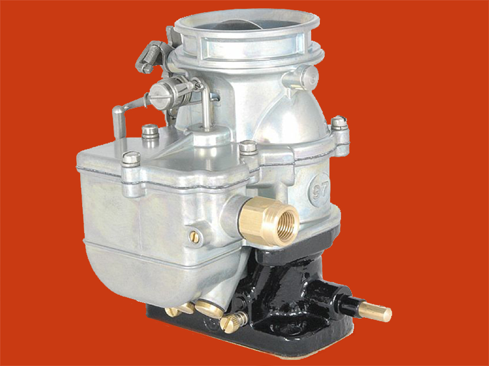

    Photos for reference only....

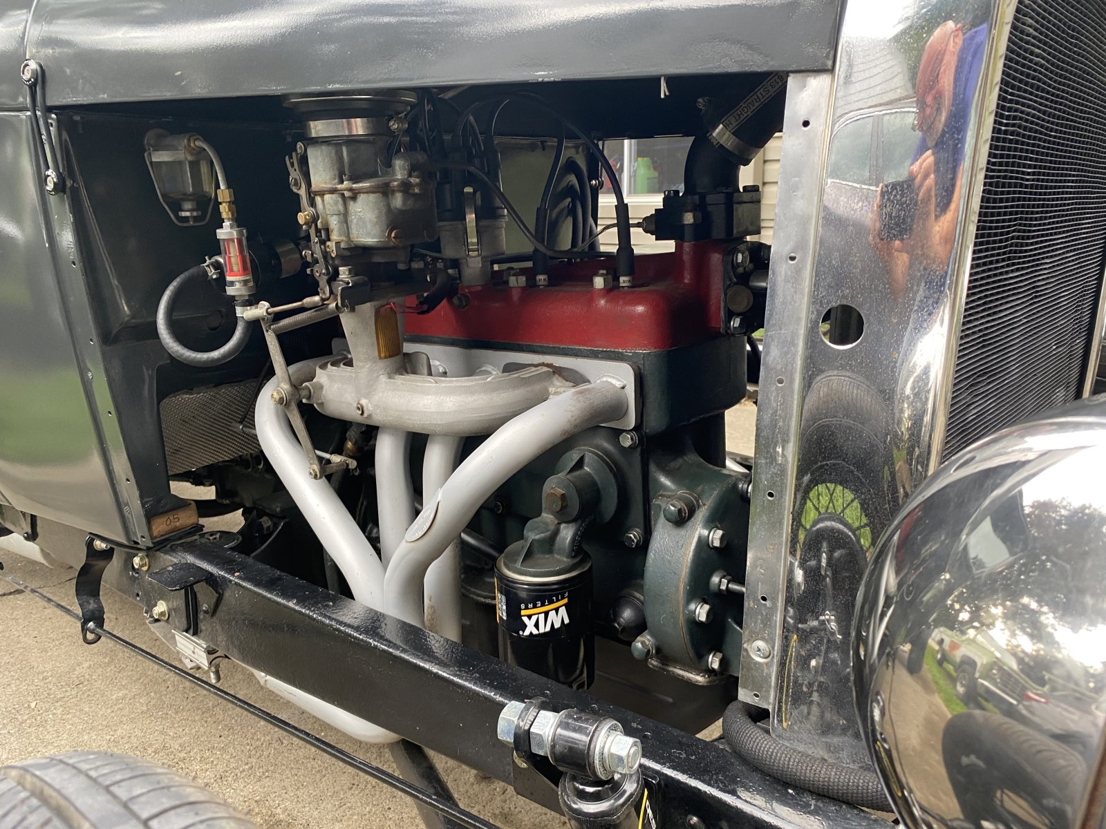

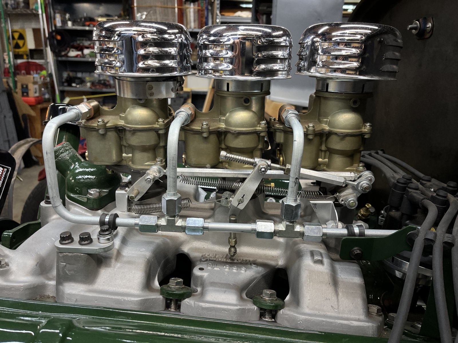

  6. GordonC
    Joined: Mar 6, 2006
    Posts: 3,484
    GordonC

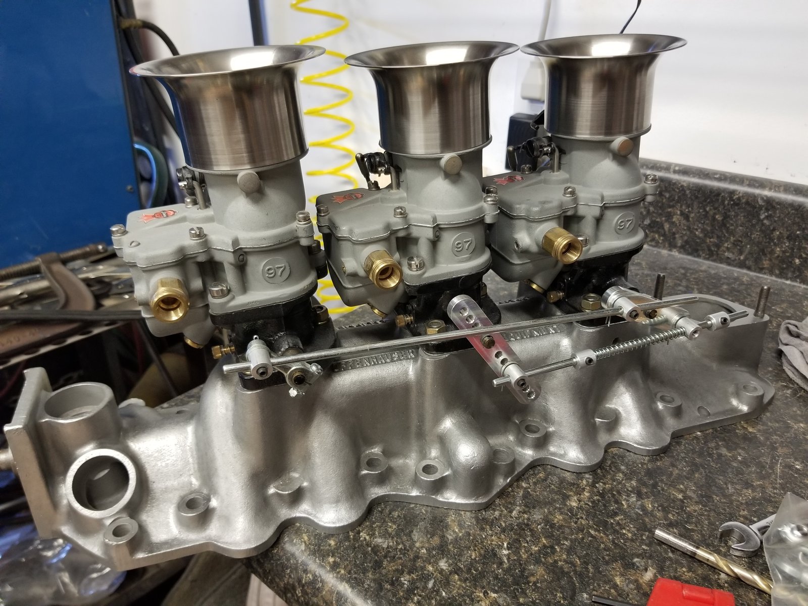

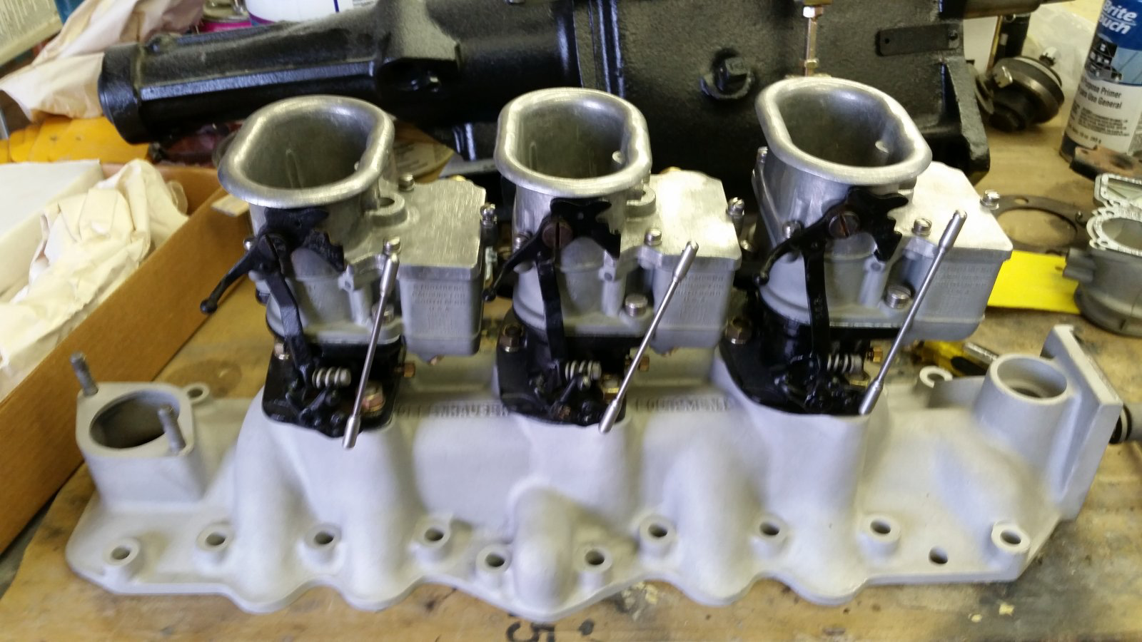

    Growing up in my world you were cool as hell if you ran trip carbs with Stromberg 97s. Here is my set ready to go once my flattys break in miles are done. Which is being done on a single 94 by the way!
    Scott079, clem, dana barlow and 5 others like this.

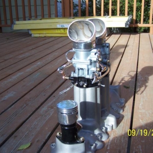

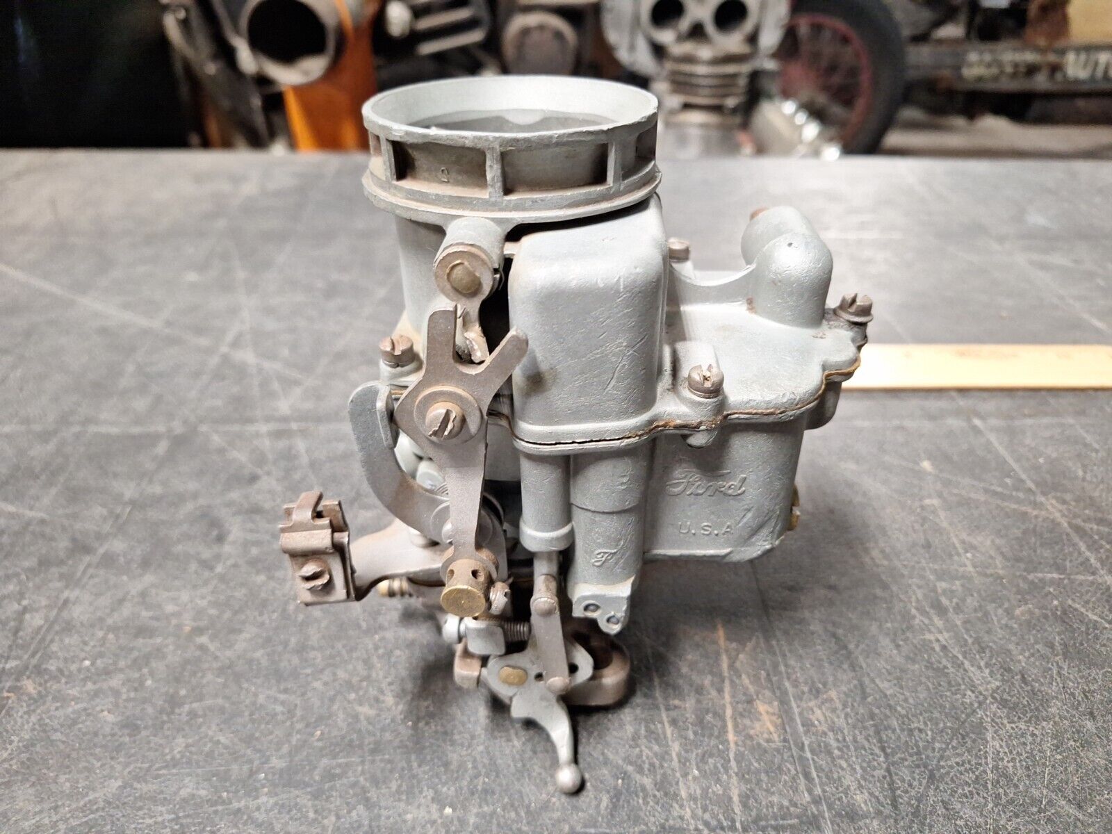

    IMG_4479.jpeg Holley 94 the first ‘smart’ carb, it listens to engine vacuum to provide enrichment through the power valve.
    I found harvesting old power valves to be the answer, modern ones have fit and function issues.I run them as a single on a banger, I have no experience running multiple 94’s, logic says you should plug one if you’re running two to prevent overfuel.

  23. GordonC
    Joined: Mar 6, 2006
    Posts: 3,484
    GordonC
    hrm2K all I have for those is right there in the pictures. I haven't spent a lot of time looking into what all they are going to need if I decide to run those tops. The 97's are all rebuilt and ready to go so my plan was to start there and see how things go.
