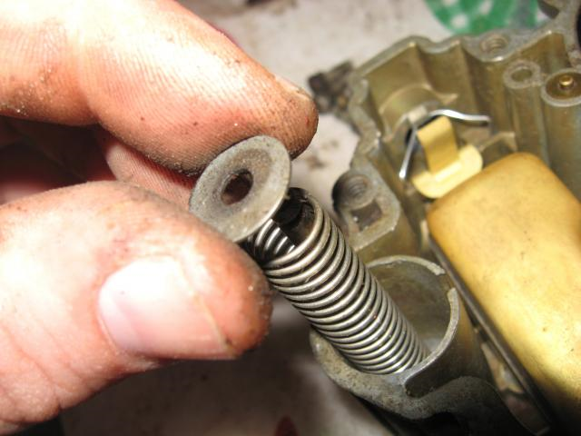

    Hi fellas. I have been having an issue with my stromberg WW carb. Running VERY rich, and in looking through my shop manual, it seems to be missing some springs in the accelerator pump. Carb is a swap meet carb, and wondering if anyone is familiar with this style, and steer me towards a proper replacement. It’s on a 1955 dodge C-1 truck, 241 polysphere engine (v8), marked Stromberg Bendix, it’s a WW, and stamped 3-145 on top. Thanks for the help!!!

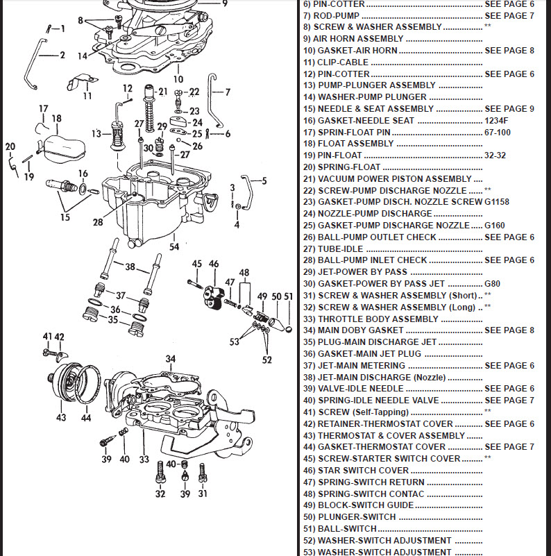

    Hi guys. Thanks for the response. I have s shop manual for the truck, and it seems what may be missing (?) is a small spring above the inlet check ball to hold slight pressure on the ball to prevent too much fuel. Also, the accelerator pump linkage doesn’t seem to do much, aside from allowing it to travel upwards an eighth inch or so. Anyone know where you could by a kit including springs and all that? Thanks again.

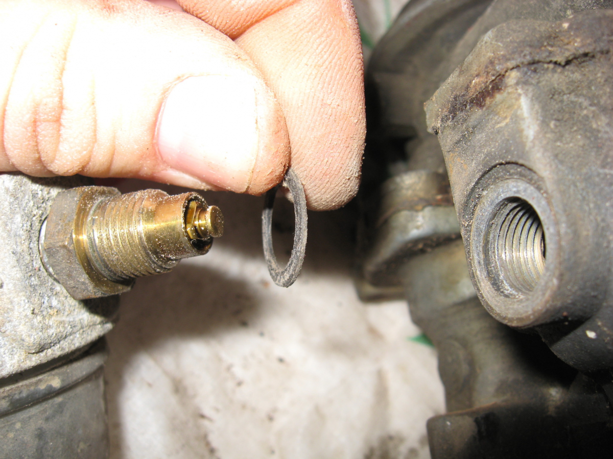

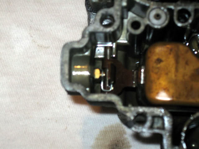

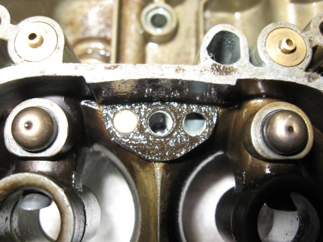

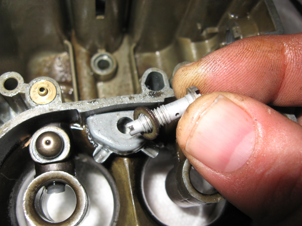

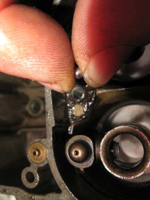

    I bought and tore apart about 30 of those things a couple years ago to ***emble 6 identical ones for my Mysterion clone. I am pretty sure your problem must be mismatch of pump pressure with the carb float setup. Not much else could cause that.. The accelerator pumps are not positive displacement. The lever positively lifts the piston but only the light spring pressure actuates the squirter when the throttle is depressed.

    Chief - there is no spring above the pump inlet check valve on this particular WW. Don't be fooled by generic diagrams. Use the diagram along with the Master Parts Book for the bill-of-material for the specific carb. Once you figure out what you need, we probably have it.
