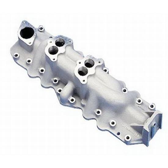

    I noticed you said "primary carb". If you are running a progressive linkage on a dual setup using what I call a "biased manifold" (where the front carb is being run as the primary), I have no doubt that this probably works excellently, as the primary is essentially in the same position as a stock manifold. Biased.jpg
    The jury is still out as to the performance increase gained with something like this compared to more conventional dual setups (especially a "Super").

  19. Model A Gomez
    Joined: Aug 26, 2006
    Posts: 1,856
    Model A Gomez
    Yes as a matter of fact that's the Offenhauser manifold I'm running and the secondary carb opens at about 2/3 throttle. I ran it with solid linkage for a while but was never happy with it and runs better with the progressive linkage.
  20. tubman
    Joined: May 16, 2007
    Posts: 8,307
    tubman
    Just to confirm; you are running the front carb as the primary, aren't you.
    With that type of manifold, I don't see how a straight linkage would work at all well.
