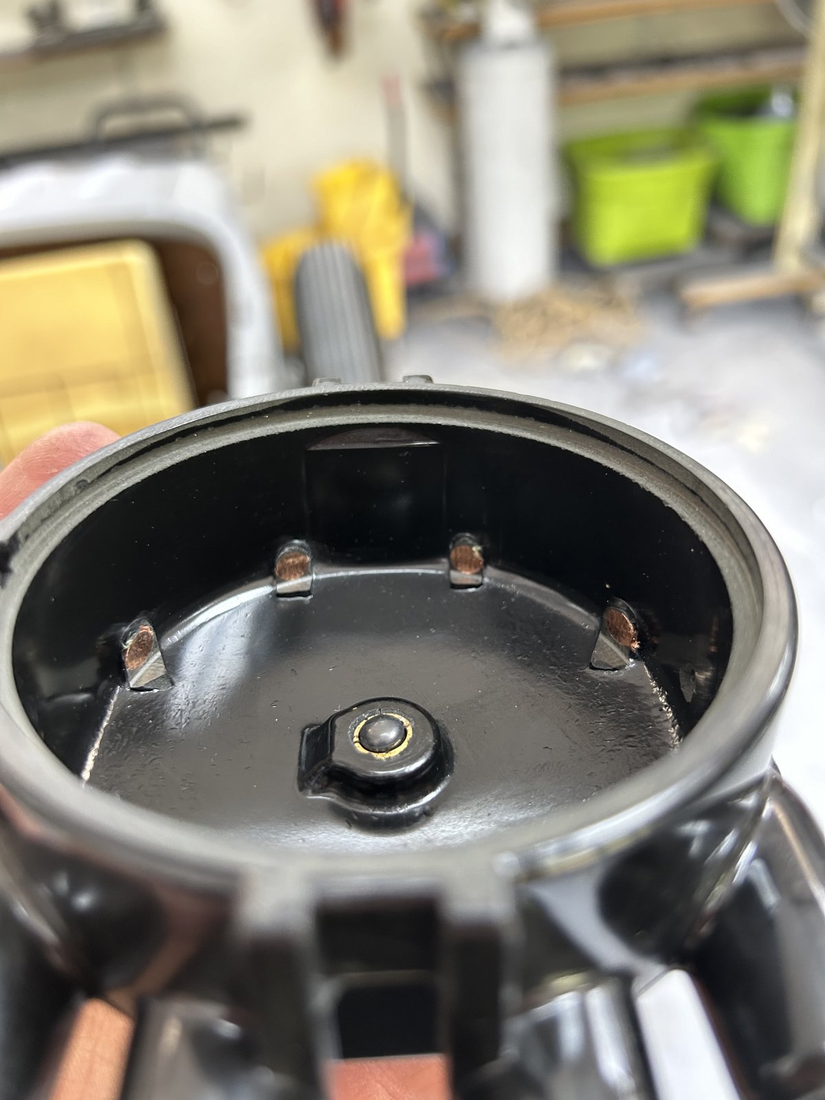

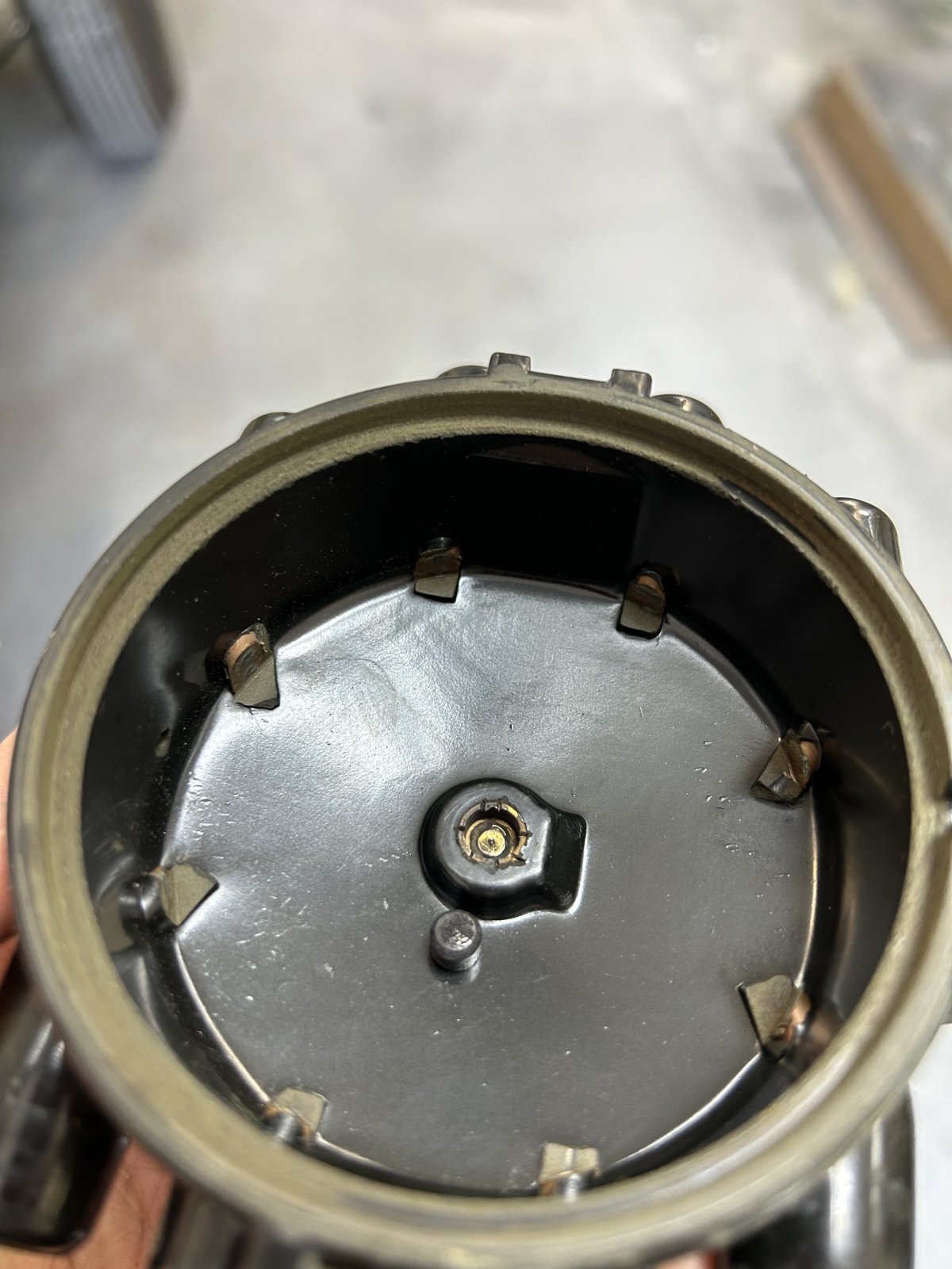

  1. I’ve got 100 miles on a new build and have been chasing an intermittent stall for quite awhile. Pulled the distributor cap off the Stromberg E-fire distributor and noticed the center contact looked pretty bad. It was wiggling around and fell right out when I turned the cap over.

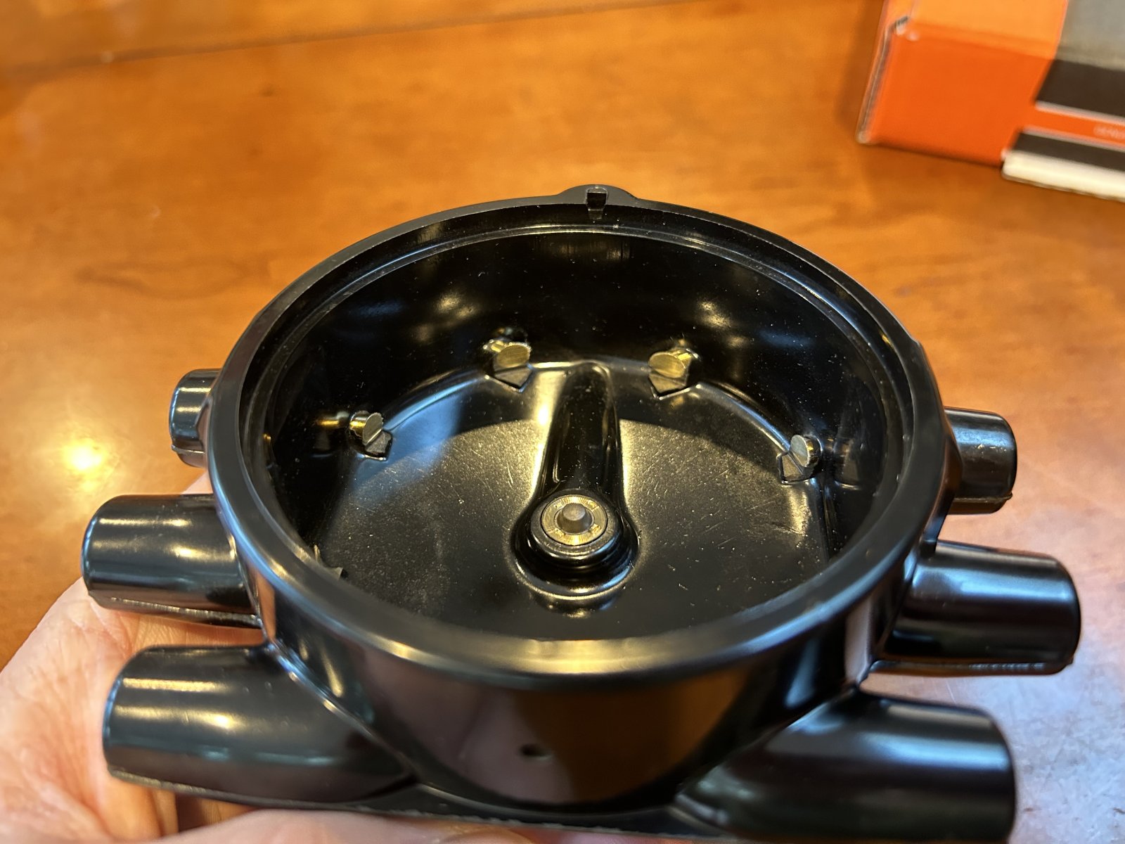

    Ordered a new Stromberg replacement cap from Summit. Center contact button doesn’t look installed squarely, plastic is chipped up around where it’s pressed(?) into place. And it has noticeable movement when poked at.
    I’ve never seen a distributor cap where the button wasn’t firmly clamped in place. Unless it was the type with a spring behind it. And those still seem tight side to side.

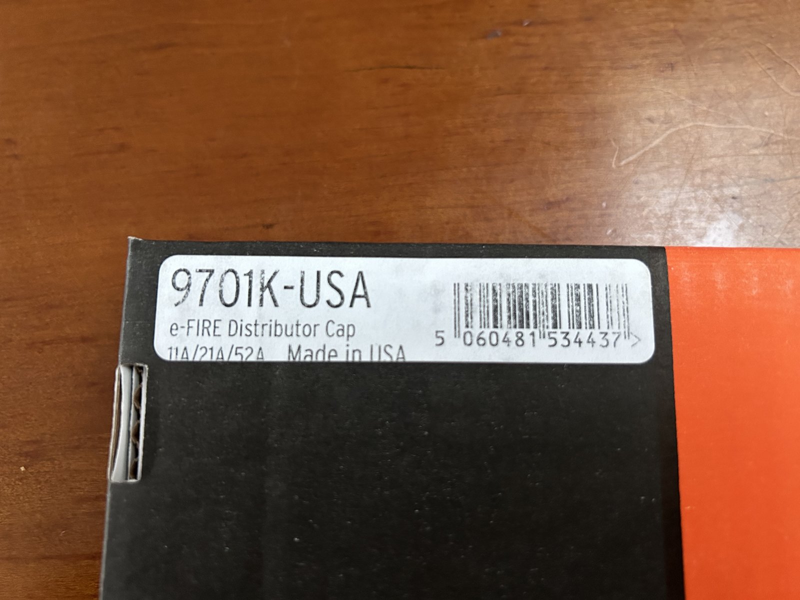

  7. Update on this. I talked to Stromberg and they have changed manufacturers for their distributor caps. They are now made in the USA. They sent me a new USA made cap and the quality is far far better than the previous two caps.
    I’ve got a couple test runs on the new USA made cap and the problem seems to have been resolved.
