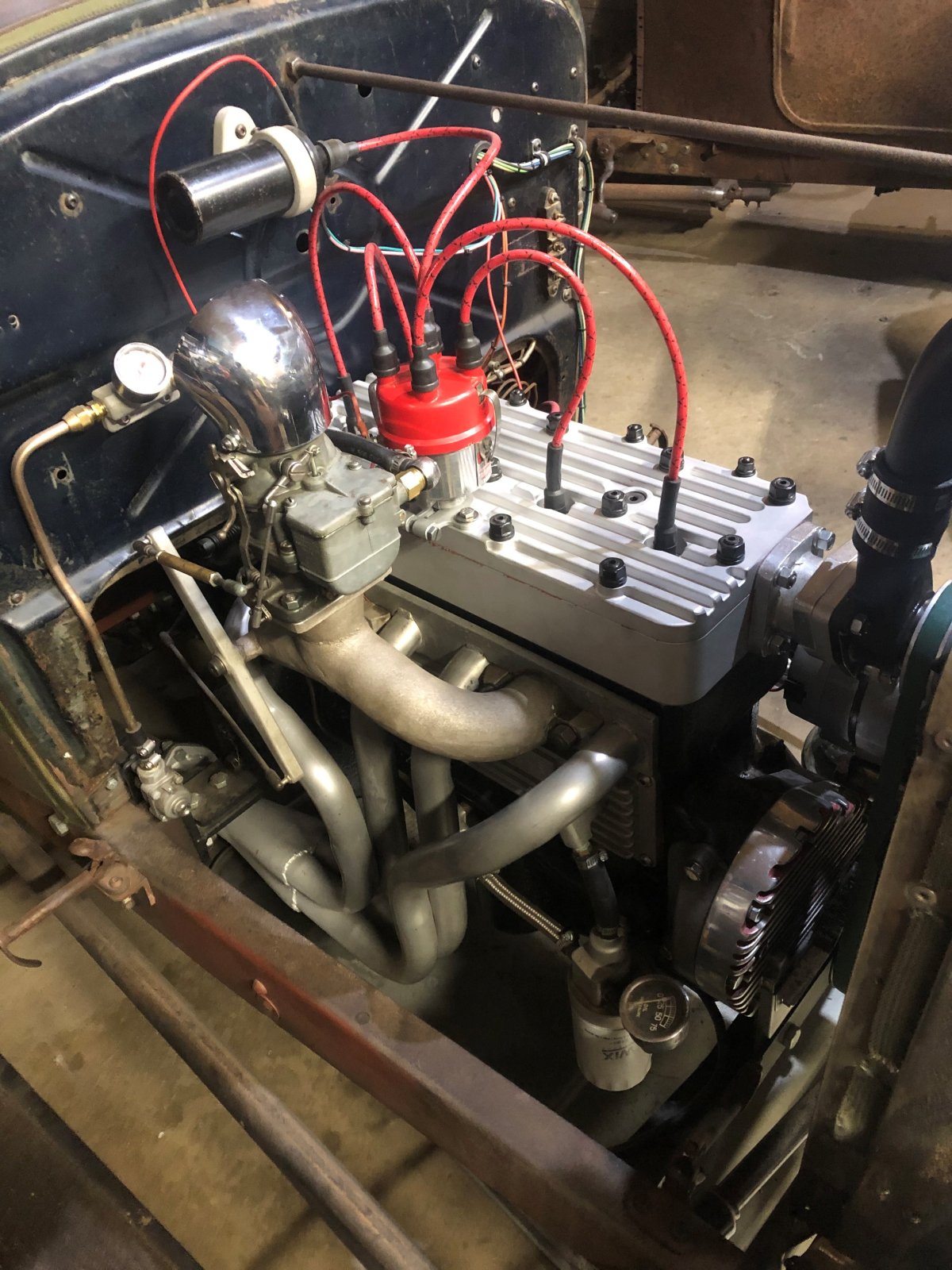

    The motor, B banger , header, 7-1 comp head... what jets would you start with???
    I started with the 45's ran fat... went to 43's, still fat low and mid....
    should I drop to 41's???? anyone run that small??? I'd like to be done here someday...

    I won't run with the little chrome louvered one, so I got a 8''round 4'' tall one,... but it runs the same with or with out....
    also,.. I took the top of the carb off to make sure the float wasn't too high....

    float level was the first thing I checked...I put the 41's in,... she seems real close to where i can tune other things... I need to get a plug reading....and check timing... O ne of the things that happened was when I put the 41's in,... the idle went way up.... I think the other jets were so big that the idle was up enought to get in the mid circuit ... with the new jets I truned down the idle and she runs real smooth now compared to the vibration it had before... run it through the gears, no lean pop...
    my rpu runs way to good to even look at the motor....it has a winfield head... but no idea the comp ratio... IMG_2795[8817].jpg IMG_2796[8816].jpg IMG_2890[8840].jpg IMG_2894[8836].jpg IMG_2898[8832].jpg
