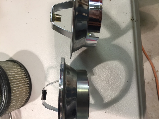

    guy's I've got Scoop's coming for my new Big 97's-I've been looking for these filters (under scoop) for 2 day's and all post's are years old and when I pull up who sell's them can't find them, need 3 black ones (preferable), Thanks for any help...100_0757.JPG

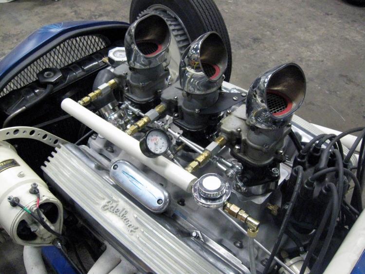

    Real world testing on my roadster, I was surprised how little it takes to choke these carbs. Tried Stellings with old school stainless mess, Edmunds with newer "high flow/modern" filters and Muroc straight stacks. The straight stack flowed the best without any choking throughout the RPM range.

    I ran these for 4 years ,no problem with fuel starvation. Simple open cell foam cut to fit. These carbs are 48’s…Bigger than 97’s but not as big as the Big 97’s

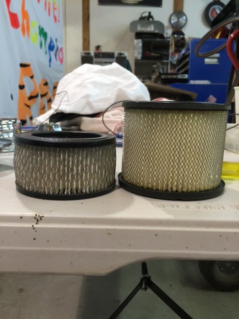

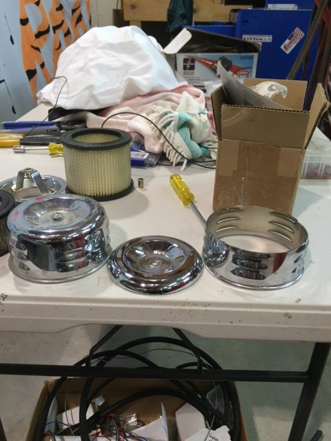

    may not be exactly what your chasing but works for me

    Thank's, I running 3-BIG97's

    Thanks, Anderson sent me 1 to try and they fit great and look good, he's sending 2 more,
