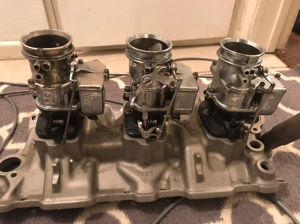

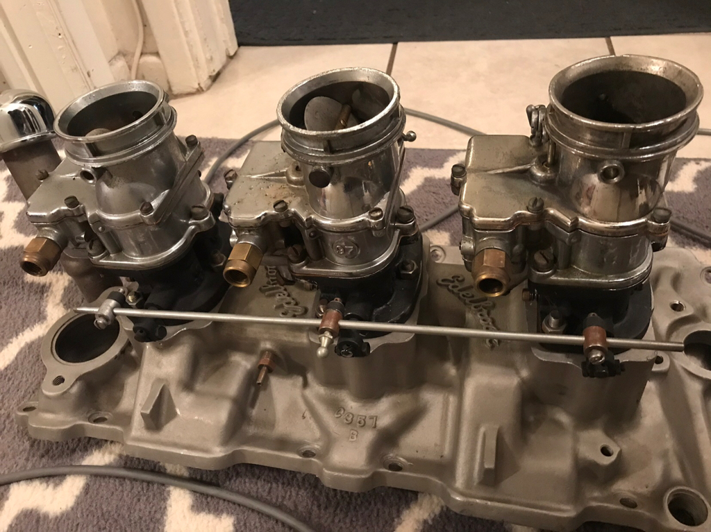

    Hey guys just bought a tripower with Strombergs on a sbc manifold. My question is two of the carbs are missing the throttle plates the one in the middle has it. I’m wondering if I’m going to need the throttle plates ? Thanks

    Pics?? Usually the center carb is the primary carb, and the front and rear are progressively added with correct linkage. The center carb only with have idle adjustments, the front and back do not. Show us a pic of what your calling the throttle plate. Possibly the center carb is the only one which a choke.

    Your running these straight by the photo. From my experience they will need to idle off all three using idle and mixture. If you go progressive the outers can be set closed and meters screws turned in and the center carb will handle most of the driving. Good luck..

    Thanks . Yea I’m going to get the progressive linkage . I was just wondering if I had to replace back those missing plates . Thanks [emoji1360]
  7. No you don't need to replace the plates, They are the choke plates, not throttle plates

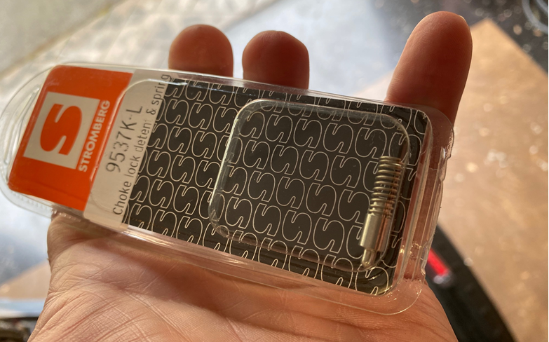

    Found it. This is a neat little trick to fix the choke plates in position and be invisible at the same time so you keep the style of the 97 without a performance issue. So OP, if you replace your choke plates on carbs 1 & 3 you can make them non operable so they don't effect idle speed.
    I ran into a little issue with my trio of 97's on the '34 that I thought might fit well in this thread. With all three carbs open (progressive linkage) the choke plates would **** closed a bit (471 blower) on carbs 1 & 3 and as a result the fast idle cams would create a 1300 PRM idle at the next stop light until I got out and pulled it back manually. I asked Clive @ Stromberg how to remedy and he sent me these
    Simply remove the large fulcrum bolt, pull the detent and spring out of the carb and inset this little piece.
    All you have to do is remove the detent pin and spring pictured here
    and install the new lock out pin $7.50 @ summit Racing
    It engages the holes in the linkage and locks out the choke in minutes. Now only my center carb has a functioning choke on a cable to the dash and I don't have to worry about the outer two hanging up any longer.
    Hope it helps.
