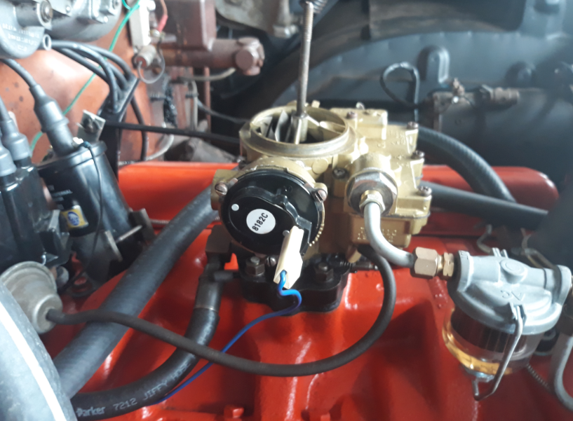

    The large base Rochester 2G used in oval track racing is about 500 cfm on the flow bench.
    The Venturi is bored out and it would lose some responsiveness down low.
    Normally the 2G is rated between 225 cfm [small base] up to 425 cfm depending on OEM application
    Your 283 2G would be a small base and 225 cfm.
    For a Tri-power centre carb you would need a 2G with the side inlet for the fuel line or there is no room for outer carbs.
    I used a side inlet 2G on my 57 [which is incorrect] but I wanted to convert to Tri-power later. I also added electric choke which is more reliable.
    The 2G is very responsive down low on my 283 [it has diesel like manners] but cam and compression choice is important.

    My neighbor had a few of the Rochester 2 bbls and he let me borrow 3 of them. 2 were the bigger base with front inlet. The 3rd was the small base which fit my Buick manifold and it has the side inlet. It looks just like the one you show here except for the choke. Mine actually has a crack in the bowl and it is pretty much junk and good for mock up only. I figured that would have to be my choice to be able to fit 2 more on it. The front inlets just wouldn't leave room. I ordered a new Chevy carb base gasket that I am going to use to compare to my Buick manifold to make sure it will seal up. The Stromberg that is on it now is bulky looking and the Rochesters should be more plentiful and cheaper. Thanks for the tips.
