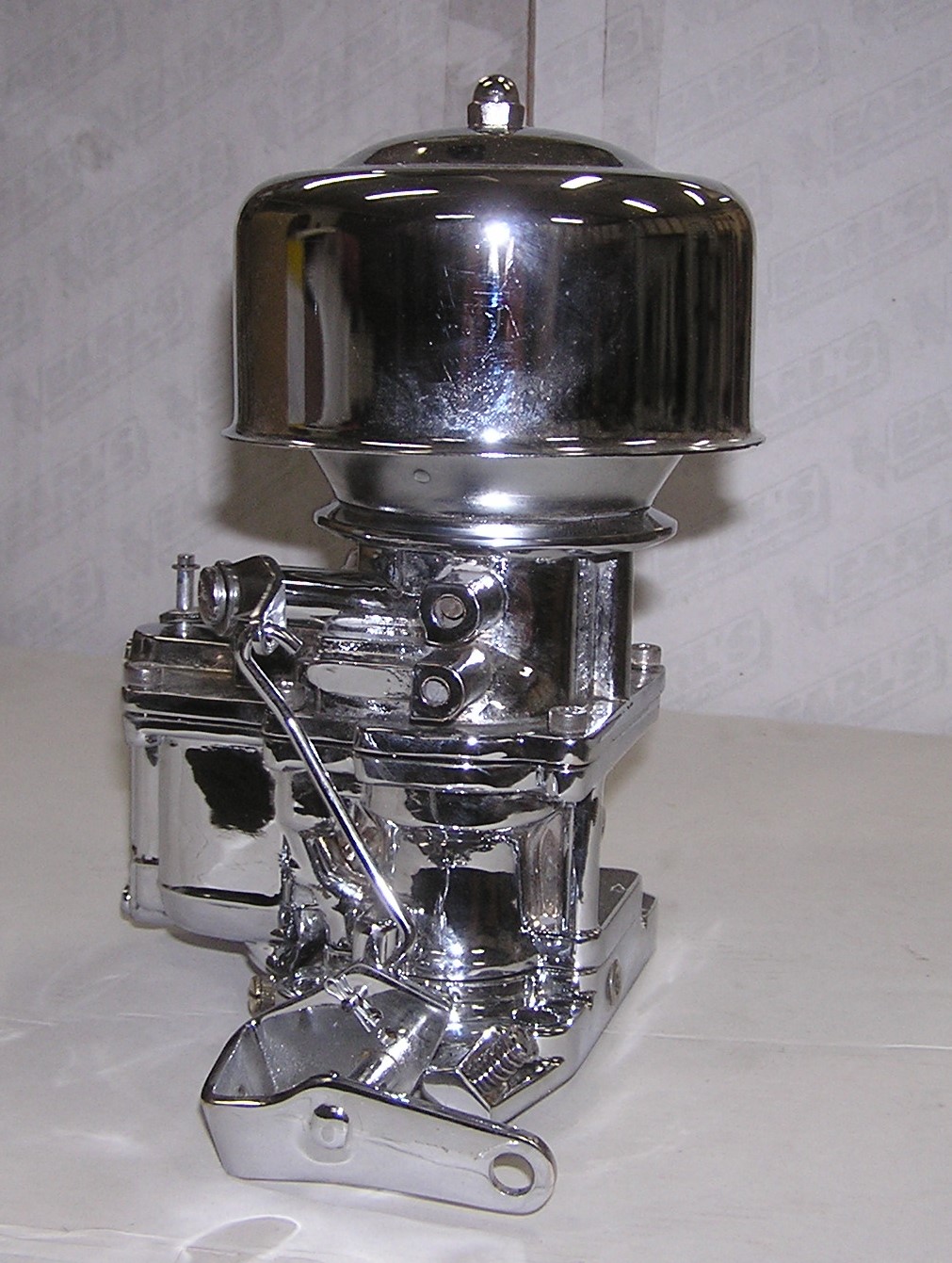

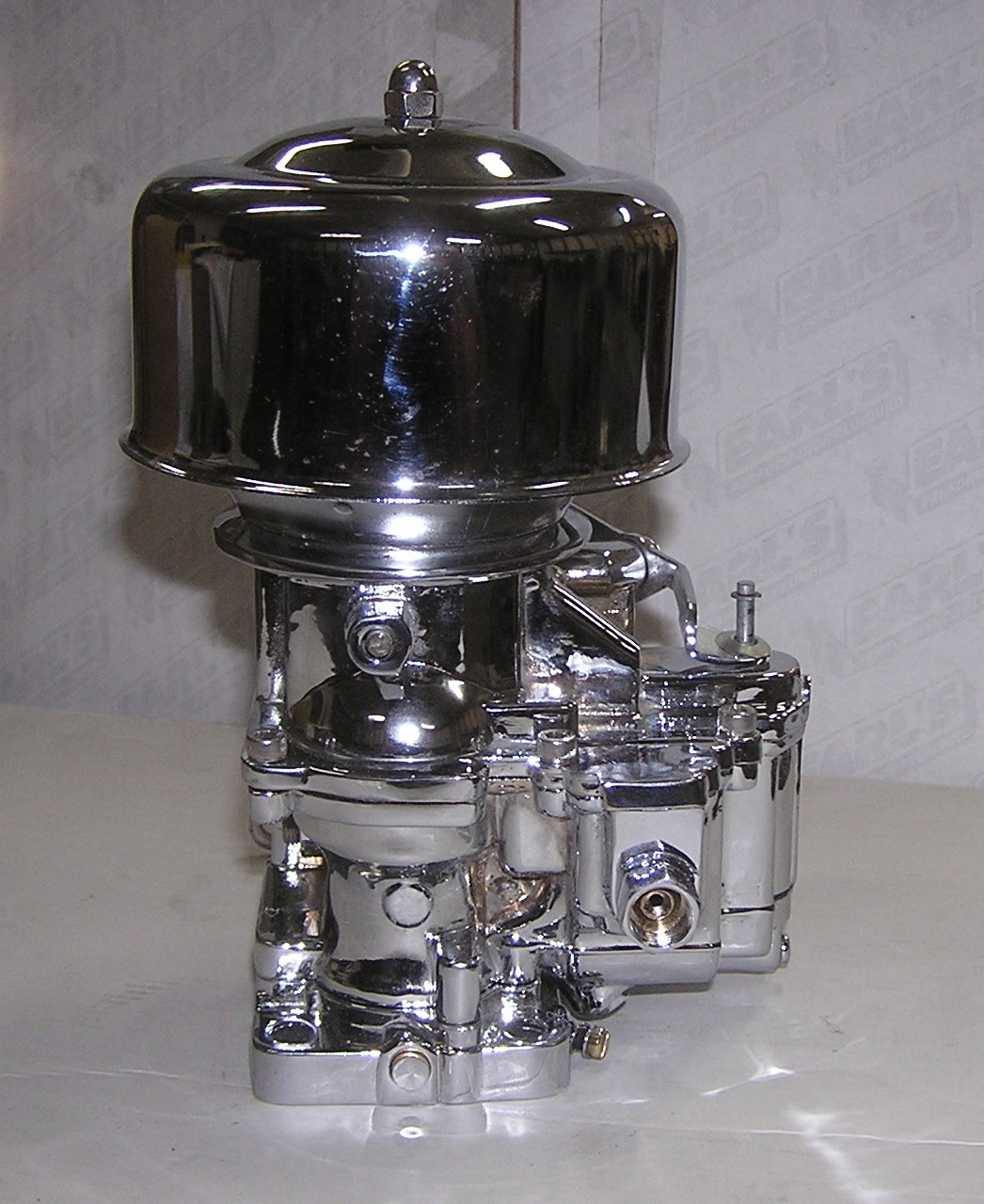

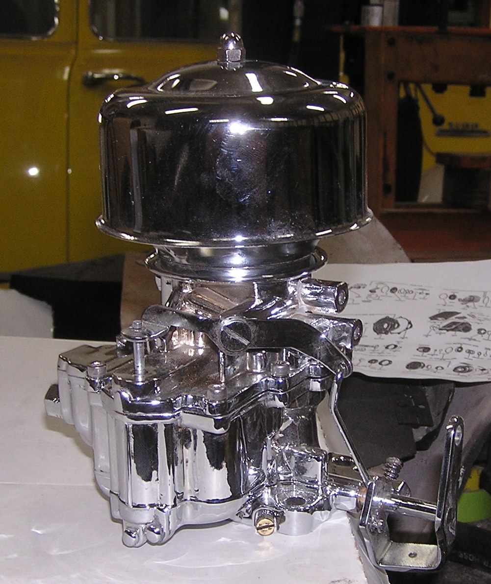

  16. Roth used WWs on the Mysterion. I had mine chrome plated for my Mysterion clone and the plater didn't mask off the inside of the bowls so everything got plated. Surprisingly the carb I run the one running engine still works great.
