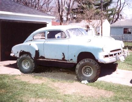

    Nah...IF (and I do say IF) I go the small block Chevy route, it will be the "good" small block (a 400) neatly packaged in a stronger frame with better running gear and 'modern' disc/drum brakes!
    (Of course...as a PLUS, such a contraption would actually be able to HANDLE Michigan roads!)
    Is "my" 56 still fer sale over your way??? [​IMG] [​IMG]
    Here's the ONLY way the Hackmobile will EVER run a small block Chevy....
  10. Still there. Think of ya every time we drive by "it". [​IMG]
