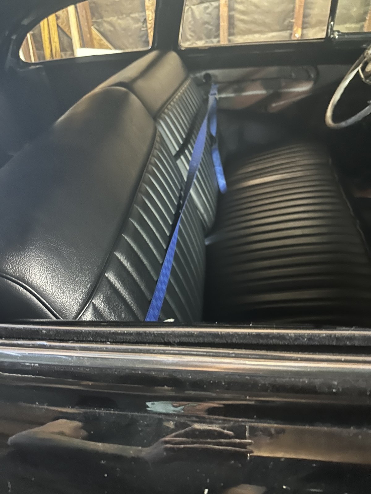

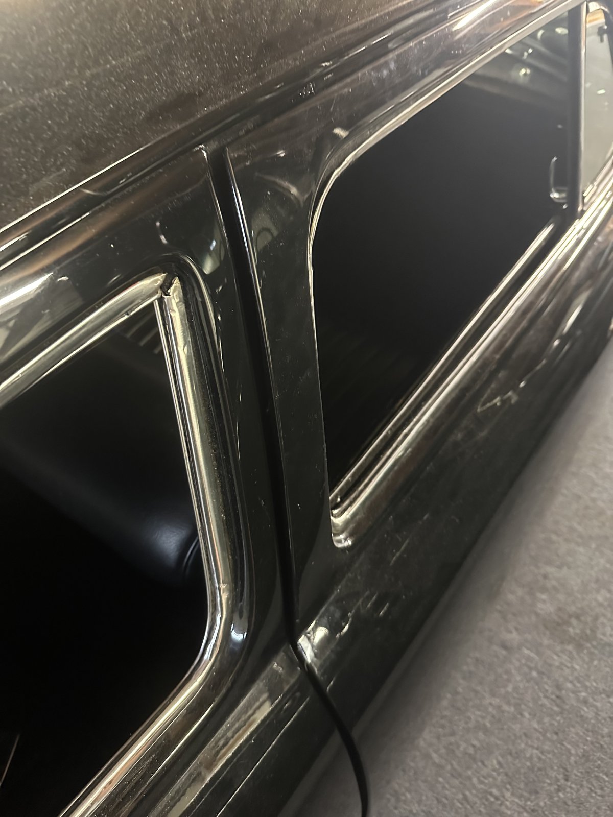

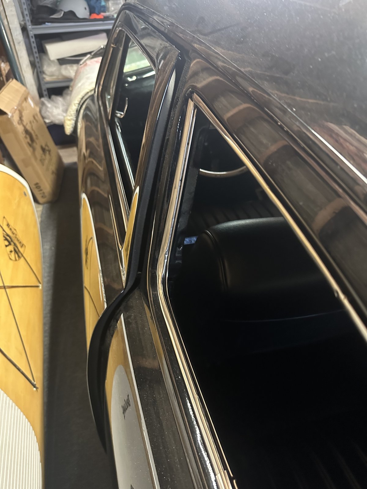

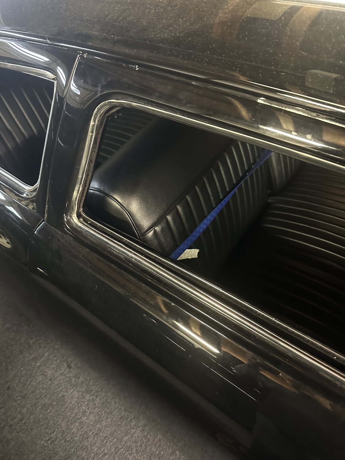

    Hi All,
    My chopped 50 ford shoebox custom didn’t have any weatherstripping on the door, or trunk when I bought it and the doors rattled a lot when driving. I bought new trunk and door seals (upper and lower) from shoebox central and installed them with 3m adhesive.
    The trunk eventually closed and latched though it took a bit of time for that. It took a while to get the passenger side door to latch and even so it takes quite a bit of slamming/pushing hard to get it to do that. I took the side and door glass out for now as a precaution. I can’t get the driver side door to latch at all. There is no adjustment that I know of as it has shaved handles and poppers.
    The photos below show a tie down I used from the passenger door to the driver door. It’s been almost a month and it still hasn't gotten much better. The photos show the driver side door as it sits with tension from the tie down and you can see the big gap still.
    I read about baby powder but they don’t make it with talcum anymore. I thought about using a hair dryer or heat gun but worry about the paint. I already tried opening and closing the door many times (like 100 times!) Does anyone have any other tricks or suggestions? I guess eventually it will get hotter in my garage as the summer comes in but its been pretty cool here since I'm in San Diego.

    Going through the same thing with customers 46 Packard coupe, body shop added weather strip to doors without alignment, go figure, left door won't shut, pass door stuck closed. Pulled off their crap, aligned doors and latches, measure gaps, ordered weather strip from Steele Rubber, used their website catalog for street rod weather strip selections, expensive but perfect fit. They sell all types by the foot. Check their site, very good options and info.

    Sometimes a wipe down with silicone spray, both on the rubber and on the surface it seals agaist will help the seal move a little as the door shuts. This one sounds worse than that,
    If starting over, the best 'tool' for measuring door clearance is play dough, putty, plasticene or modeling clay.
    Take an impression at several places around the door. This will be useful when looking at catalogs like Steeles etc.
    Aim for a seal thar will have only about 1/16" of compression to fit. More only makes the door hard to close
