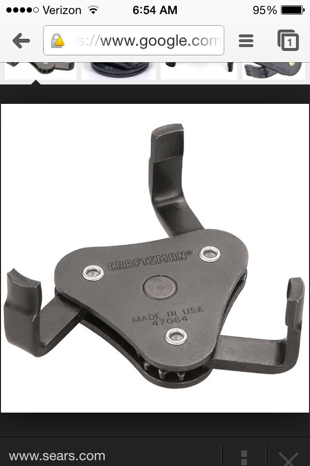

  3. 57countrysedan
    Joined: Oct 28, 2012
    Posts: 370
    57countrysedan
    from NY
    That one i put was a google pic. It said craftsman. Not sure on part numbers but google oil filter claw. Im sure most tool stores would have one or maybe an auto parts store.
