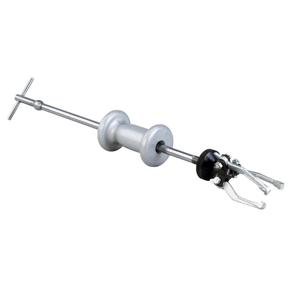

    I would tig weld a couple washers to the outer bearing, and use a slide hammer, to pull the bearing.
    mad mikey, Bandit Billy, Tim and 4 others like this.

    About a million different ways to get that bearing out with a puller or slide hammer.

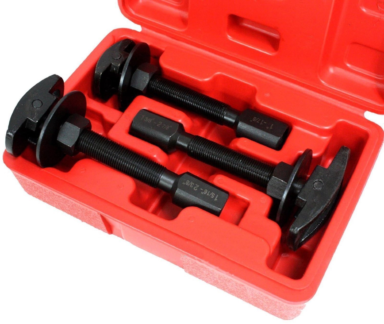

    Is there enough room behind the wheel to slip one of these in and then start cranking the bolts together to force the wheel outward?
    gimpyshotrods likes this.

    Yep, thinking I'd be building a puller/pusher at this point. Should be fairly easy to make something that won't damage anything. Good luck!

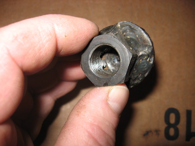

    Here’s what I’d do, and it was kinda mentioned before…but the Old dodges, etc that had tapered axles came with a “removal” tool. Basically a hex head like a bolt head, but about a inch of threads maybe less I’d have to look for mine.
    So you’d remove the nut holding the wheel on. Screw this in its place. The “tool” would tighten up against the axle (spindle in your case) and be about an 1/8th inch from tightening anything. Follow me?
    Okay, the wheel you want to remove stays on the ground. Jack the opposite side up into the air. Take careful aim with a 5lb sledge and smack the end of the “tool”. It would shock the axle and with the tire still on the ground, act as a press. Similar when you use a puller on a tapered piece get it tight and wrap it once with a big ball peen and “pop” it comes loose.
    I made one for a friend with a nut and weld a rod in it.
    Edit: I welded a bolt into a nut, not a rod. I recall screwing it in some then welding it

    Budget36 I take it this tool is something like this. Made from a stub axle nut and a bit of plate.
    Budget36 likes this.
