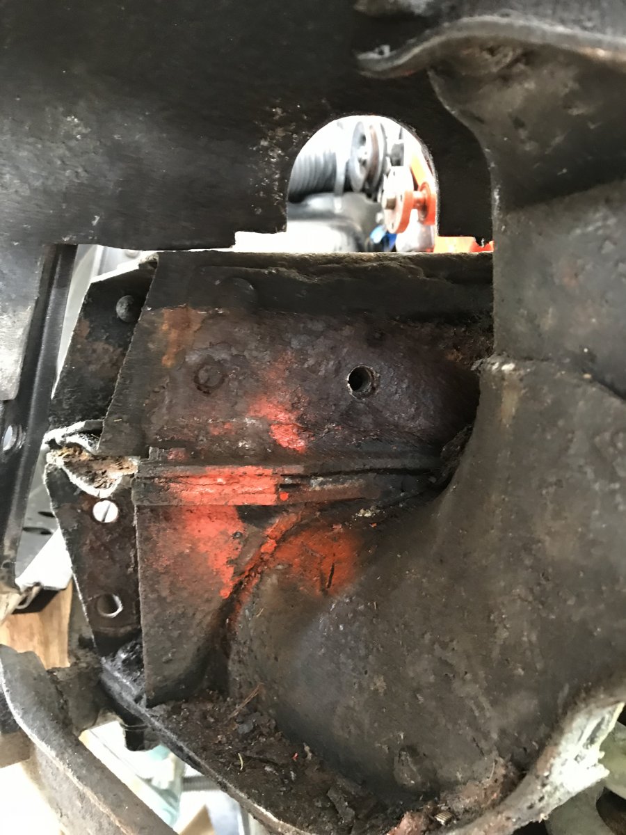

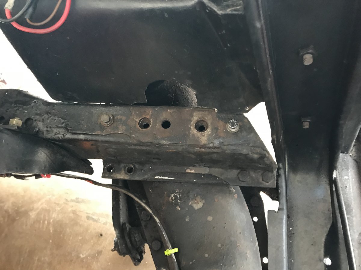

    You guys do a lot of posting, hoping I can get expert experience help in removing front crossmember from frame for 58 Corvette. There are 16 bolts, nuts on bottom. All nuts either removed or broke off. Using punch and 4-pound hammer, 5-inch swing, did not move the bolt. From the top there is frame, aluminum shim, and front crossmember, all together about 1/3 inch thick with bolts stuck inside. 1/4 drive 9/16 socket or line wrench does not fit, bolt too close to frame rails. From bottom some bolts close to crossmember so not a good angle for using punch for straight up shot, and from top some bolts very tight, only room for angle drill, not big 3/8 drill.
    How would you get these bolts out to drop front suspension?

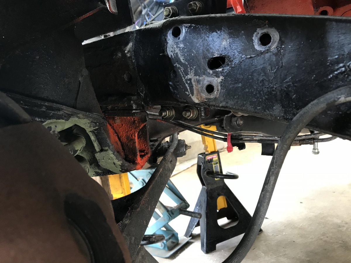

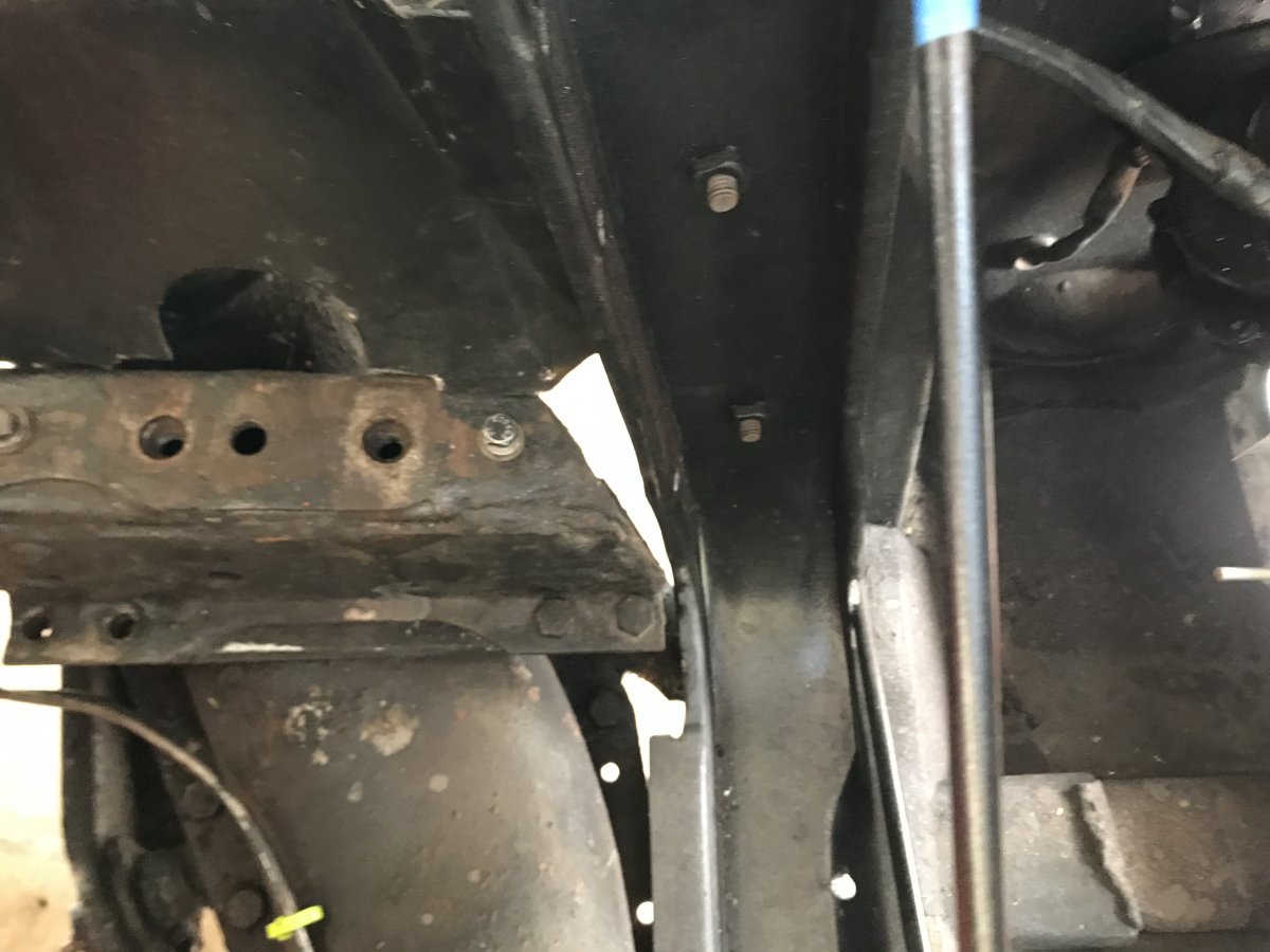

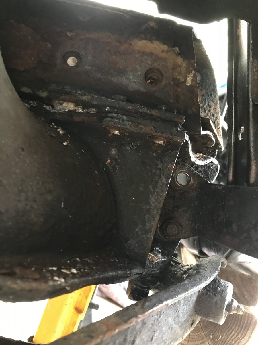

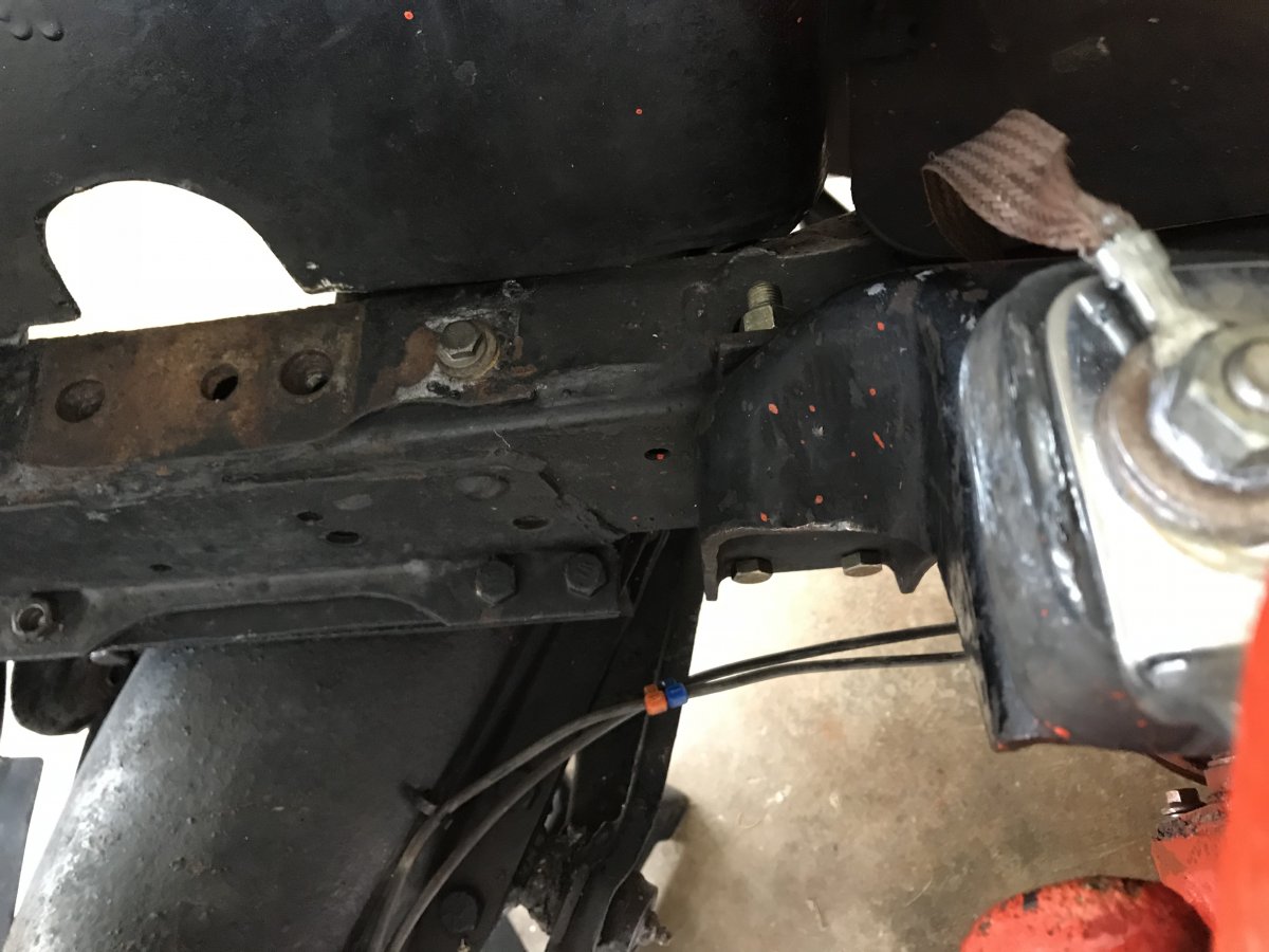

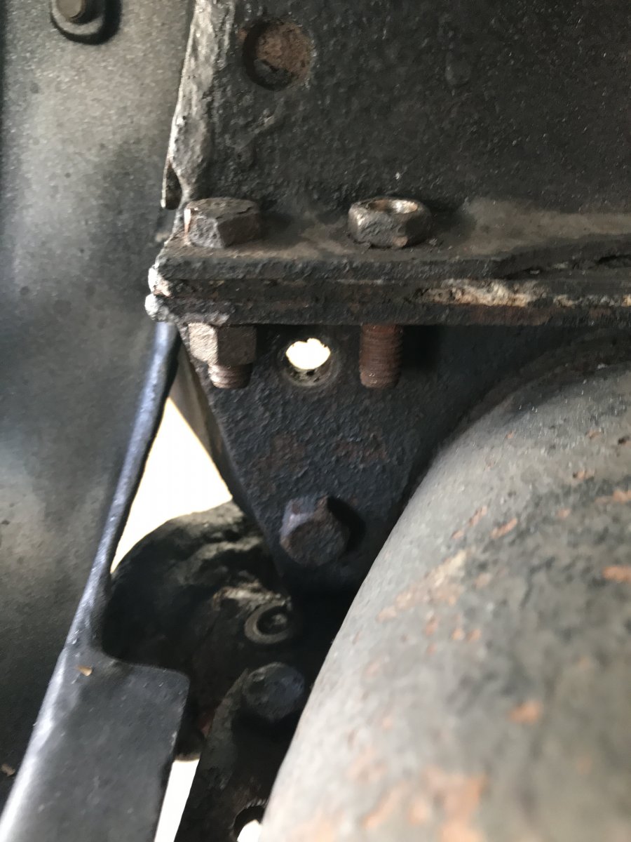

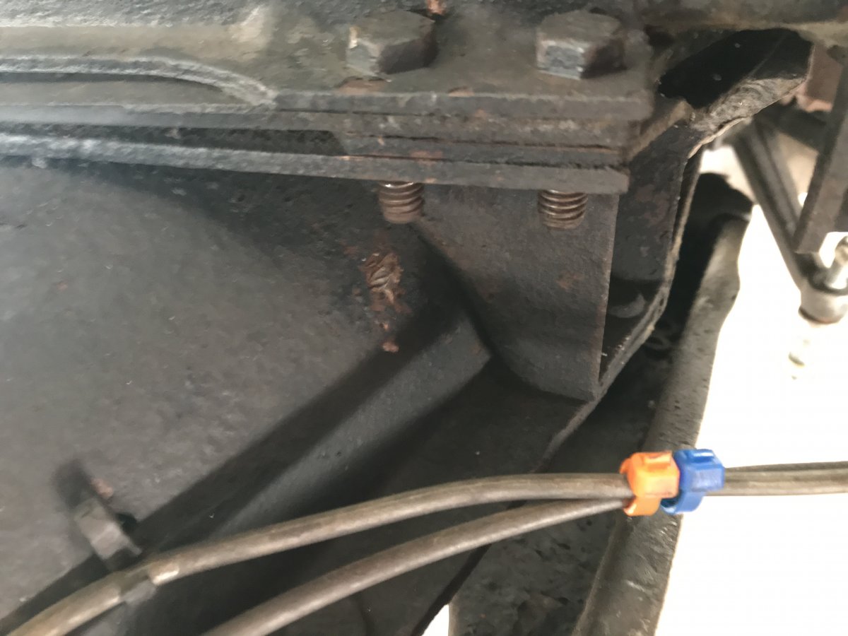

    A60718A4-42EC-465B-A463-4F1679071EBB.jpeg 00F330FA-AE5C-40F0-B416-39749C5E74A3.jpeg E8A6887D-D4FF-4892-B66E-CF87697ACC47.jpeg 3C0E006C-D039-401F-B3DD-A6FD53DBBF38.jpeg 78738038-25D7-4260-9E08-80EF26469D64.jpeg 5A80245A-E6CE-4CAF-986A-9EBEABAF446A.jpeg FBA0306D-1EC1-468F-AFA7-5FC3E0DDE926.jpeg D738C614-5F62-4A8F-B9EC-4413A6B76712.jpeg Lots of reply’s/help.
    Pictures added.

    Seems to me, those bolts have a serrated shank on them, just under the head, that helps hold/lock them in place; like I said, I can't find the bolts that came out of the 51 Bus Coupe (same basic front end and 16 bolts). On p***enger cars, there are't nuts per say, but a small plate with two threaded holes the bolts go through. Once all the nuts/plates are off, the entire cross-member should just drop out without a lot of effort; maybe use a wooded battering ram, rather than mess up the frame or cross-member, as in for sure the sixth photo. You don't want to mess up anything about a C-1 Corvette. Was't hard at all with the 51 Bus Coupe, but there's probably more room to work around. In fact, it looks like a C-1 Corvette has the sway bar mounted above the cross-member, while p***enger cars, it's below. Did you check in with Chevy Talk? I am Butch/56sedandelivery.
