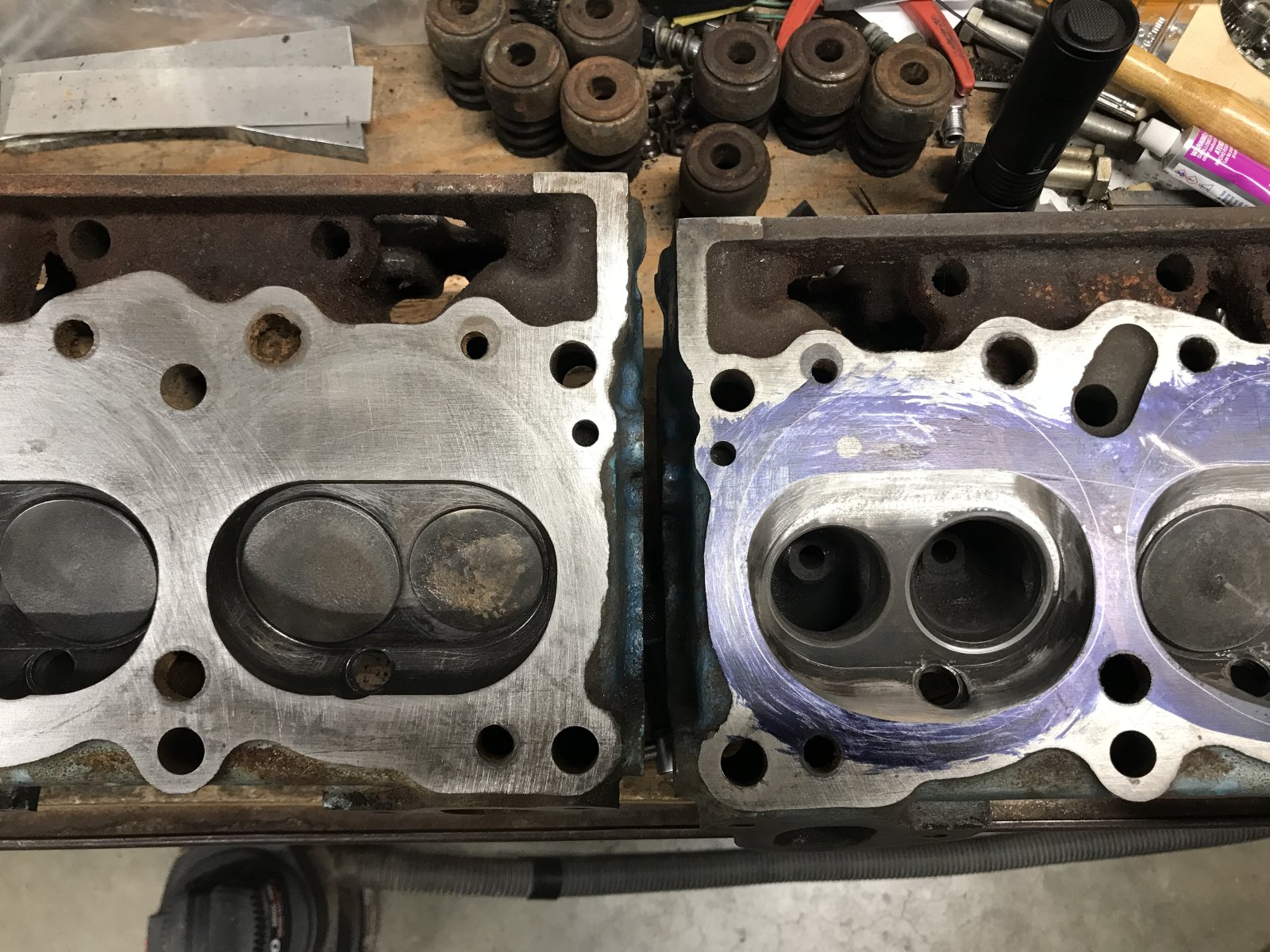

    Well, the '62 heads are ready to go to the machine shop for a valve job. I buckled down and finished up the chamber mods today. I chased all of the threads and s****ed out as much rusty crust from the water p***ages as I could.
    Here's an A-B comparison photo. They went from 73 CCs to 81 CCs. That should help the static CR and the valves got unshrouded some in the process.

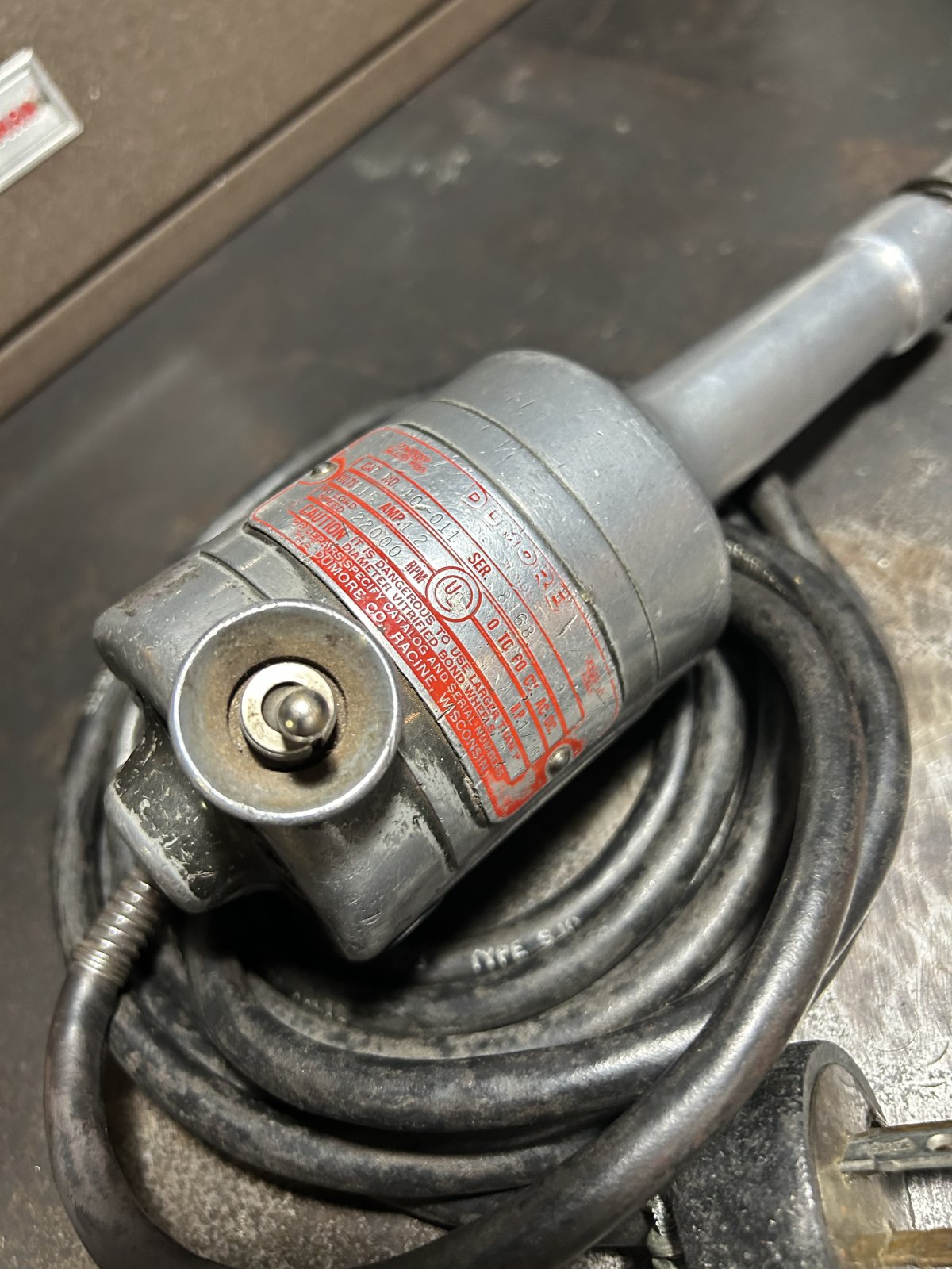

    You will note that I only use the latest, up to date equipment....
    Hey, at least one of them has an on-off switch. Good old Craftsman stuff. I paid $5 for the gold one at the Turlock swap meet a few weeks ago. Great timing.
    It did take a while for my hands to stop buzzing enough that I could type this post though.

    Ya know Bob, On/Off toggle switches are still being produced these days;)

  7. bchctybob
    Joined: Sep 18, 2011
    Posts: 6,086
    bchctybob
    I started out to replace it once and honestly, I didn’t think I would be able to get it back together. It’s got ten pounds of wire and stuff crammed into the tail end. I wasn’t sure if I could get it all back in there.
    I’ve got a place in LA that fixes stuff like that for way cheaper than I would charge to do it but I keep forgetting to take it with me and drop it off.

    IMG_9511.jpeg Other than the short spindles those look just like my 50+ year old grinder. Obviously Sears sourced them from Dumore.

    If they did, they picked a good source. I’ve had mine as long as I can remember and it still works fine.
