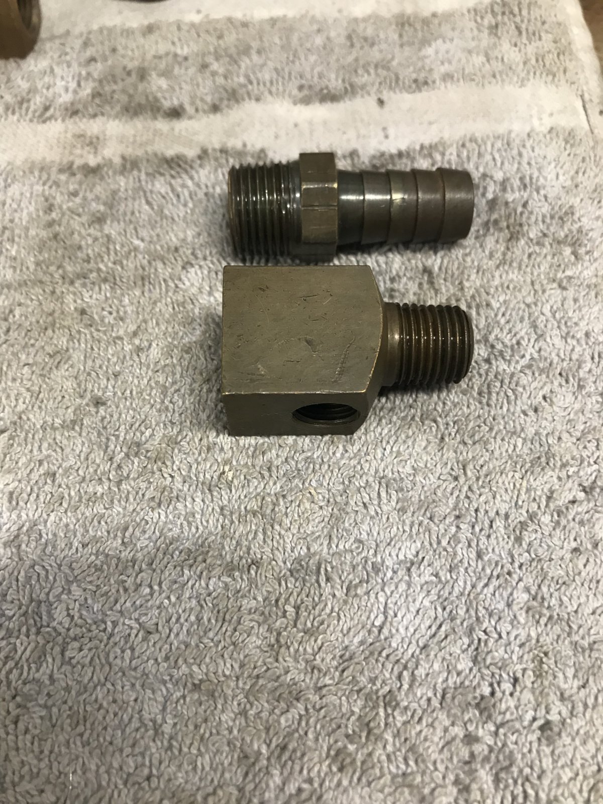

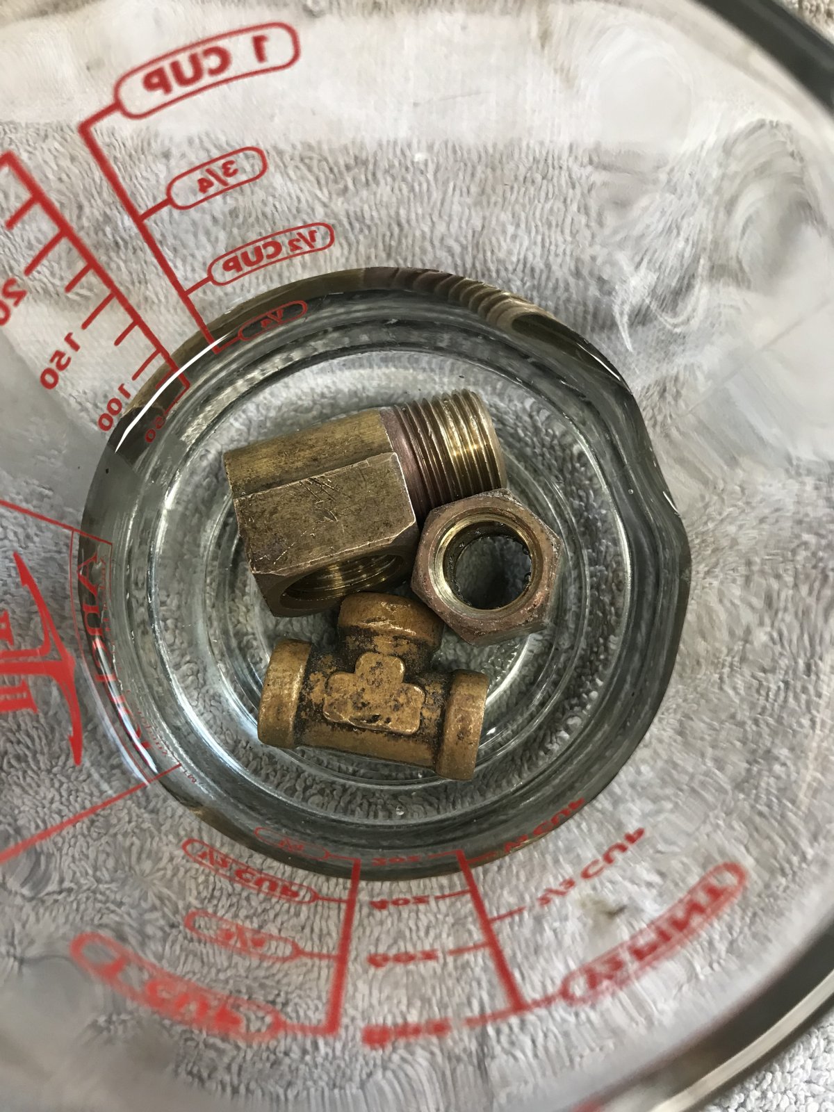

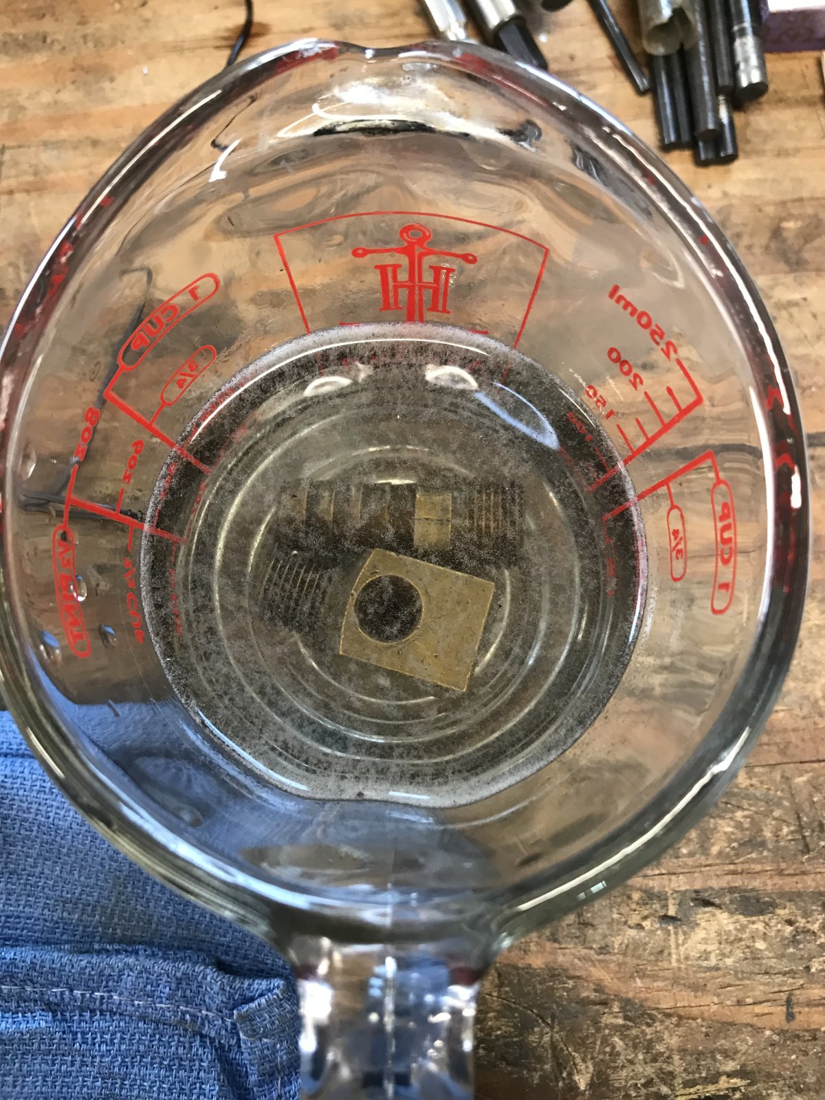

    The results are in.

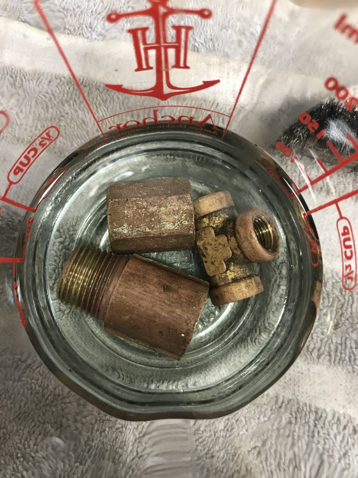

    I picked three br*** fittings from my stash, one dark with oxidation, one a little lighter oxidation and one very light. I washed them with carb cleaner to make sure that there was no oil or grease keeping the vinegar from the surface. Washed and dried.
    I put them in the measuring cup and covered them with white vinegar. 5:24 pm
    I agitated it several times. Three hours later, little progress. 8:16 pm
    And finally, 24 hours later.
    Once again, vinegar is a disappointment. The fittings turned a coppery color but they don’t look like bare br***. I didn’t scrub anything because I won’t be able to scrub the inside of my radiator.
    I’ll try citric acid and maybe some Drano.

    Sure. I thought it was worth giving it a try. After the 24 hours I rinsed the parts thoroughly with water and rubbed them with a shop rag to dry them thinking that maybe they would be bare yellow br*** but they weren’t. The parts are clean but the oxides were still present.
    If I get into town today I’ll pick up some oxalic to try.

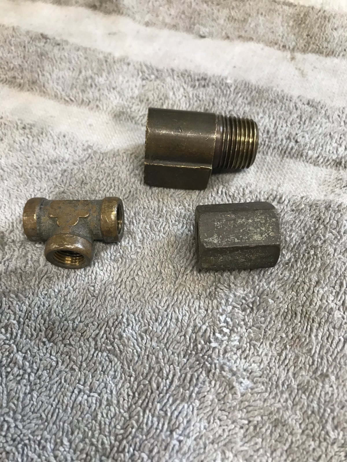

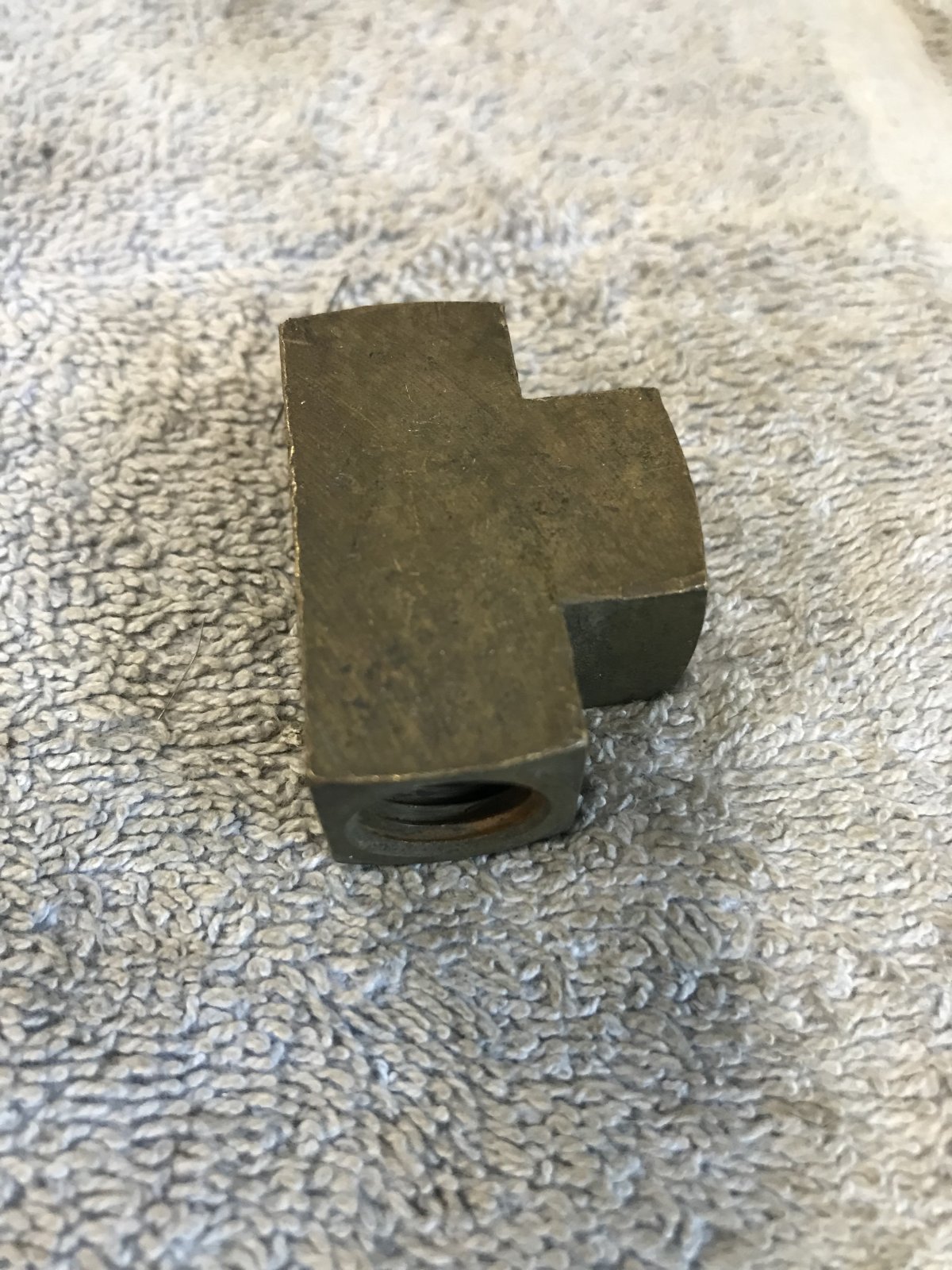

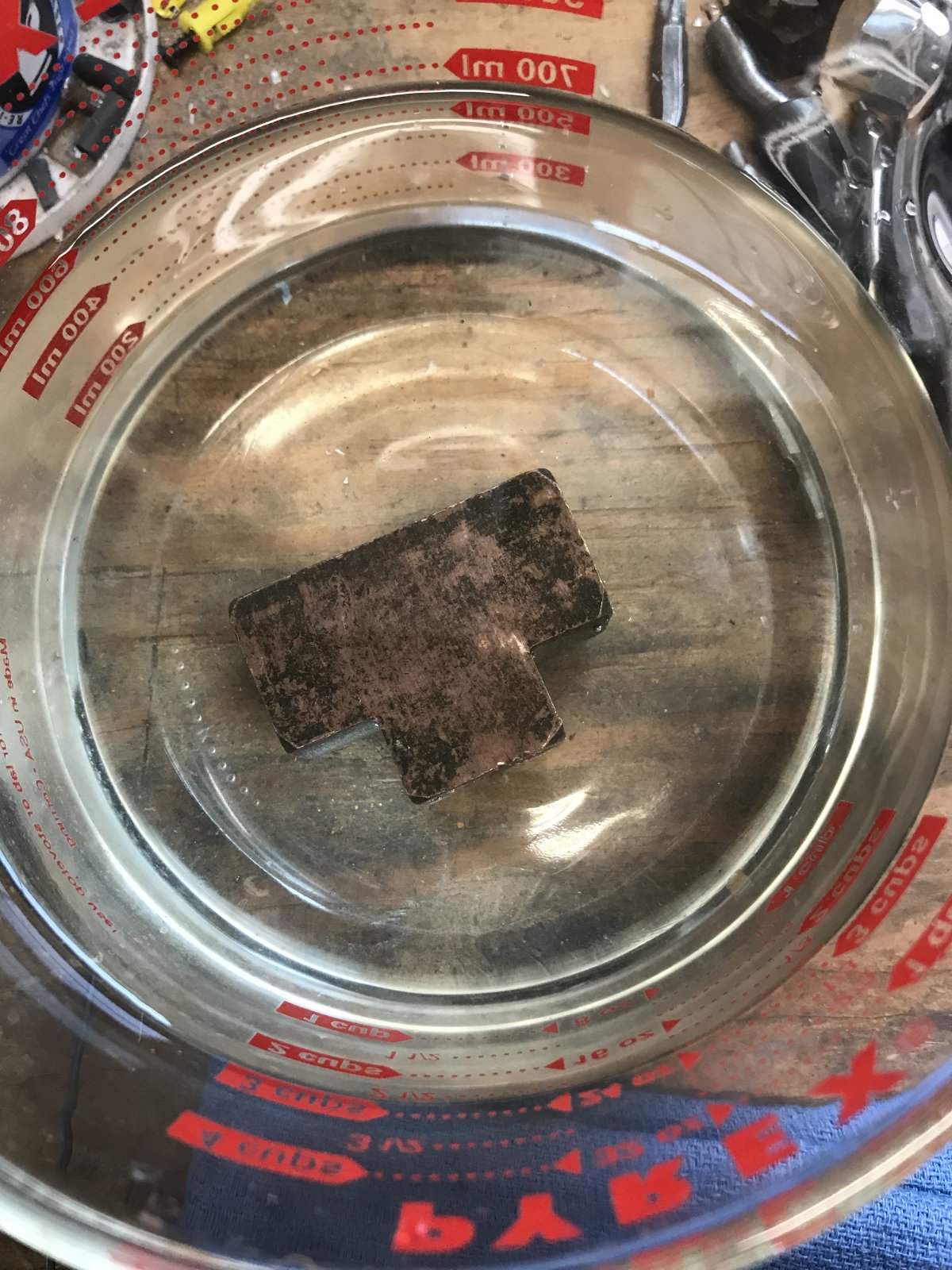

    I gathered up a couple more br*** fittings, pipe Tees from the bilge of an old boat. I wiped them with carb cleaner and stuck them in two different solutions. One in Zep acidic toilet bowl cleaner (hydrocloric acid) mixed 50/50 with water. One in citric acid, mixed 2oz to 24 oz with water.
    The victim….2 each
    Into the Zep bath at 1:51 pm
    And into the citric acid bath at 2:31 pm.
    Let the games begin.

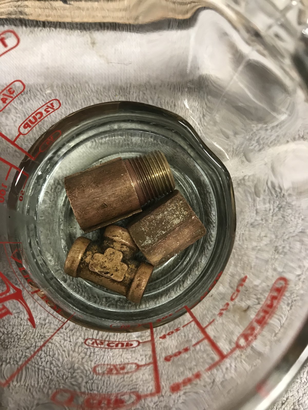

    Agitate, agitate, agitate….
    A little while later, there’s noticeable color change in both solutions. But the citric acid is in the lead. The Zep has darkened and clouded a little, the Citric is obviously yellow.

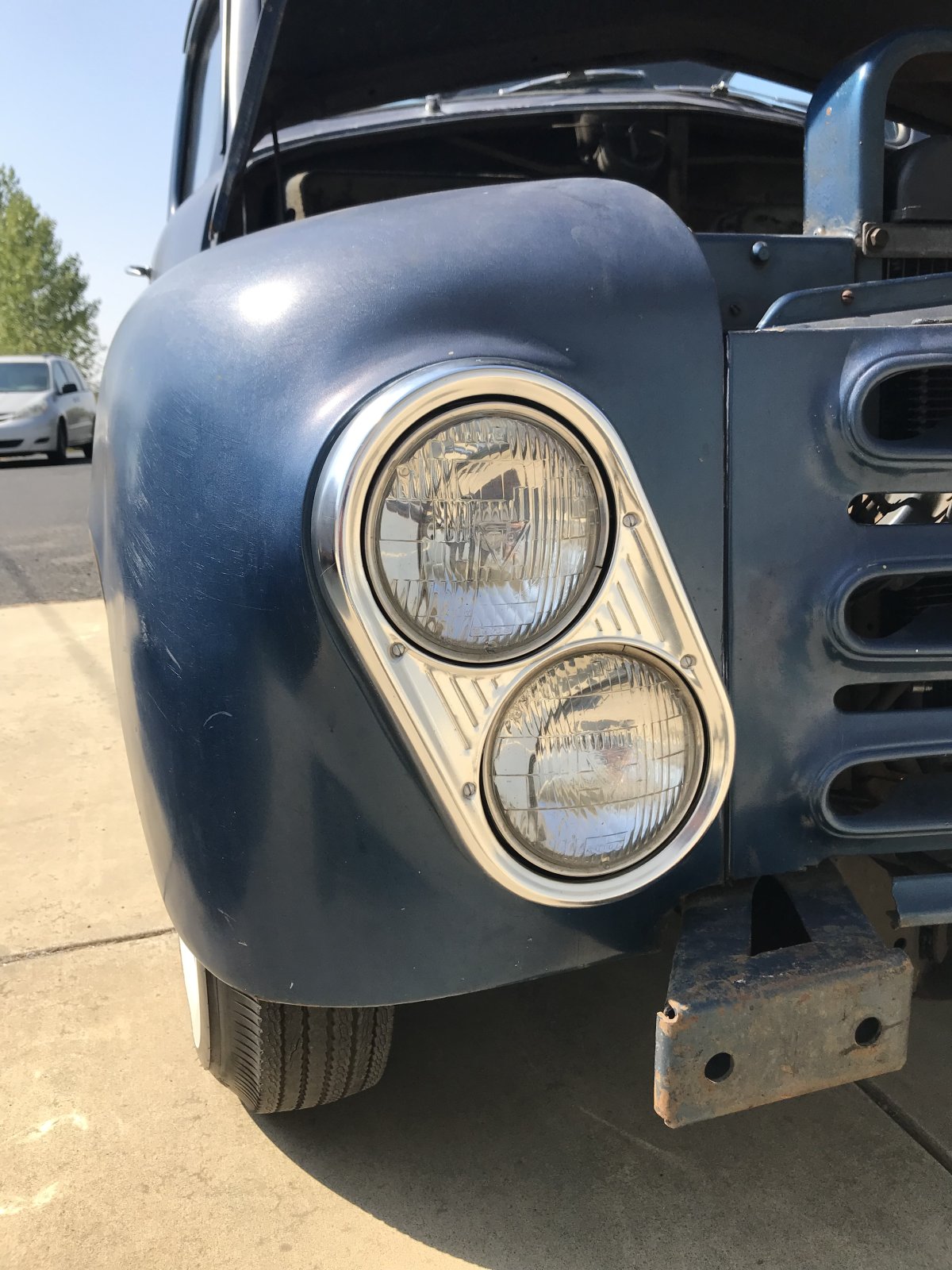

    While conducting the acid test I decided to attack the useless headlights on the Stude.
    I took it to the store the other day and returned home after dark. The headlight did a piss-poor job of lighting the way home. They seemed to be pointing 3 feet ahead of the missing front bumper.
    The outer rings came off with no drama. One bucket had a shock absorber bushing as a tensioner, it fell apart. I had a fresh shock bushing. It turned out that both bulbs on the p***enger side were bad. I had replacement T3s that I had salvaged from the ‘65 Corvair that I got my wife’s Corvair engine from. I couldn’t resist cleaning the rings and painting the rusty screws that hold them on.
    All back together and all working with a little better alignment. I’ll know more tonight after dark. The perfect little task to do while testing cleaners. Turn signals are next.

    I decided on 50/50 with water for economic reasons as well as concern for a very old radiator not knowing anything about hydrochloride acid.
    At 3:40 there was a noticeable change in the color of the solutions.
    As of 7:15 tonight, the Zep is doing what I hoped. The fitting has the nice yellow br*** look with just a little of the copper. I expect it will be perfect when I check it tomorrow morning.
    The citric acid is now lagging way behind. In spite of the color of the solution, the fitting is still showing lots of oxidation.

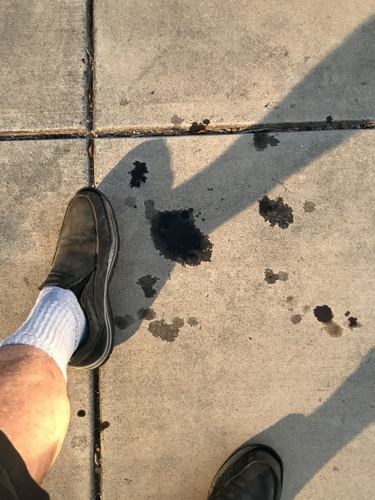

    Back to the rear main seal leak for a minute.
    This is what it leaked in a little over 24 hours with a few spots from the steering box and the transmission dipstick tube. Waay better than the wet 8”+ puddles it was leaving in a matter of minutes before I added the sealer. It may still improve, if not, I can live with that.
    (worn out size 11 shoe shown for scale)

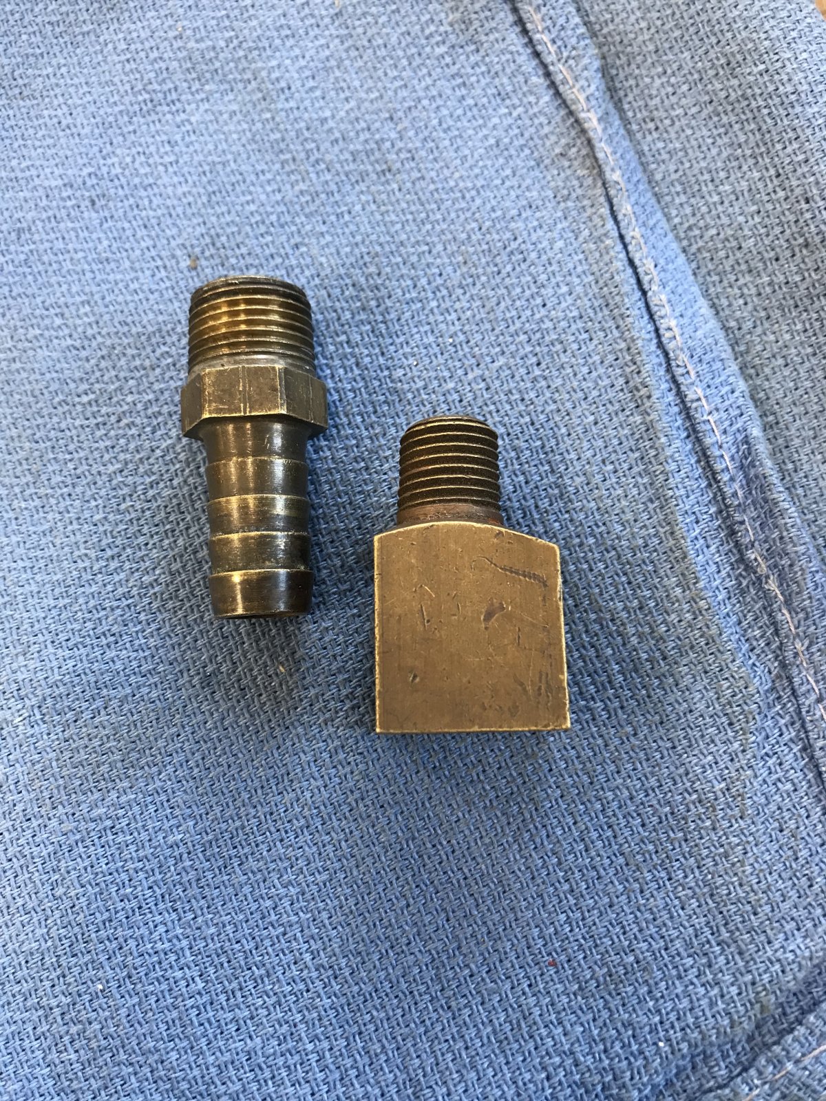

    Back to the acid test. I bought some crystal drain cleaner, it wasn’t Drano but rather a commercial brand of crystal lye. I made up a solution 1 tsp to 6 oz of water and soaked a couple fittings, agitating whenever I thought of it. It was pretty disappointing. I guess lye does better eating organic matter, it barely changed the surface of the br***.
    A miserable failure, and they even had an extra day in the bath because I forgot to rinse them before going to the drags yesterday. Hmmm.

    So there you have it, “believe the science” (LOL)
    Four different common solutions and the results of a 24 hour or longer soak with occasional agitation but no scrubbing. Obviously I don’t know the exact metallurgical makeup but they are common br*** automotive fittings.
    Upper left - white vinegar
    Upper right - citric acid (powder)
    Lower left - Zep acidic toilet bowl cleaner (hydrochloric acid)
    Lower right - Instant Power crystal drain opener - 100% lye.
    Looks to me like the Zep gave me the surface I was looking for with white vinegar 2nd and citric acid 3rd.
    As NRGwizard said, I probably could have used a stronger solution, maybe 70/30 Zep to water for faster results. And maybe more time would produce the desired results with the vinegar. So I’ll have to choose between those two when I pull out the radiator.
    I didn’t neutralize any of the test victims so we’ll see next time I go into the fitting drawer if any have disappeared or turned to dust.
