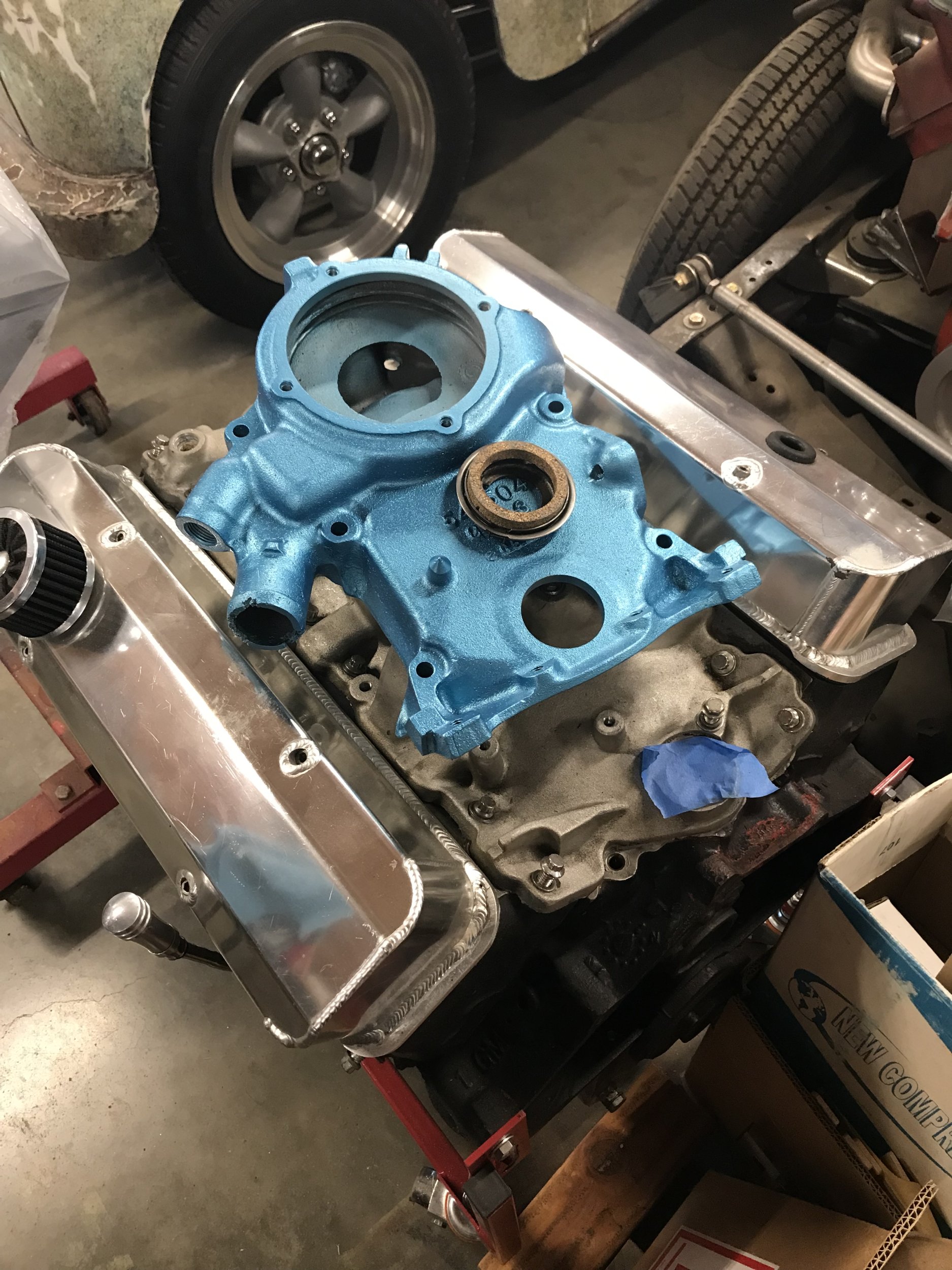

    Here’s one of the idiosyncrasies of early engines. Instead of the common press-in lip seal (supplied in the gasket kit), in 1962 Pontiac used a spring loaded cork seal that rides on the inside of the timing cover. A cork seal that is not supplied in the gasket kit. It’s the kind of thing that I would expect to see in a 1920s Chevy or Dodge. Apparently, it works pretty well, the current Stude engine (a ‘59 389) doesn’t leak up front after over 60 years.
    We considered machining the cover for the new style seal but nah, it’ll be fine.
    My buddy Willy, an old hand at old engines, told me to order from Best Gasket next time. They are better with gaskets for old engines.
    If you enlarge the image a little you can see the spring washer inside.

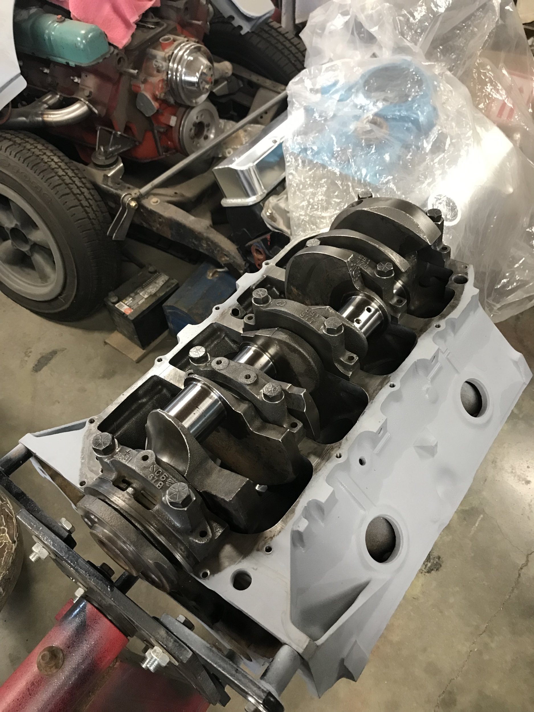

    Today was my birthday. Three quarters of a century roaming the earth and relentlessly tinkering with stuff. To celebrate, I did some work on the new Stude engine. Pretty boring fella. In my defense, my wife and I did meet my sister for breakfast and bought some steaks for tonight on our way home.
    All of the clearances checked out so I installed the crank. I used a modern seal from BOP. It’s all in and torqued. Everything was deburred before going to the machine shop. They did a commendable job of cleaning everything and I cleaned it all again (and again). It’s just in primer right now to prevent rust. I’m still on the proverbial fence about color choice - Oldsmobile blue (fancy) or good old fashioned gloss black (subdued, but all business look).
    I painted the timing cover with the Olds blue as a test. The black SBC that it’s sitting on is responsible for my indecision.

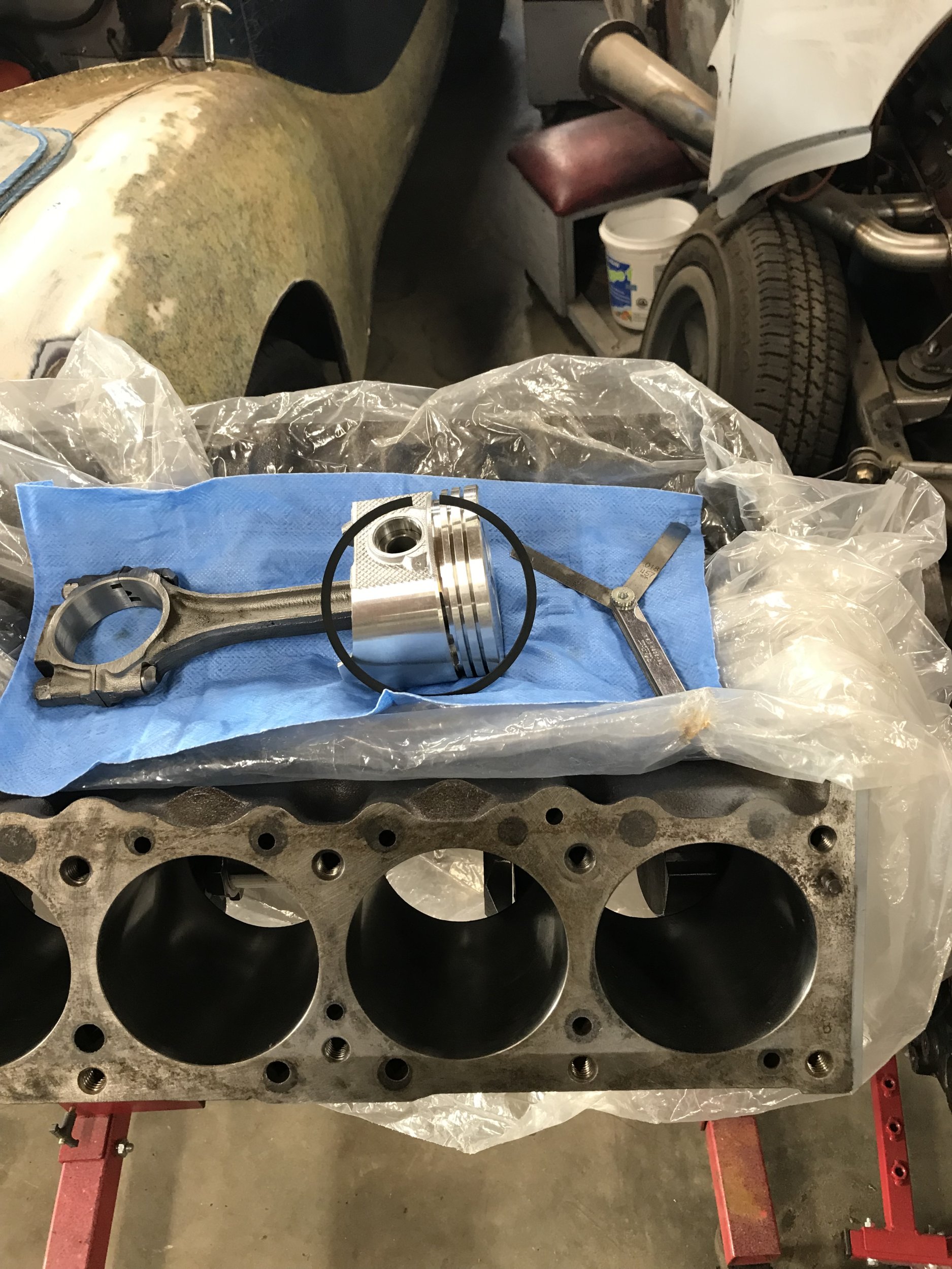

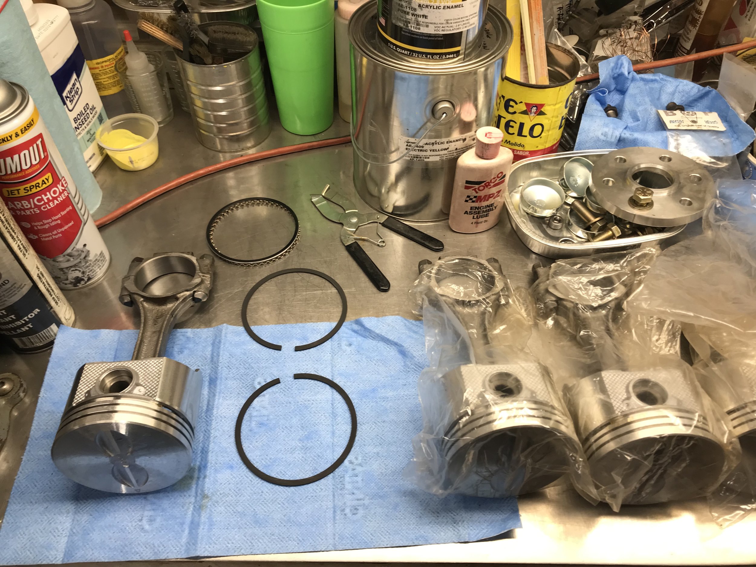

    I fit the rings and ***embled them on the pistons. I’m ready to knock some pistons in if I can find my #;$&#+=* ring compressor. I swear I spend more time looking for things than actually working on things sometimes. Like looking for my Plastigage. I got both toolbox tops cleaned and reorganized and still ended up going to the parts store. I’m sure I’ll find it, after I get the engine ***embled.

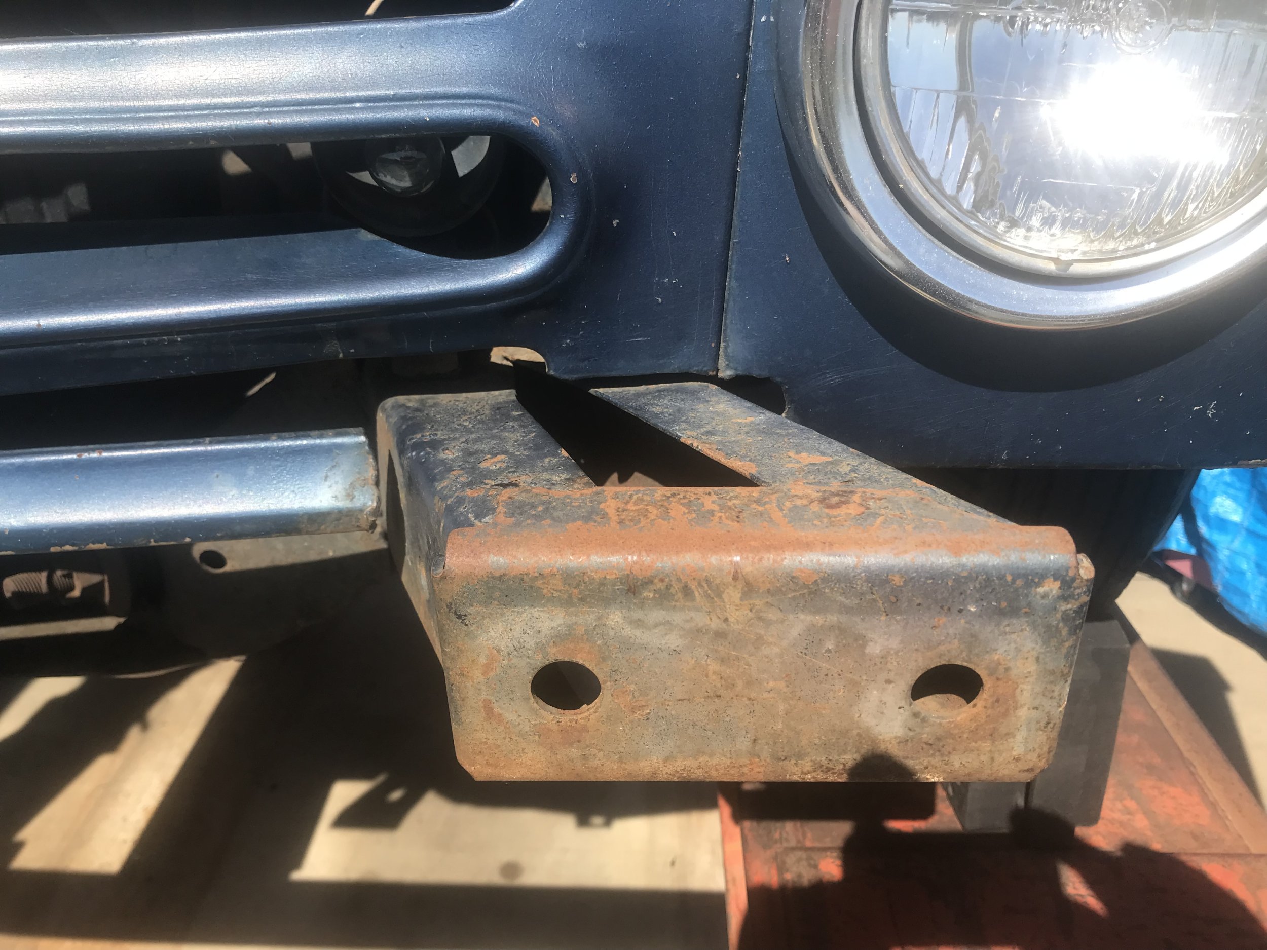

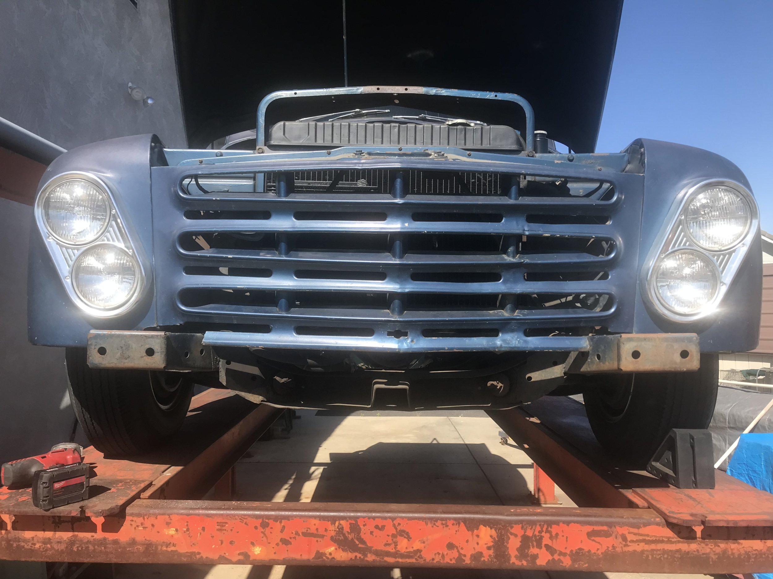

    I uncovered the old Stude and put it on the rack with a couple tasks in mind: 1. major clean and wax of my chrome wheels and 2. Do something about the hideous knobs sticking out under the front end.
    We all know all about cleaning custom wheels so never mind that. I’ve been wanting to do something about these since I got the truck.
    It’s a ’58 Plymouth front clip and I guess they really wanted their front bumpers to have a solid foundation back then.
    I’m going to put them on a diet while keeping a factory look even though they probably won’t show much once I get a bumper on there.
    Once the excess was trimmed off I cut a chunk out of each piece to become the new frame horn.
    I’ll give the new pieces some character before I weld them on. Also, I want to repair the torch work that they did while making the front sheet metal fit the Plymouth front clip before adding the new horns.
