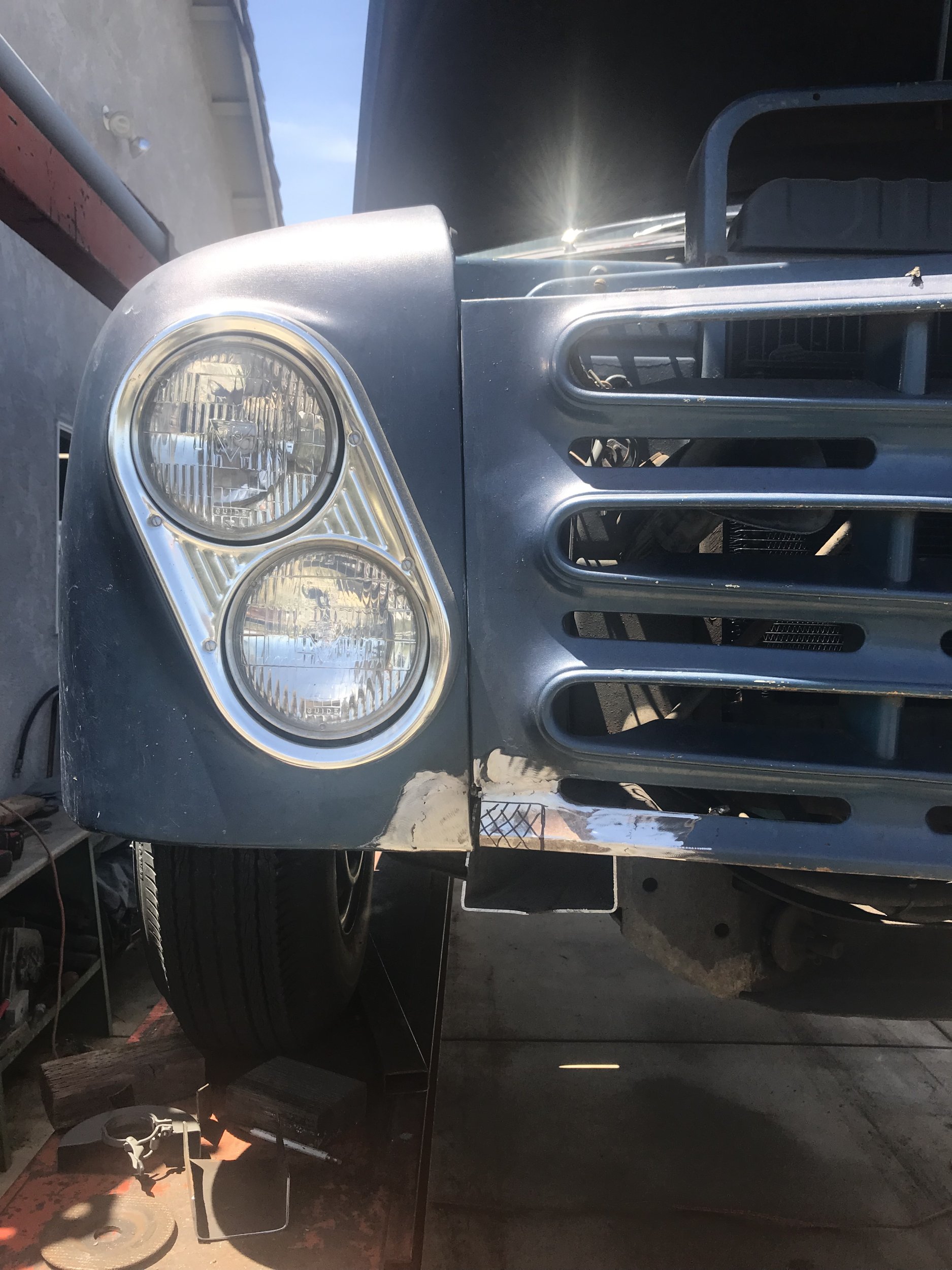

    4 56 Studebaker.JPG IMG_2080.JPG Tucking the front bumper in a bit made a big difference to the appearance of the truck. It's well worth the little bit of work to takes to do it! I trimmed a bit off the bumper to get it closer with better results than these lousy pics show.

  2. bchctybob
    Joined: Sep 18, 2011
    Posts: 6,083
    bchctybob
    I like what you did.
    I’m going to do the same bumper treatment that I used on my previous Stude. It was easy and looked pretty good. I don’t have a bumper of any kind so I’ll have to start looking again.

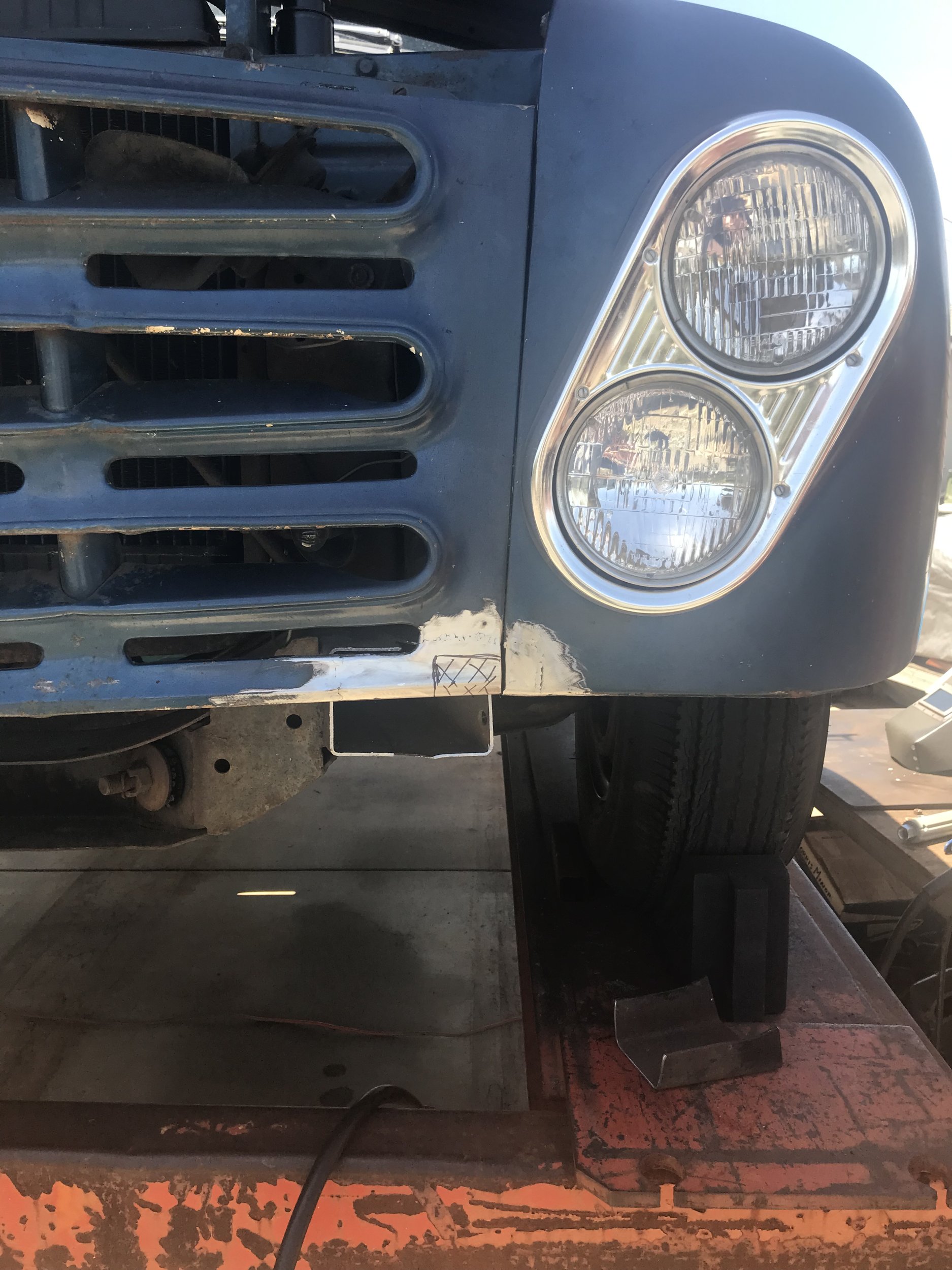

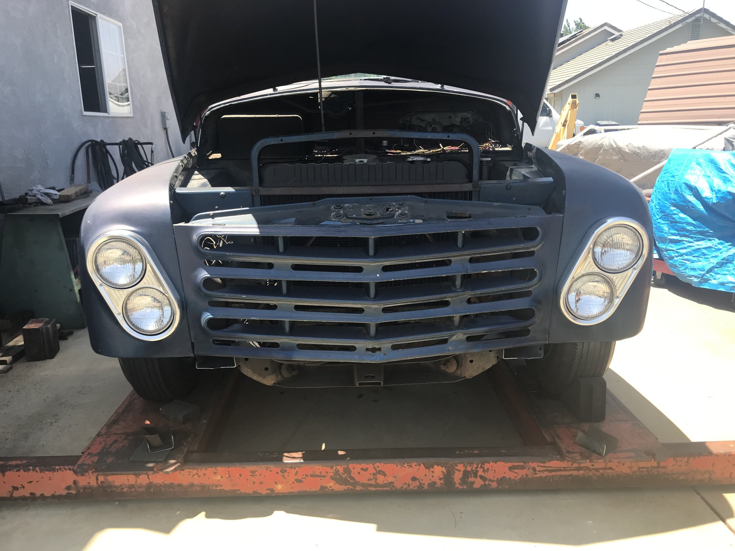

  3. bchctybob
    Posts: 6,083
    bchctybob
    I got the fenders and the bottom of the grille repaired today. Next will be adding the new frame horns. It’s not perfect, there’s a lot of little hammer and dolly work to do on the grille but for now it’s roughed in ok. It was fun figuring out how to make the little patch parts. Not as much fun welding them up - the wind came up, of course.

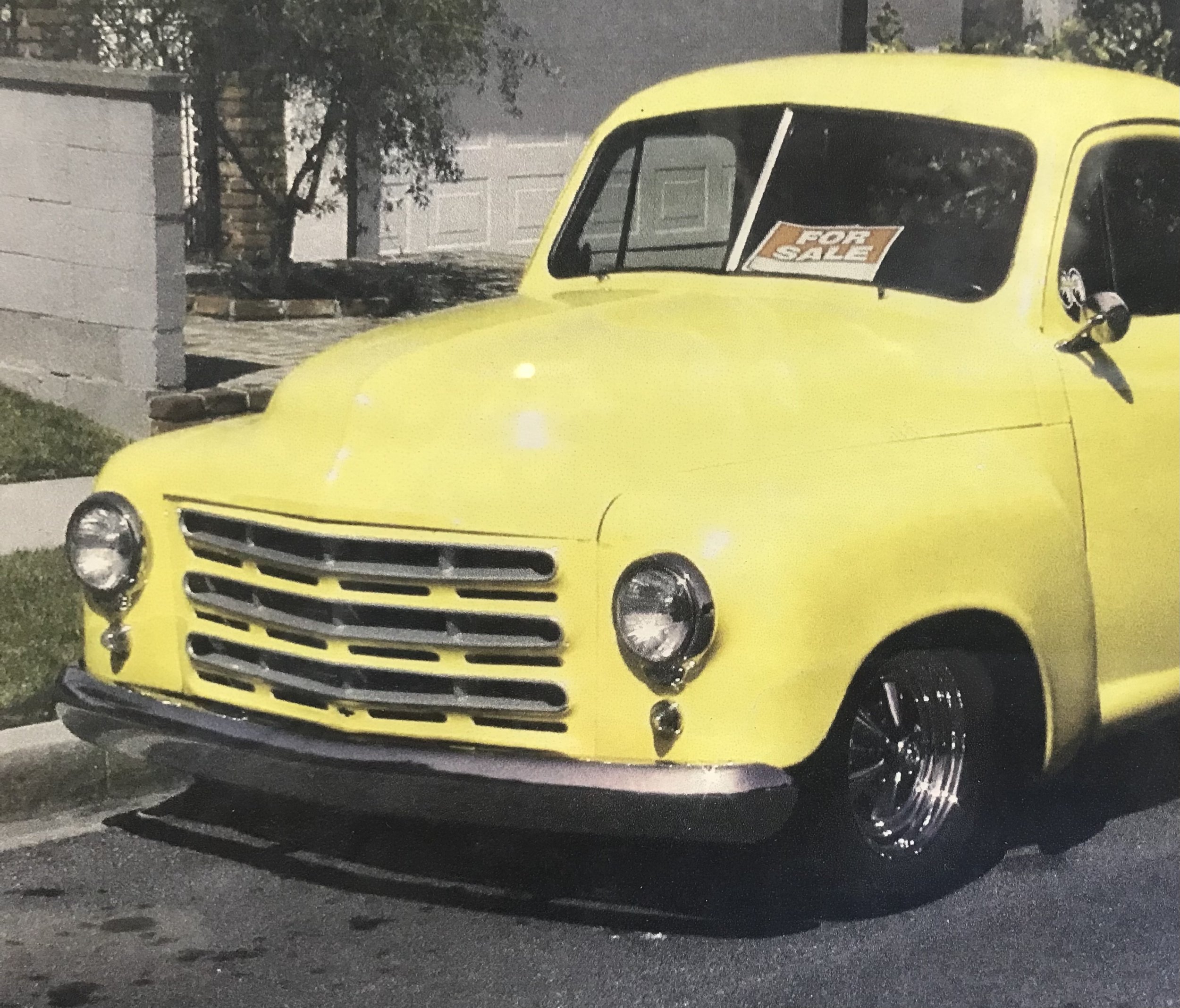

    I think that’s what I put on the yellow Stude. A neighbor was moving and gave me all the junk he took off of his ‘56 Chevy pickup as he customized it. A bumper was in the pile. I ***umed it came from his Chevy truck but maybe not. As I remember, I turned it upside down and pie cut the center just a bit. I intended to make a valance but never got around to it.
    It was a fun truck. 454 big block, big Isky solid lifter cam, 3000 stall converter, 8 3/4 with a 3.91 posi. It was supposed to be my “driver’s training truck” as I built my AA/GS Willys pickup nostalgia g***er.

    Yeah, that's the idea I had. It does look good on the yellow truck and I like that it extends outward to better protect the fenders.

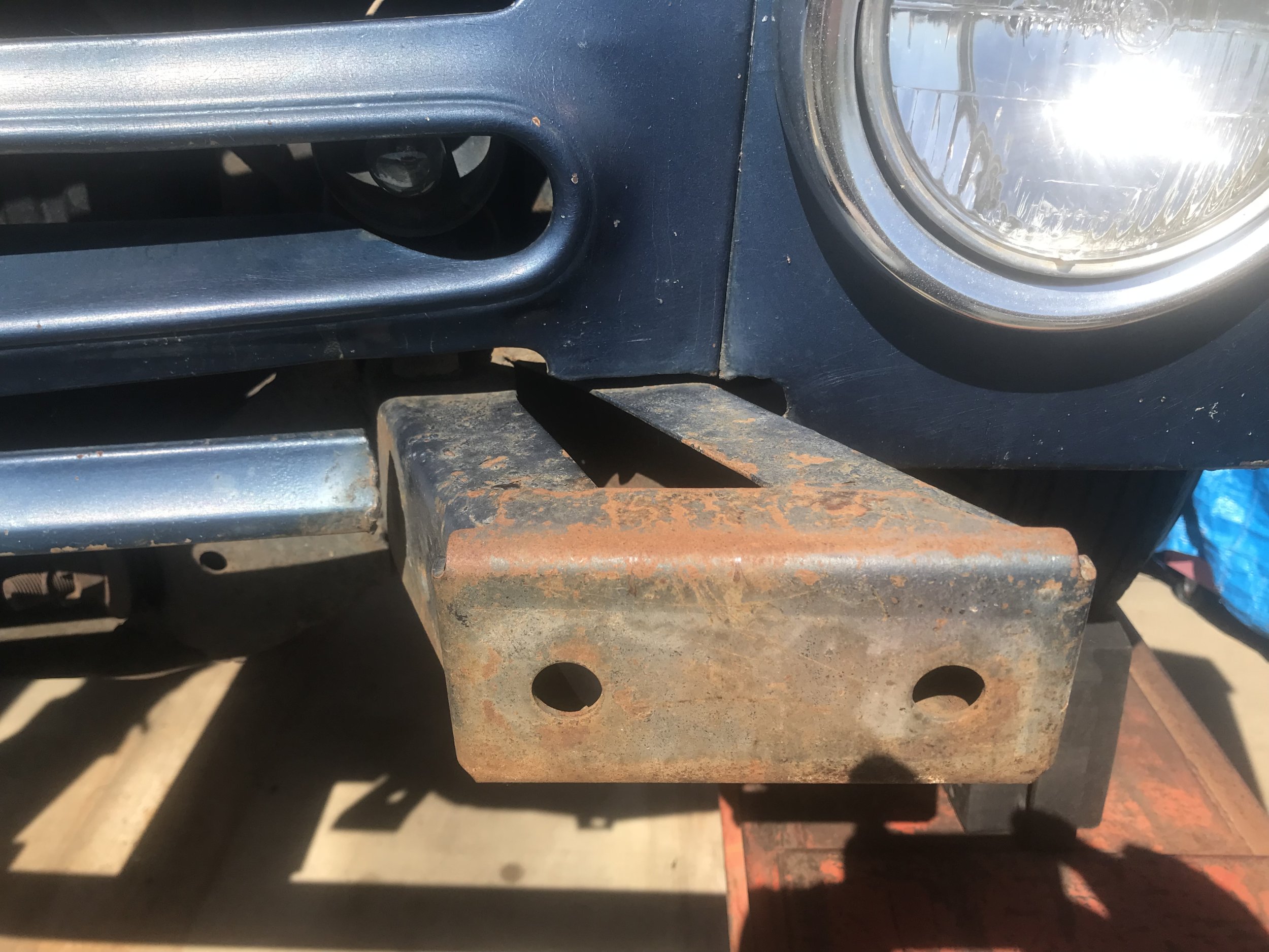

    I decided not to do the new frame horns until I have a bumper of some kind. So I put on some etching primer, then some build primer. I kinda like primer spots on old cars.
    But looking through my paint cabinet, I found a rattle can of Indigo blue metallic paint left over from my color experiments on my roadster. So I went ahead and sprayed the area then left it to dry. Today I looked at it in the morning sun and it looked silly, too shiny and too much metallic. So I knocked the gloss off with a fine Scotchbrite pad and it worked, good enough for who it’s for….
    I’ll probably clean the frame and shoot some ch***is black on it so it disappears..

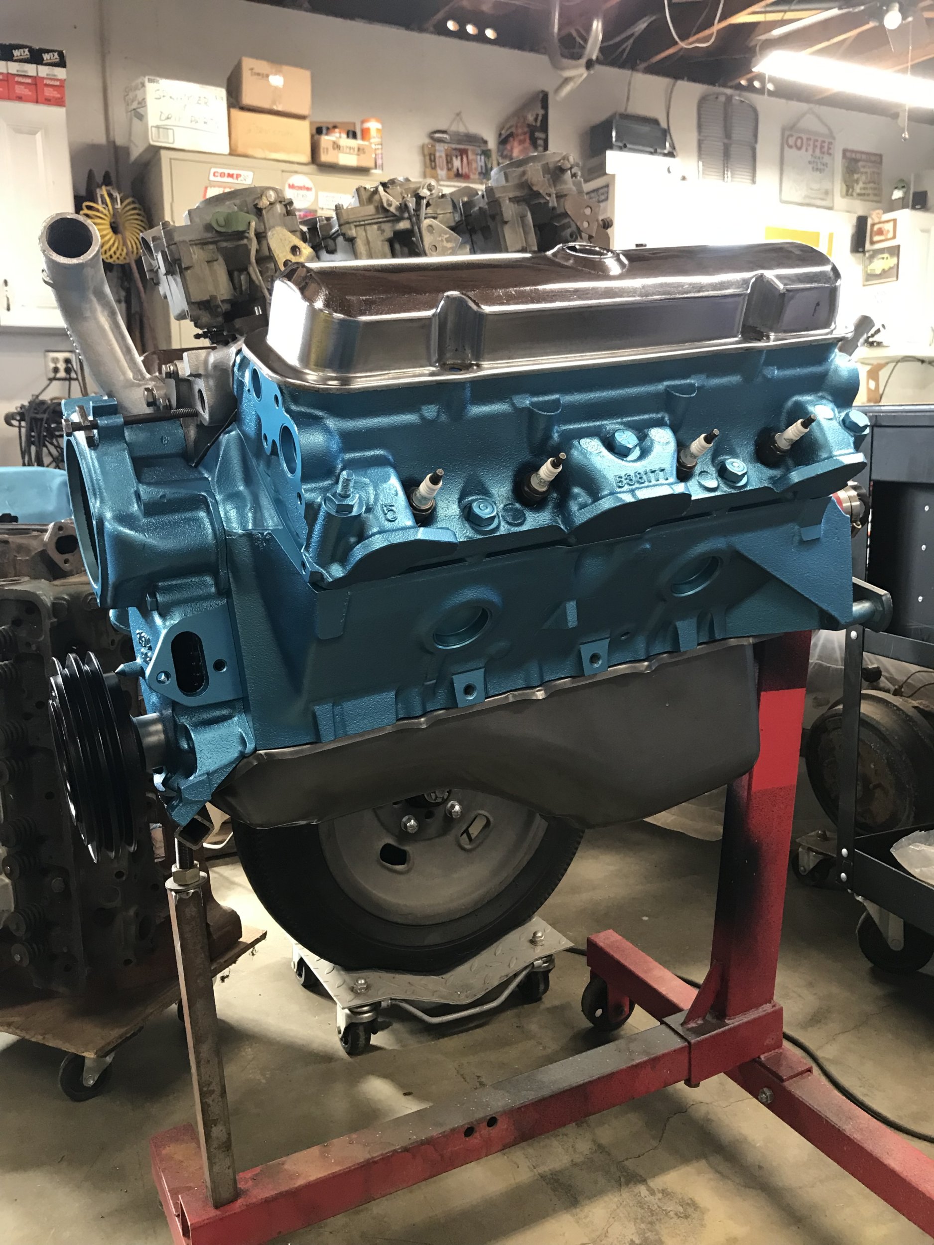

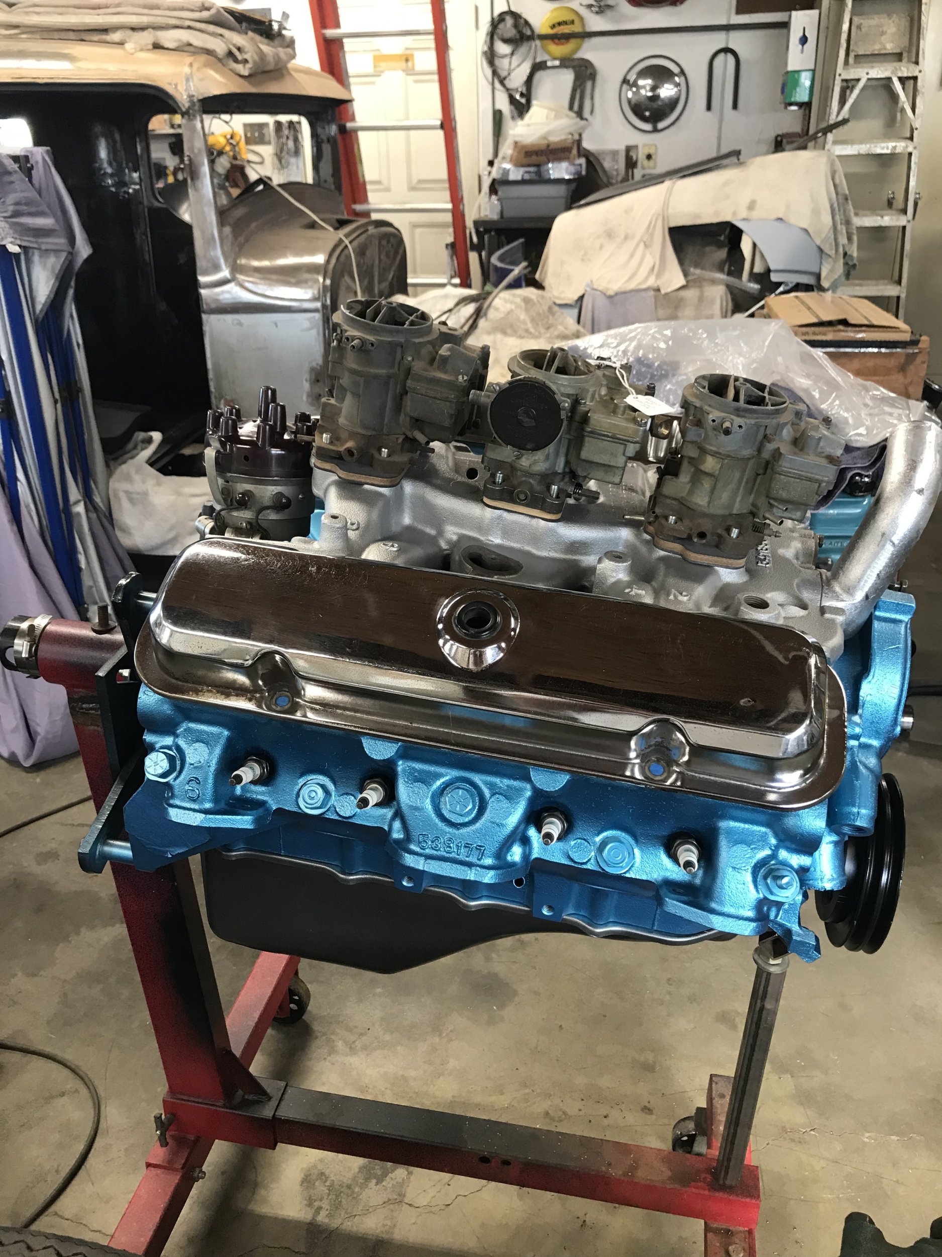

    I also finally got the new 389 mostly together and painted. I like the Olds blue.
    I just got home from vacation and the parts I ordered have all arrived so I can (hopefully) finish the ***embly and move it to the cart/run-in stand.
    I need to rework the carbs to make them into another TriPower and I have a few more little items to gather up before I can start it.
    It’s mocked up in the photos.

    I painted the oil pan with a medium gray metallic because I didn’t want to waste the expensive Olds paint on it but I still wanted it to look good. When I swap the engines, I’ll have to swap the oil pans. The pan on the truck is modified to clear the steering in the Stude.
    Squablow, Chucky, Budget36 and 19 others like this.

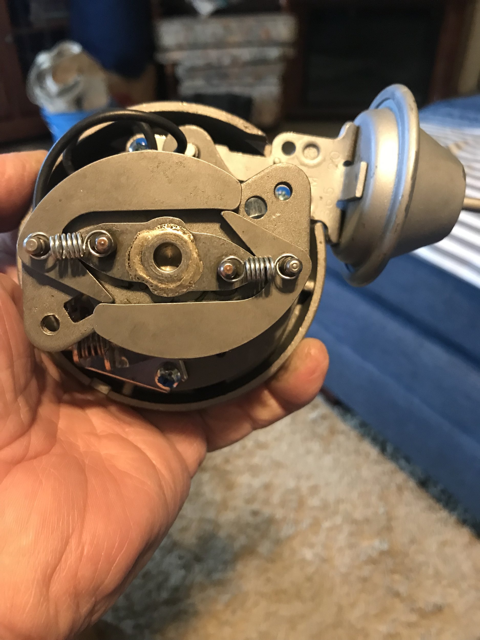

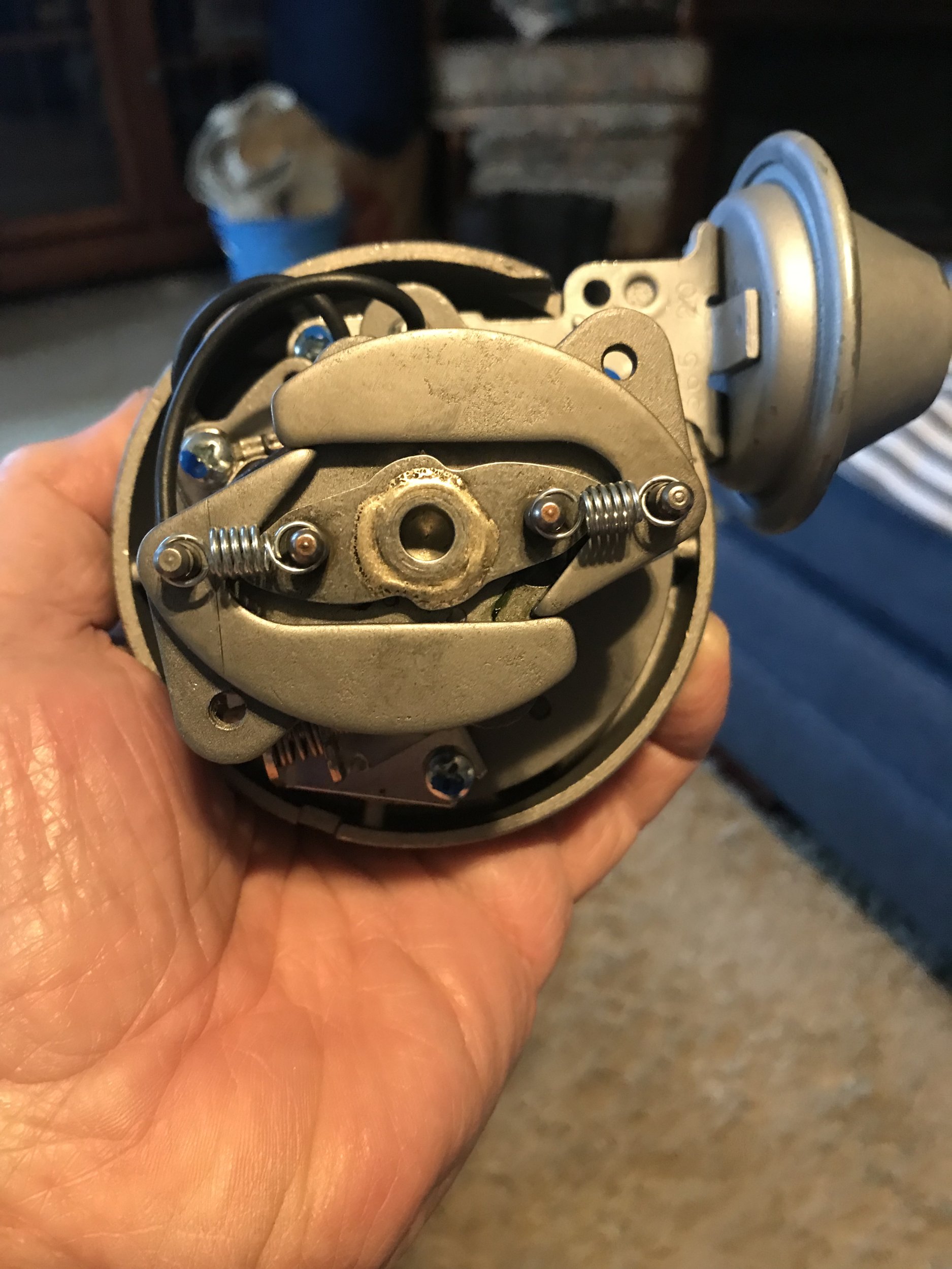

    UPS dropped off my new distributor from RockAuto this afternoon. I also got a cap and rotor, Wells brand (never heard of them) but they have br*** contacts and are black.
    See anything missing here?

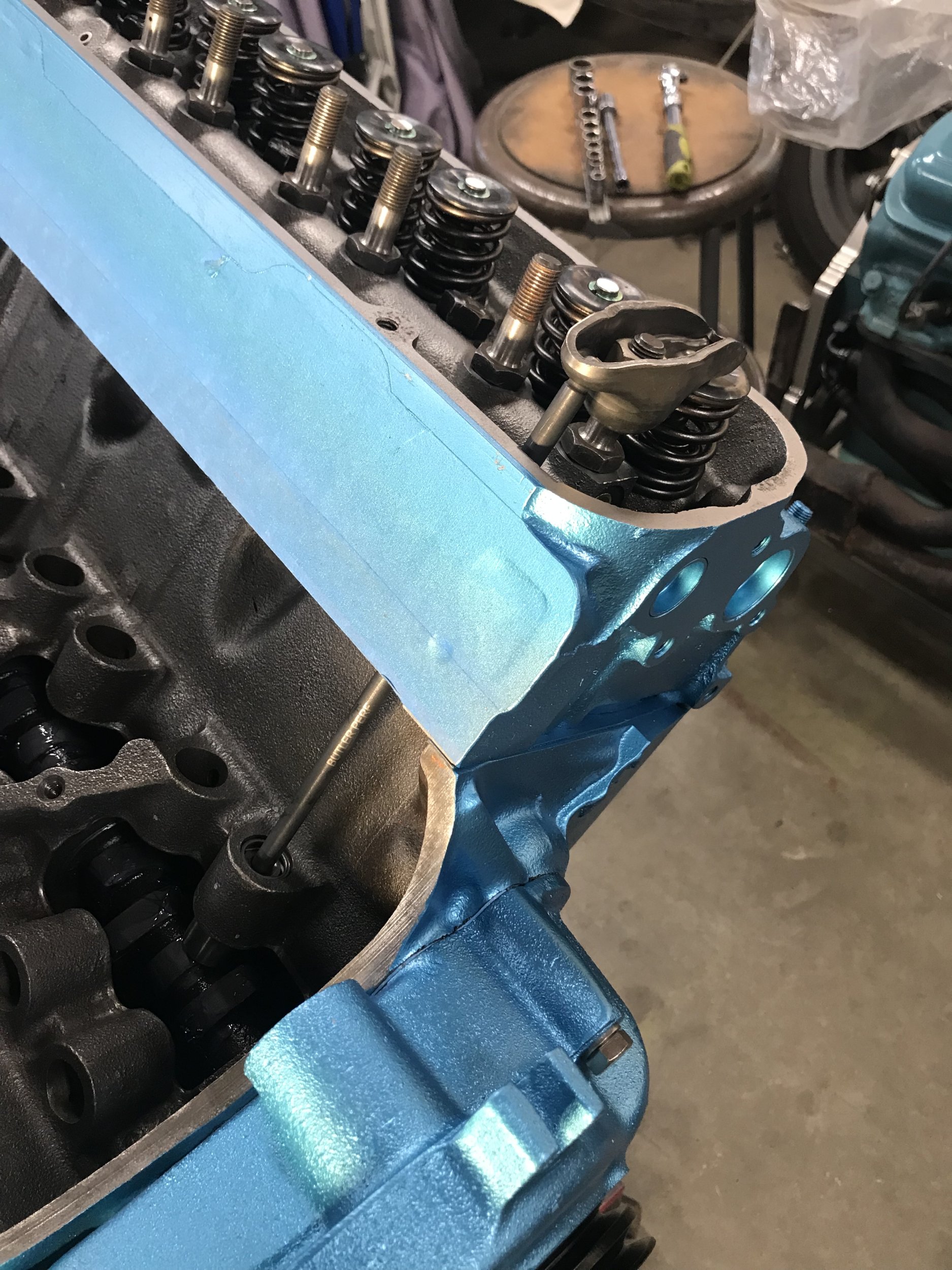

    I did a quick check of the rocker arm geometry since everything from the cam to the valves has been machined or replaced. The stars aligned and the sweep pattern falls almost perfectly centered on the tip of the valve. (Thanks Willy. He did all the machine work ) Nowhere near coil bind with the new springs and no retainer interference. I really didn’t expect any problems in those areas since it’s a small cam but ya gotta check.
    Now I can finish ****oning up the top end and start on the carburetors.

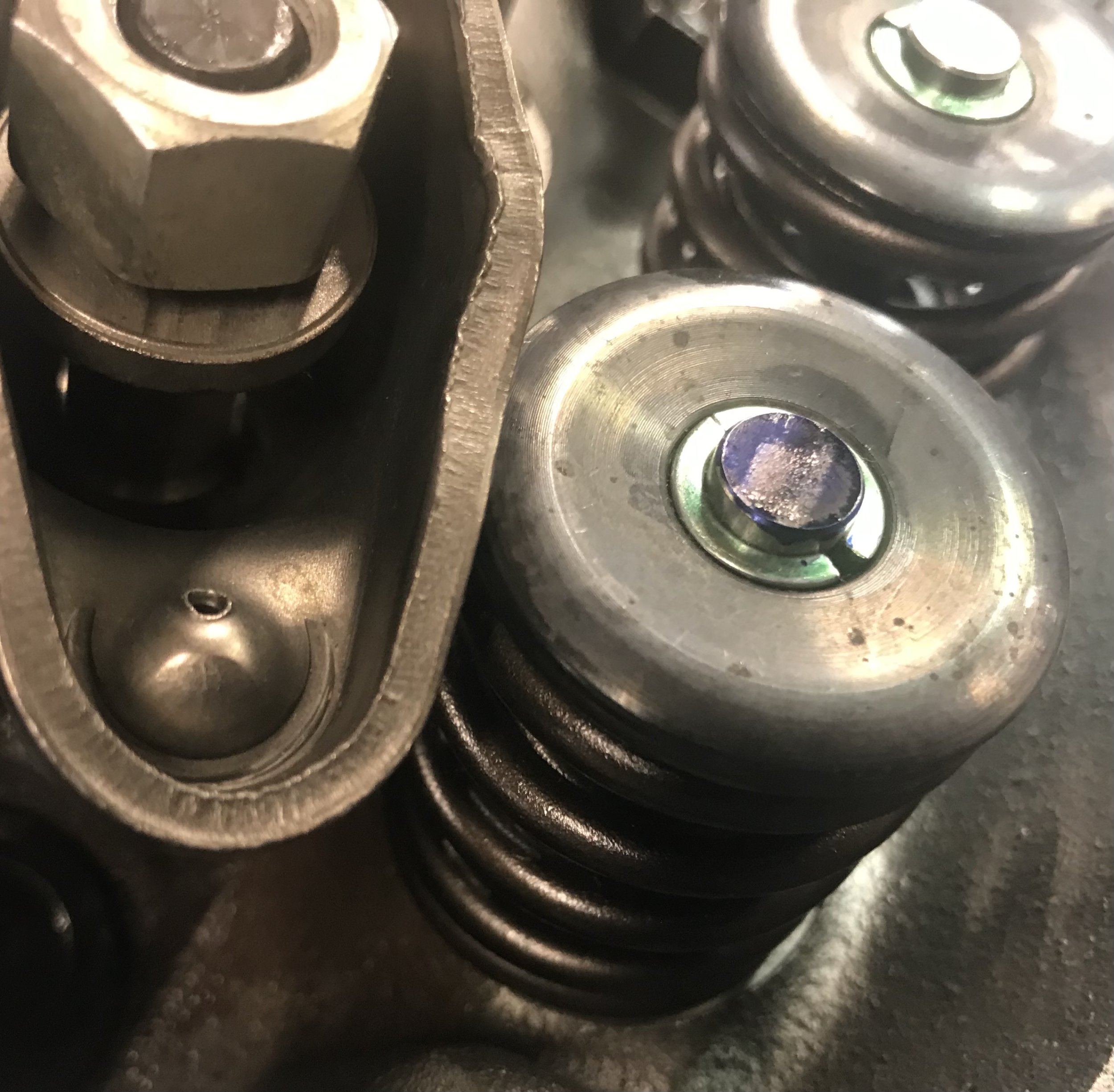

    I shoulda looked into the nut bag when I got the Comp Cams rockers. I checked the balls and they were 7/16” so I ***umed….
