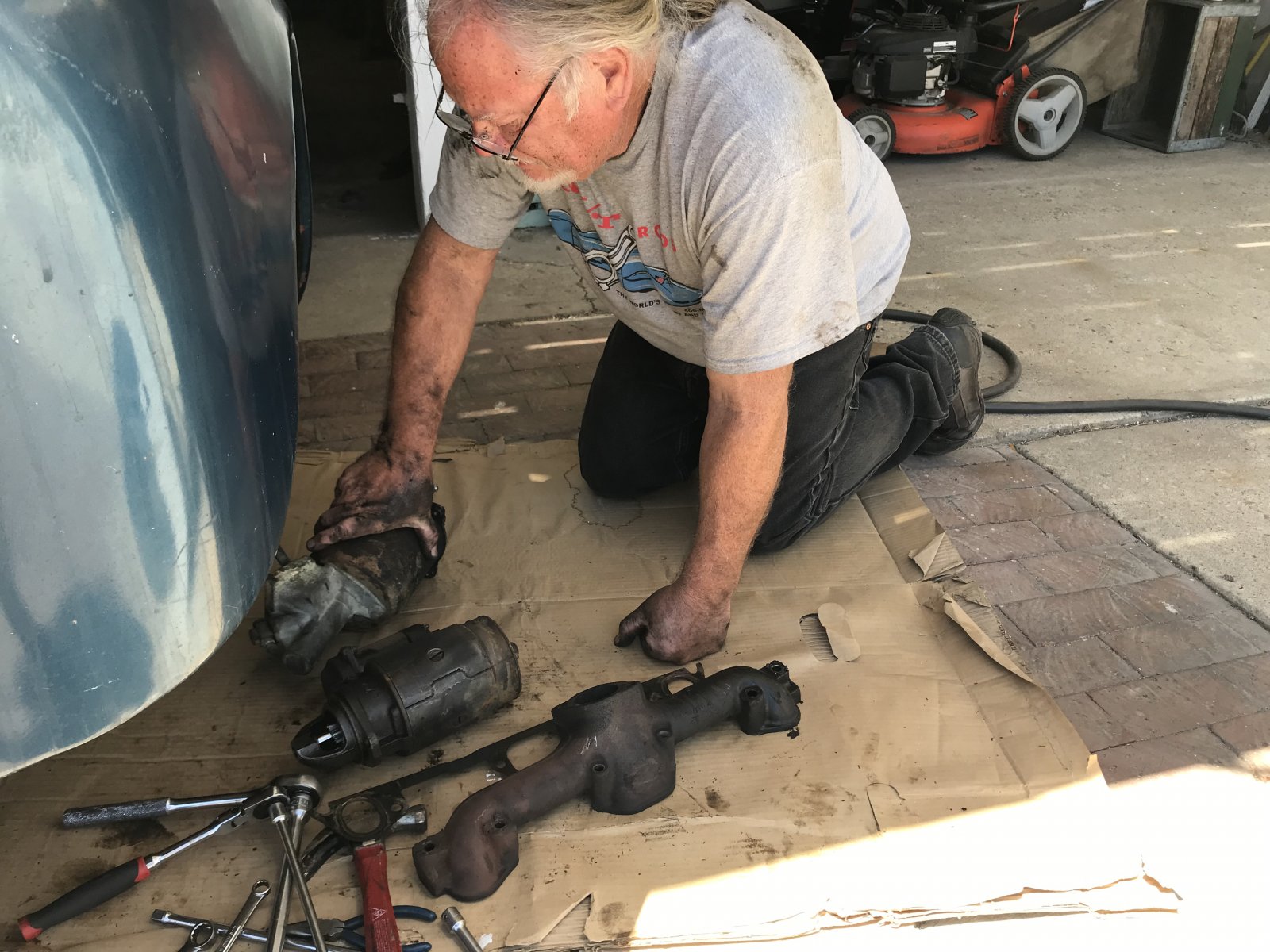

    And, of course, I have the truck jacked up and the wheel off sooo……
    I tried to loosen the head pipe bolts thinking that they would be rusted and I’d just call it a day, but they came loose easily. So I unbolted the exhaust manifold. Of course, the “fold-over” factory Pontiac lock washers were in place making it a little more work but they too cooperated and I soon had the manifold out. I removed and tagged the starter wires and removed the starter bolts. With a little maneuvering, I snaked it out also. That exposed the freeze plug with a 1/2” rust hole in it. No wonder the water ran out as fast as I put it in.
    So I’m on a roll. Let’s get what I really came under here for; the Treadle-Vac unit. The mounting bolts came out easily but the actuating rod was struck pretty securely in the backside of the pedal. With some WD-40, a brick and a claw hammer (I did mention that I’m working with limited tools, right) the pedal let go of the rod and the unit was free. Almost. I forgot about the vacuum hose. Of course it has a spring clamp and access for pliers is non existent. It took longer to get that damned hose off than it took to get all of the other stuff out. It took a long 3/8 extension with a hole for the retaining ball and needle nose pliers (don’t ask), I finally got the hose off. I figured that there was room to weasel the unit out where the starter was, I didn’t figure on all of the stuff “sticking out”on three sides: the actuating rod, the dipstick tube and the hose fitting. After quite a few tries I finally found the correct orientation and I got it out. I was hot, tired and filthy but very happy.
    I’m gettin’ too old for this sh!t….nah.
    The wife said that I look like I’m holding a baby. With all the stuff in the way, it was the automotive equivalent of a difficult childbirth. Lol.
    Even the dipstick is stuck. By the time I got it maneuvered into a position where I could maybe remove the reservoir cover screws and the dipstick tube, it was ready to pull out.

    Believe it or not, I got it apart, pushed back into the garage and everything cleaned up by 2 pm, plenty of time to wash up and go down to the beach for a while. We went for a walk then had ****tails and dinner at our favorite restaurant down by the beach. A pretty good day in my book.
