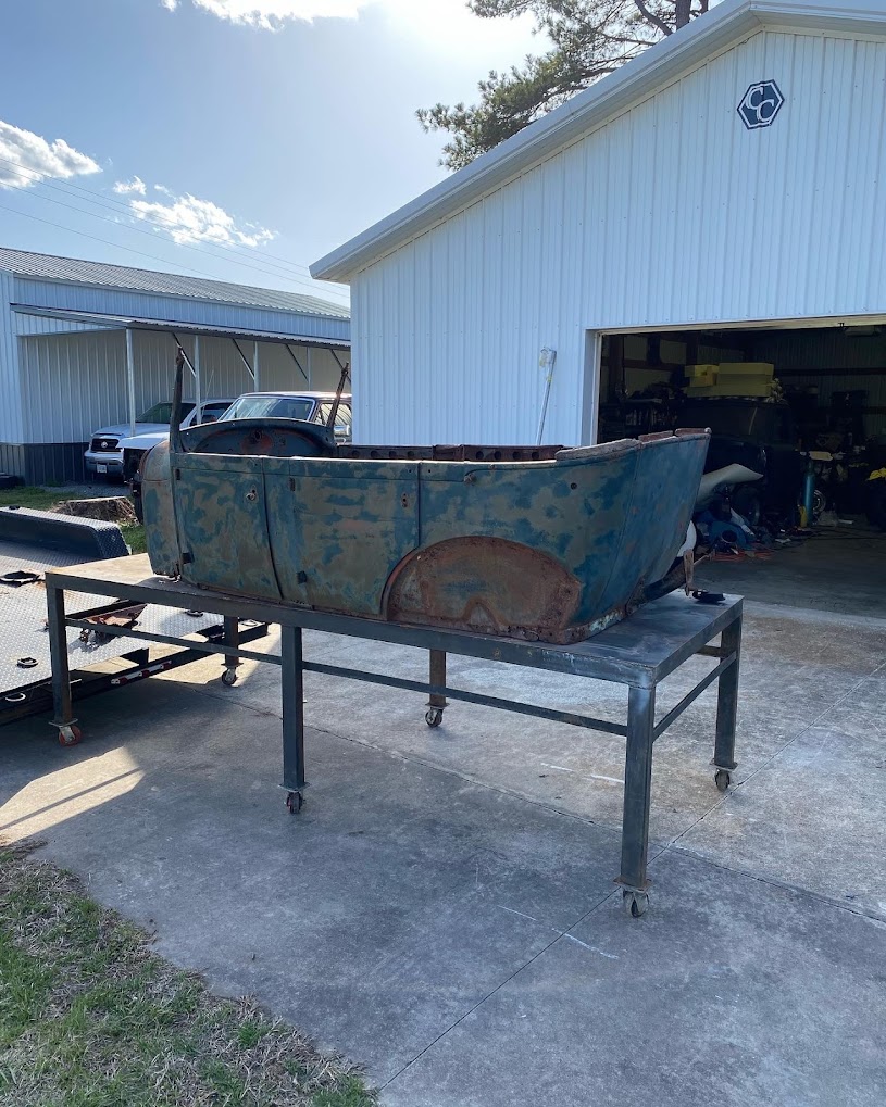

    And here is the Phaeton! This this will come all the way apart for a through rebuild of the body. but all the hard to find pieces are there, and i have a welder and some hammers so we should be fine.

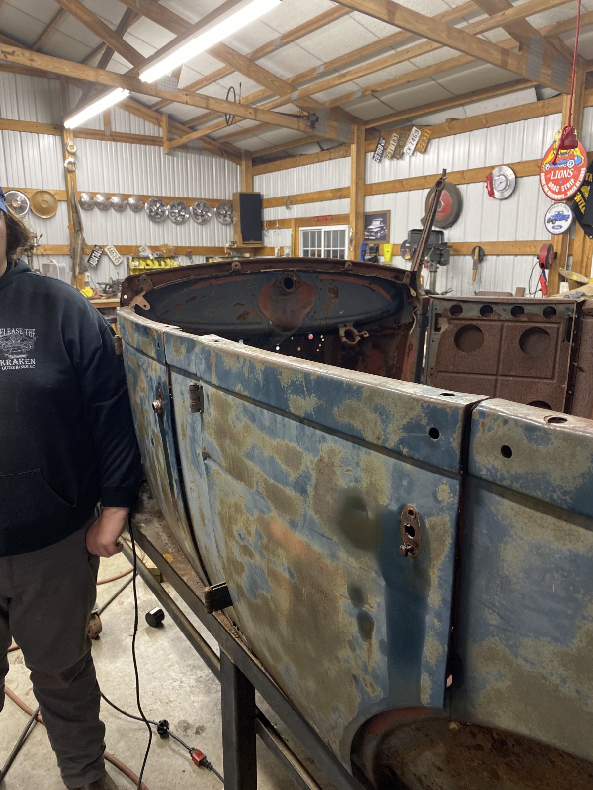

    Got a little progress done on Friday night. Pushed and pulled some things around, got the frozen door latches all out and the rear lower front seat back brace that bolts from b pillar to b pillar put back in. The door gaps and body lines got way better but not perfect. Looks like the b pillars are actually 3 inches closer together at the top than they should be and the rear quarters are about 2 inches closer together at the top than original. Still working out how to fix this. Right now I’m leaning towards blowing the whole thing apart and just putting the body all back together around all new sub rails before it ever gets mocked on the frame. It looks like if I cut out what needs to be cut out on the rear sub rails the whole back of the body will fall off. Nothing left to hold it together. I’m working on a plan but not completely sure yet…..

    Also got the windshield posts off and now I see why the were welded on. I’ll have to make the pieces to replace these that were ripped off at some point.

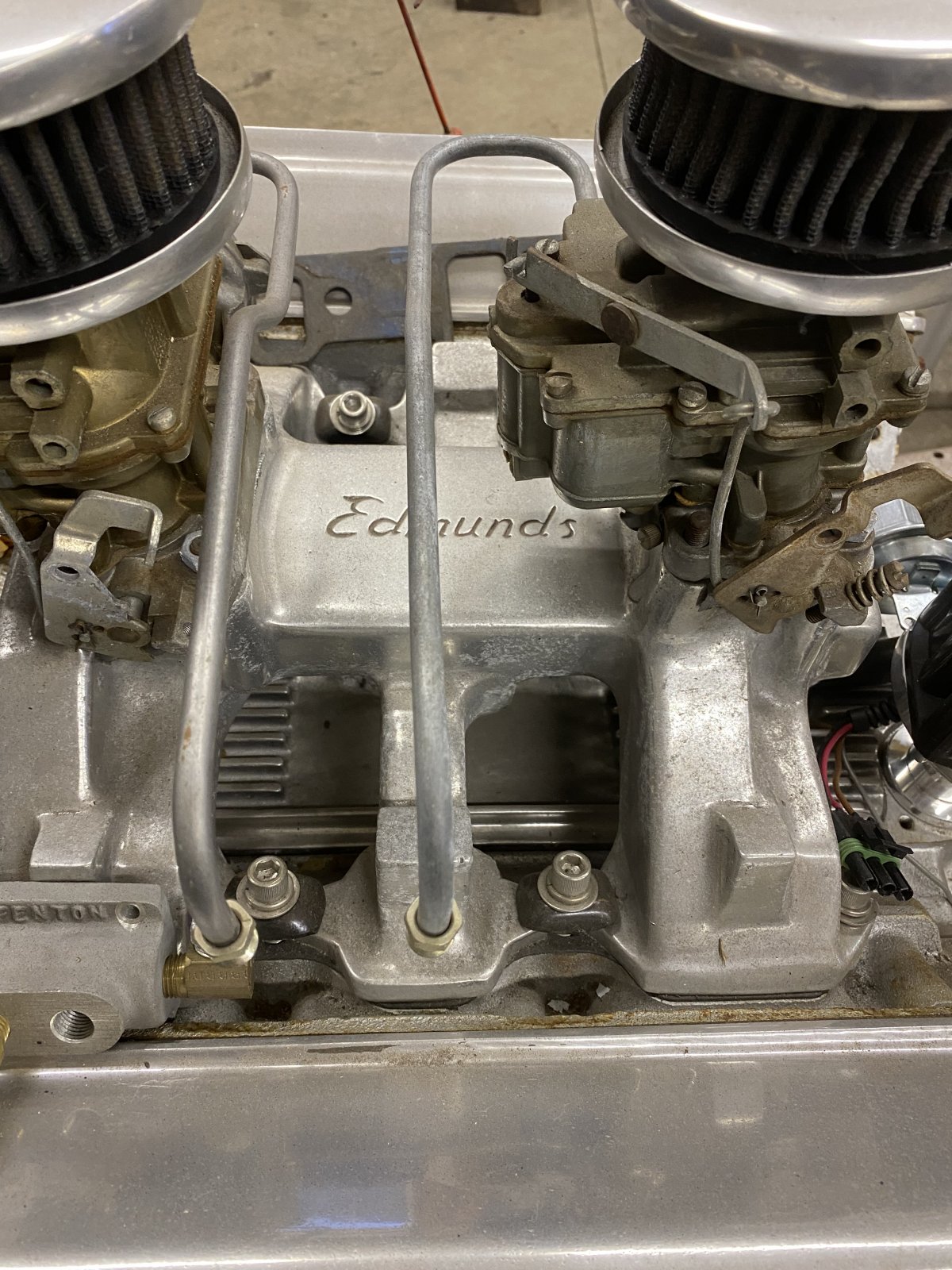

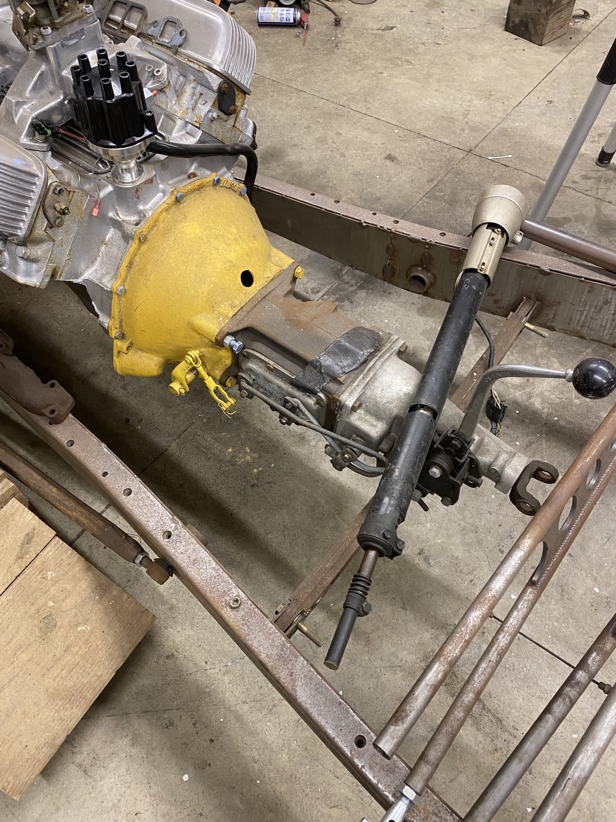

    here are some pics of the stude motor.

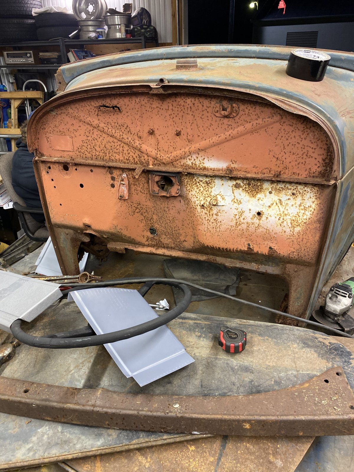

    Good old @ClutchDumpinDan hooked me up with a chunk of firewall to get the steering back where it belongs. I’ll go grab it this weekend to add to the pile of work… 2753D26A-1A73-45E9-8D6A-437184EFE1ED.jpeg B37D362E-00A8-4F62-A770-2DE6C4EFE2C3.jpeg

    Sweet! Didn’t see this thread until just now. Can’t wait to follow along! Sorry to hear about your Dad. Definitely gotta ramp up the hang out time as they get older.
    Glad to see some use for that hunk of firewall. Hopefully find some more stuff you can use while here haha

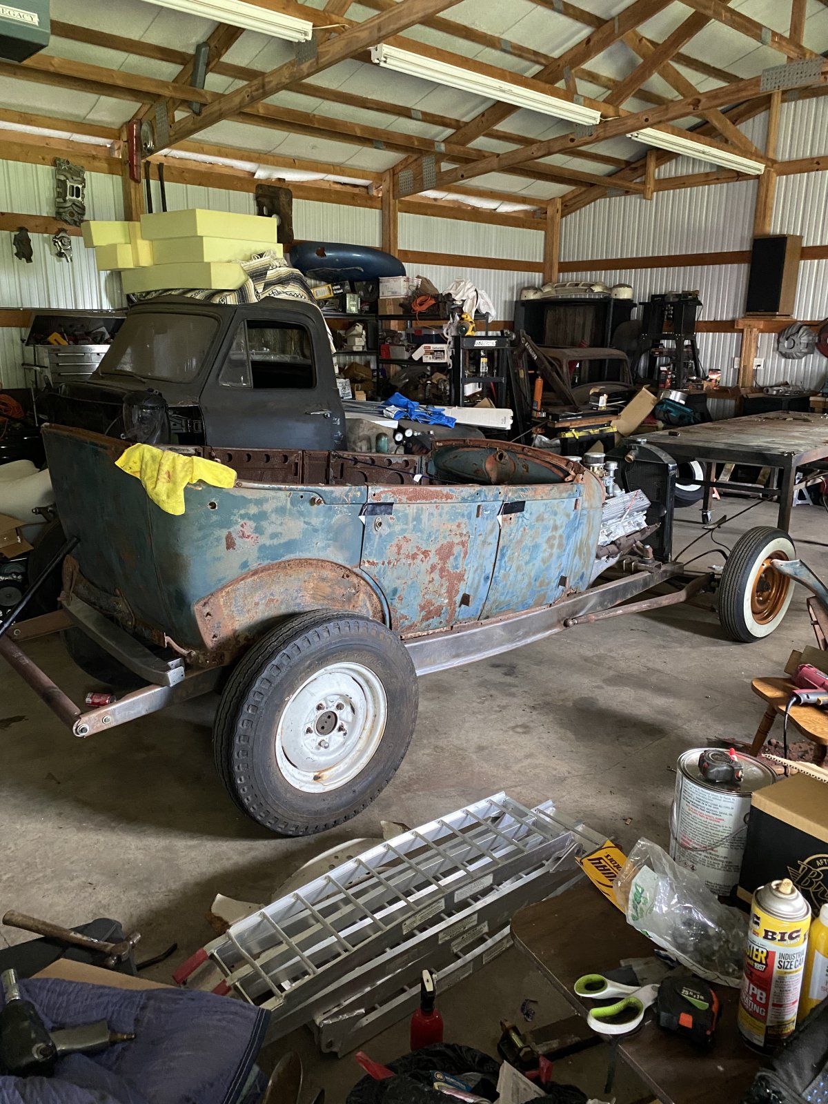

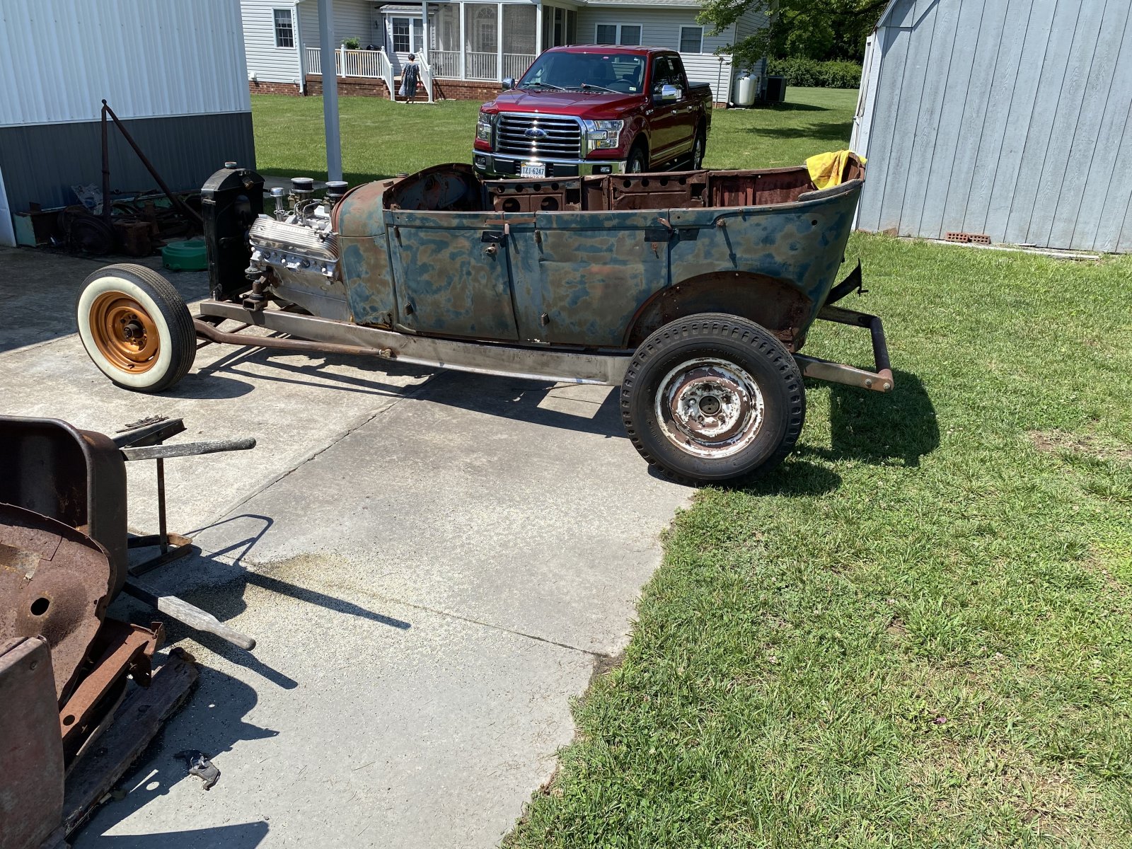

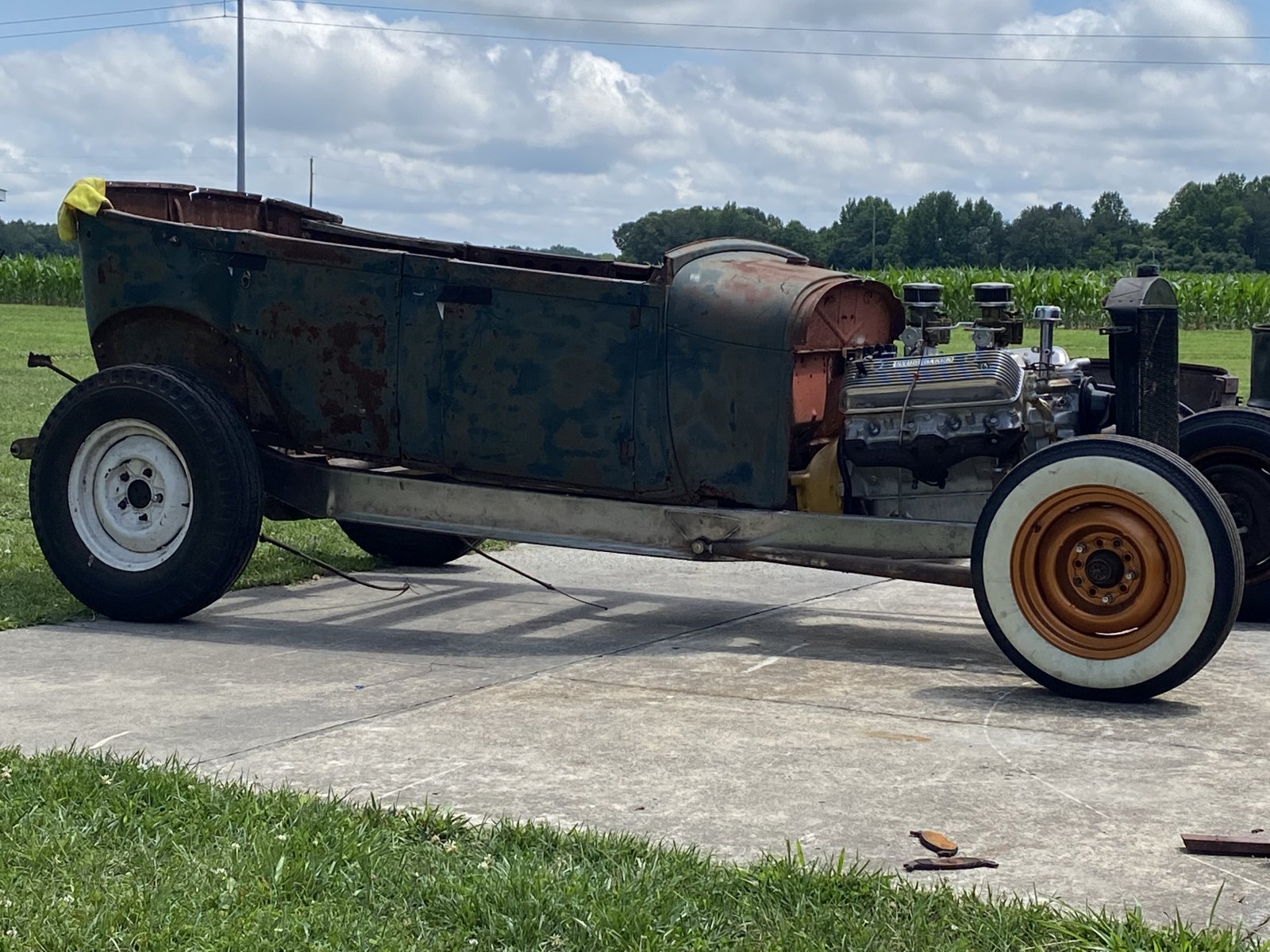

    Been busy with work and fam but finally got some progress done. Actually toying with the idea of selling this and my 32 Tudor to fund another car I found. But until that happens work will continue.
    got the body mocked up on the frame today. Still needs more of the subrails cut out to fit over the rear kick up but I’m not to that point yet. The body will come down almost 4 inches in the rear. So that will look better and I’m not digging the axle in front of the crossmember, so it’s gonna need a dropped axle and go spring over to shorten the wheelbase. But other than that I’m digging this pretty hard.
