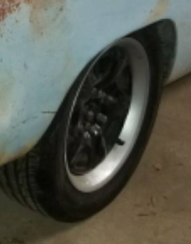

  16. Peanut 1959
    Joined: Oct 11, 2008
    Posts: 2,188
    Peanut 1959
    My comment had nothing to do with the *width* of the tire.
    It was specifically about the current wheel design (they appear to be '80s GM stamped steel "mags" or even pro-touring style aftermarket alloys).
    But maybe they're just rollers for the build process. On that, I could give him a p***! Screenshot_20191023-174300.jpeg

  18. vetteguy402
    Joined: Oct 27, 2009
    Posts: 152
    vetteguy402
    from omaha, ne
    Those are from the newer, low option Camaro cars. Good enough to hide under moon discs.
