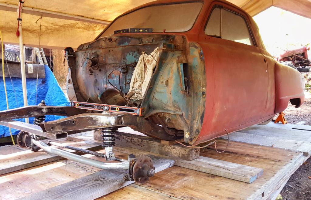

  3. rudestude
    Joined: Mar 23, 2016
    Posts: 3,048
    rudestude
    I have a 50 Studebaker Champion and the front springs are coil type , 50-53 used coils , it's getting coil-over springs now with a dropped tube and four-bar set-up.... hopefully I will be back on it real soon...it's been on standby for a bit..... IMG_20171130_225400.jpeg IMG_20150923_173806473.jpeg 20151013_125051.jpeg
    Sent from my QTASUN1 using The H.A.M.B. mobile app

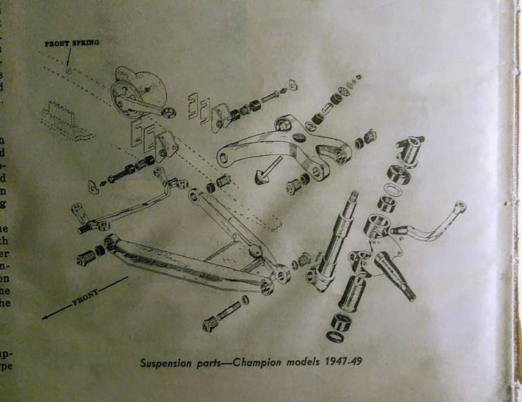

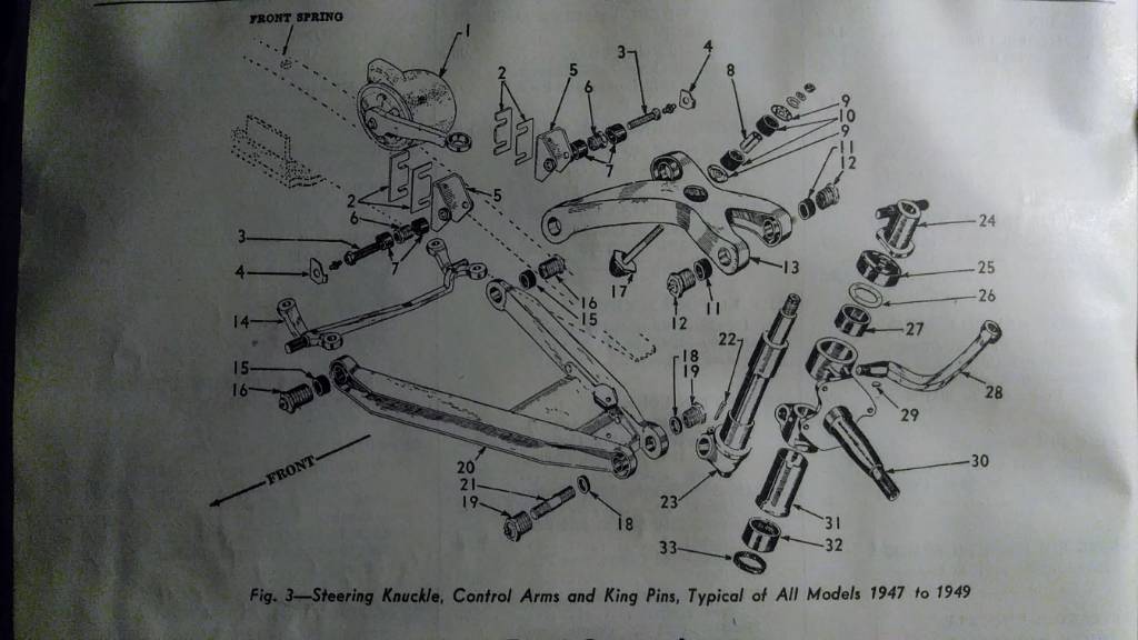

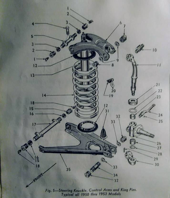

  16. rudestude
    Posts: 3,048
    rudestude
    Just for reference on the front suspension changes over the years in question.... IMG_20180712_154044~2.jpeg IMG_20180712_154113~2.jpeg IMG_20180712_154315~2.jpeg IMG_20180712_154340~2.jpeg IMG_20180712_154357~2.jpeg
    dana barlow likes this.
