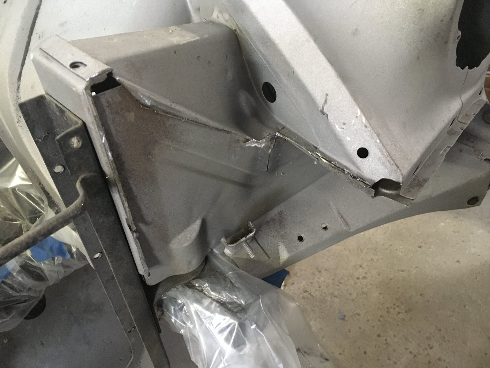

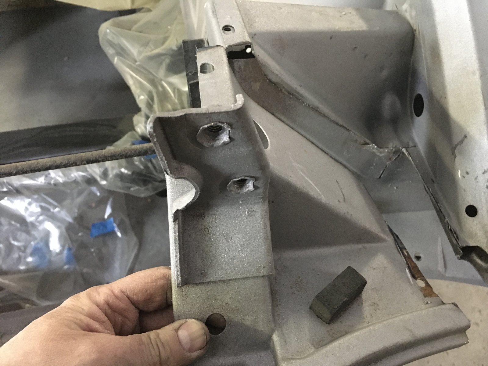

  7. 327Eric
    Joined: May 9, 2008
    Posts: 2,204
    327Eric
    Body of C,/k studies are the same from the cowl back. Doors changed in 57 and lost the cove. While the outer fenders are the same, the inner fenders(they are a one piece unit) are 53,54 only. 55 inner fenders will work with minor t*******. 56 and later fenders designed for the Hawk will not work. To convert a Hawk to a 53 nose you need the 53,54 hood, 53-55 front fenders, 53,54 hood release panel, grille shells and bars, upper grille support, and lower grille support, 53-55 radiator, and 53, 54 front bumper . 55 and later bumpers are different, and 4 door parts will not work as it is a shorter wheelbase, and completely different body, nose ets.To find all those parts separately was hard 20 years ago.(took me about 6 years, with internet) It would be cheaper to buy a parts car, now as then.

    I will reiterate what prior commenters stated, 53-61 Coupe (C models) are all the same basic body.
    The frames changed a bit...I used a 58 Frame under my 53, the C pillar frame mount was slightly different as well as the trunk mounts over the cross member (under the back gl***) The 53 had a bolt through the frame (two bolts) the later had a center bolt to the cross member. I believe 57 and up Hawks all used metal fins..I've parted out 58, 59 and 61 models. I believe that only the 56 Hawks had fibergl*** fins.
    The radiator is taller on the Hawks so you won't be able to use a 53 or 54 front clip without changing to a shorter radiator.
    The Sedans used different gl***. The K models (those are the hardtop version of the C coupes) are similar except the side gl*** and their mounts.
    I'd suggest just buying a 53 or 54 and then buy the fins. I actually bought three pretty much complete Hawks for parts to build my 53.

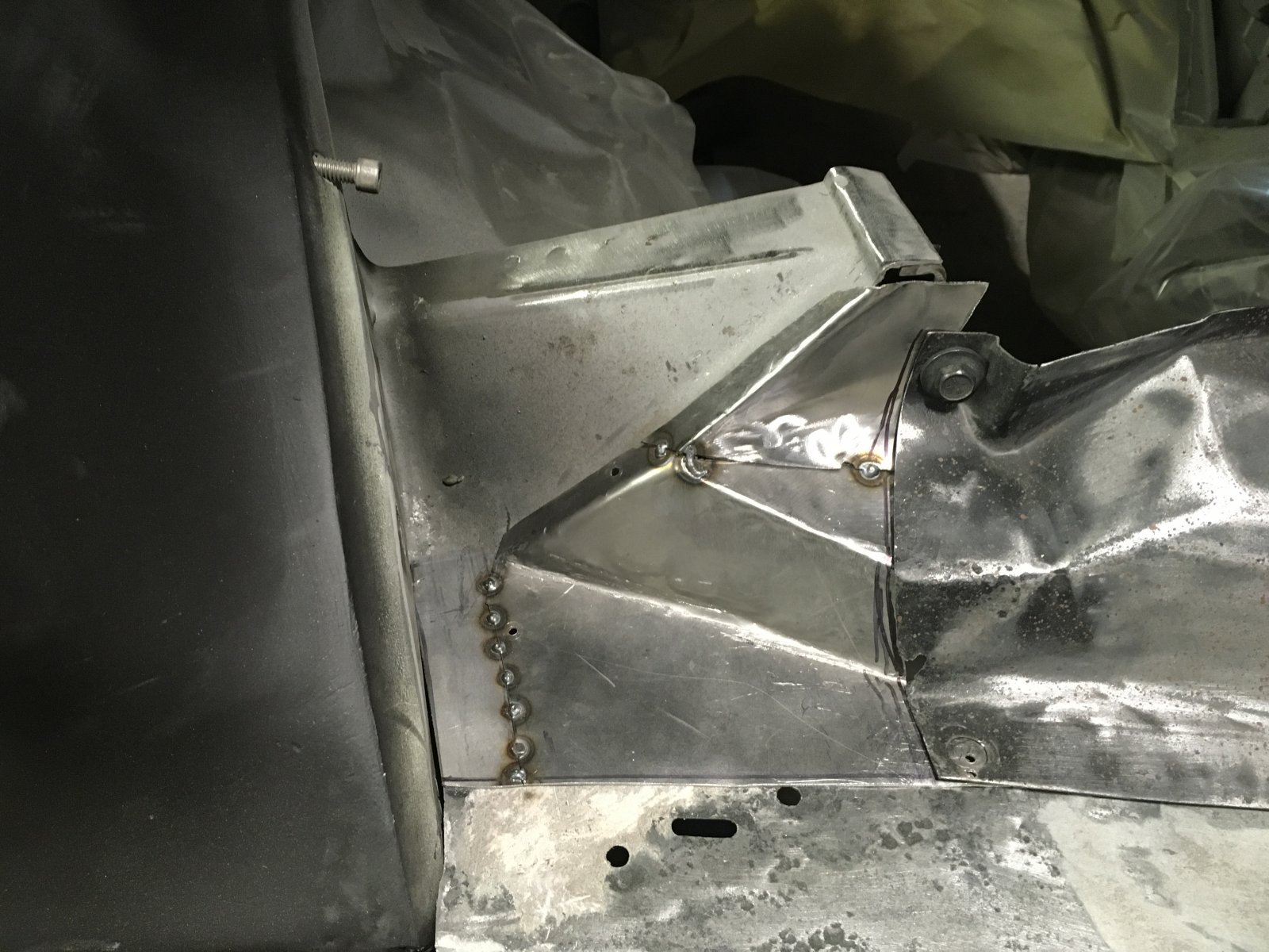

  17. nrgwizard
    Joined: Aug 18, 2006
    Posts: 3,054
    nrgwizard
    from Minn. uSA
    Scott;
    Glad you're going to save another Stude.
    Mike, 327, & vtx are correct.
    Stude stuff looks similar, but there are differences to be aware of.
    Stude used thin trim pieces to hide the seams.
    If you want the 56 Golden hawk ('gl***)fins(my favorite), I have a set that I won't be using. A friend or two may have some metal ones. The metal ones tend to rust at the lower outside fender attaching edge. It's only metal, but a pita to fix, & they usually aren't that expensive. Other than trim holes for the different years, 57-61 are the same.
    Also have some halos for the 57-58 Golden Hawks, if you want that look.
    Marcus...
  18. goldenidolcustoms
    Joined: Jun 13, 2010
    Posts: 362
    goldenidolcustoms
    from Pa.
    All the fins from 57 to 61 were metal. 56 were fibergl***
