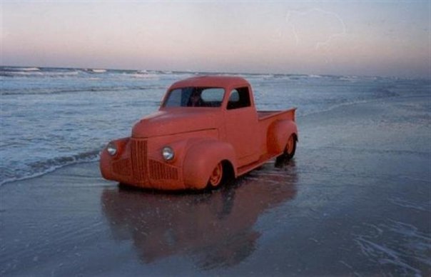

Would like to see some other m5 Stude trucks. Thinking about chopping mine Any inspiring pictures would be kool Here is mine taken just today as she is on her new S10 extreme chas . Seen here staying over at a friends for a bit. Baron
I think one of the charms of the M-series is the high doors and slanted windshield. It already looks like it's mildly chopped compared to the Fords and Chevys of the same era. Of course if you aren't 6-3 (like me) take all you want off the top!

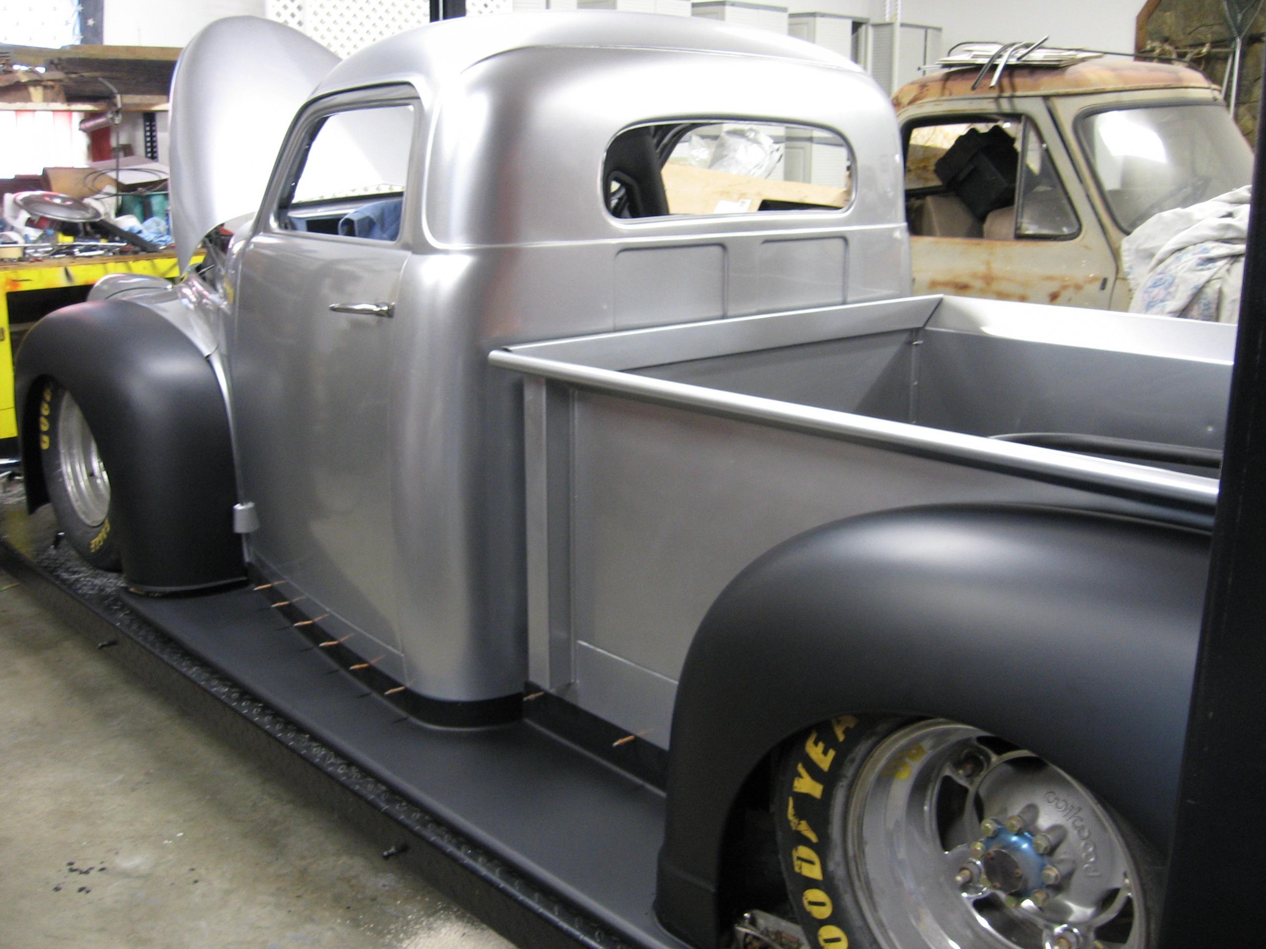

1941 stude, 3 inch top chop, 2 inch pancaked hood, 2 inch sectioned cowl, front fenders raised 4 inchs, 2 inchs cut from the bottom of cab, chaneled 6 inchs, wide fives with quickchange. 4 wheel disc brakes , 302 ford w/ 5 speed . built by Johnrodz , lanexa va

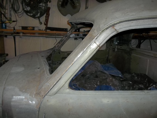

I like mine cut! This is 1&1/2" I did it more for the rake. Pretty easy chop too. any more and it would get more complicated, and I think it would need a section.
