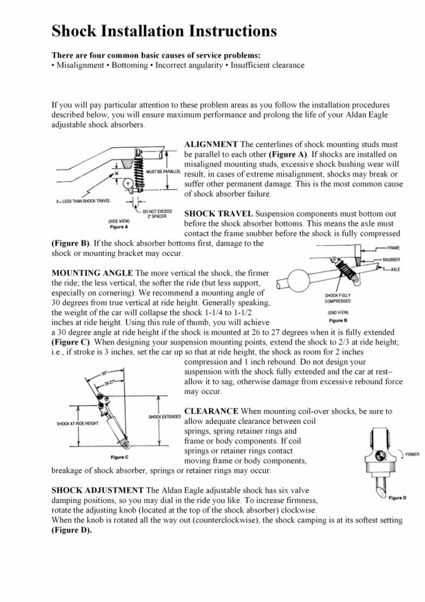

    I'd stand the shocks up a little to 20 degrees if possible. Laying them over to 45 degrees loses efficiency. The panhard bar is a lot better when working horizontally, less lateral movement.
    I'm in the same dilemma as to where to locate my battery, out of sight and accessible. I don't really want a long cable if at all possible. Love the graphics, more professional than a sketch. :D
