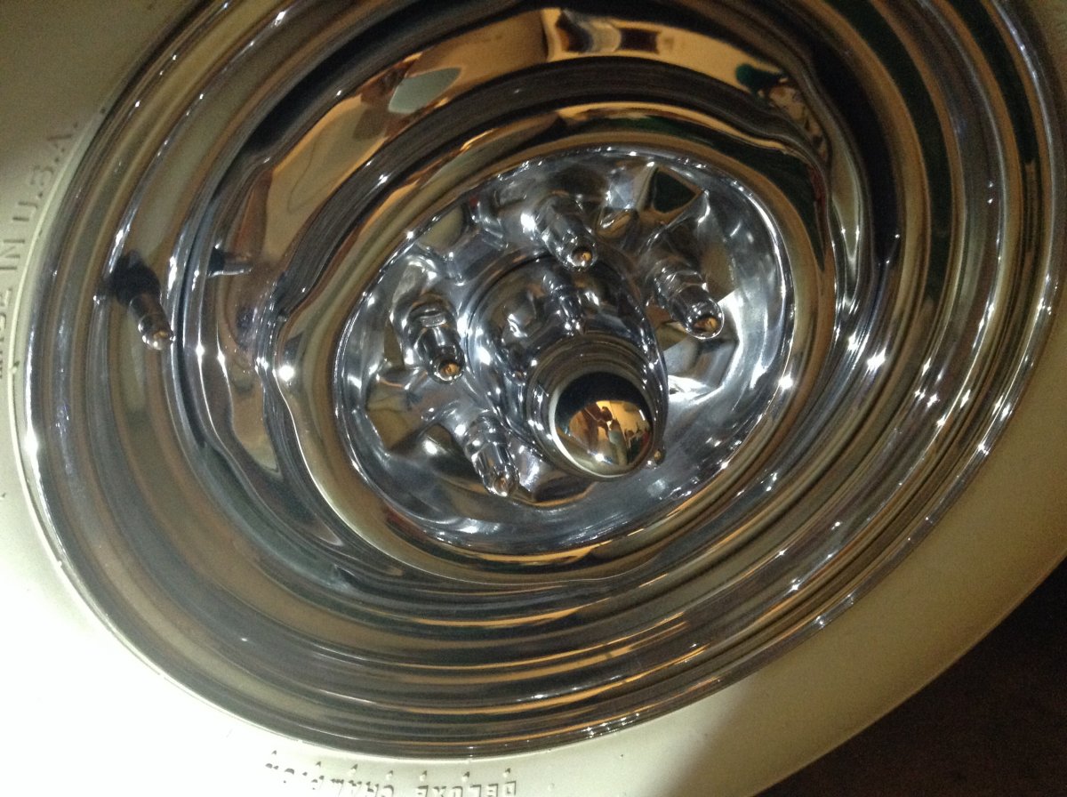

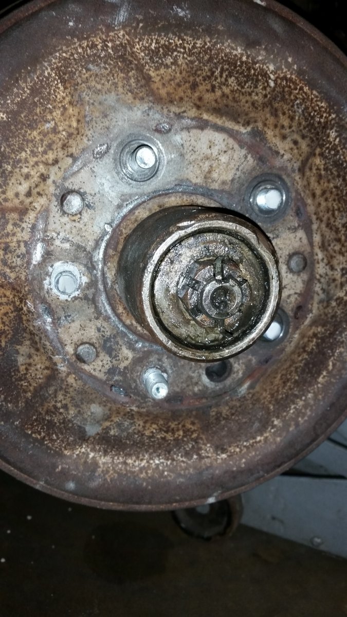

  5. Greaser Bob
    Joined: Mar 5, 2006
    Posts: 1,331
    Greaser Bob
    Good idea! The first picture is of the lug nuts that are not Popping off the rest of the car.
    The second picture is of the last two that popped off.

    How about a couple pictures of the hub, and the back of the wheel, when the wheel is off the car?
    As Rich mentioned, it could be that something is in the way of the wheel sitting flat on the hub/drum. Also, if the wheel is not seating on the hub fully around the area where the nut is, then the wheel will flex as you tighten the nut, and will never actually get "tight".
    Lug nuts need to be tight. Properly tight. I always use a torque wrench nowadays, and haven't had one get loose for a long time.

    Yah the oem style lug nuts seat real nice.

  19. I'll vote for this, with the added comment that the center bullet you're running is probably adding to the problem.
    Atwater Mike likes this.
  20. Ole don
    Joined: Dec 16, 2005
    Posts: 2,915
    Ole don
    The picture of the stock nuts shows one problem. You should have two full threads stick out beyond the nut when tight. This leads one to think like those above, something is holding the wheel out from flat against the hub. I like to put a dab of grease on the threads so they cant rust on. I use a torque wrench on all lug nuts. My fords and the wife's Buick get 100 lbs ft.

    Posts: 10,020
    RichFox
    I think this is probably what you are going to find. A few threads should be showing with the stock nuts. Your wheel appears to be not seated.

  27. R Pope
    Joined: Jan 23, 2006
    Posts: 3,309
    R Pope
    It's not clear if it's the same two studs that break? I would put a daub of paint on the new studs and see if they are the ones that break, or if it's two other ones. Are they always right next to each other? Also a daub of paint on the wheel as an indicator, too.
    I used to drill my hubs and axles out on my old Chevys and use bigger studs, too many small studs sheared off over the years.

  30. Greaser Bob
    Joined: Mar 5, 2006
    Posts: 1,331
    Greaser Bob
    Actually three broke-I thought it was just two until one broke off in my hand this afternoon!
