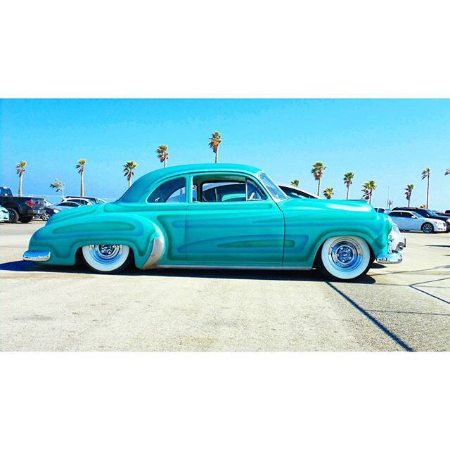

    image.jpg Drove over some ****py freeways, bridges, and surface streets this weekend to attend The Horton Hayride in San Pedro and NO lugs or studs popped off! Here's a little pic of her there enjoying the amazing weather we were blessed with.
    Thanks again for all the help-hopefully this is behind me!
