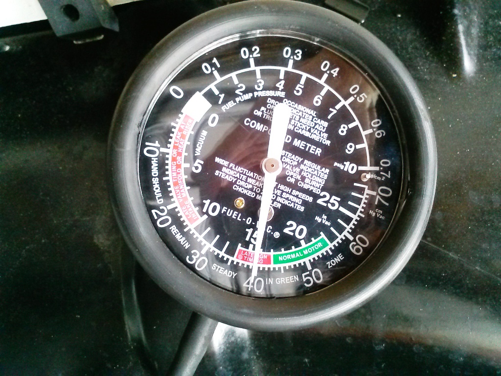

    Vacuum is pretty good (see image)

    Your gauge says late timing, and the normal range is 17-22, you are at almost 16. Try adjusting the timing. What did you fix just before the problem started?

    I have and to be honest, the car runs and starts the best where it is currently set. Don't know how much faith I have in that gauge as far as pinpoint accuracy, it's from Harbor Freight.

    Try timing it with the vacuum gauge and see how it goes.

    I have tried advancing the timing to 10d ATDC which increases the idle and puts the vacuum gauge just in the green. The idle still has a stumble when applying the brakes though. This also causes the car to hard start. So I put it back to 5d ATDC
    I have also tuned the carbs air screws via the vacuum gauge as well (adjusted until highest vacuum is achieved.)

    Idle is at 450rpm, timing is at 5degree ABTDC and vacuum is now at a measly 12 (should be around 20 from what I understand).

    You should have a little better vacuum at idle. The specs call for 5* BTDC, not 5* ATDC. Late timing will drop the vacuum as you've noticed.
