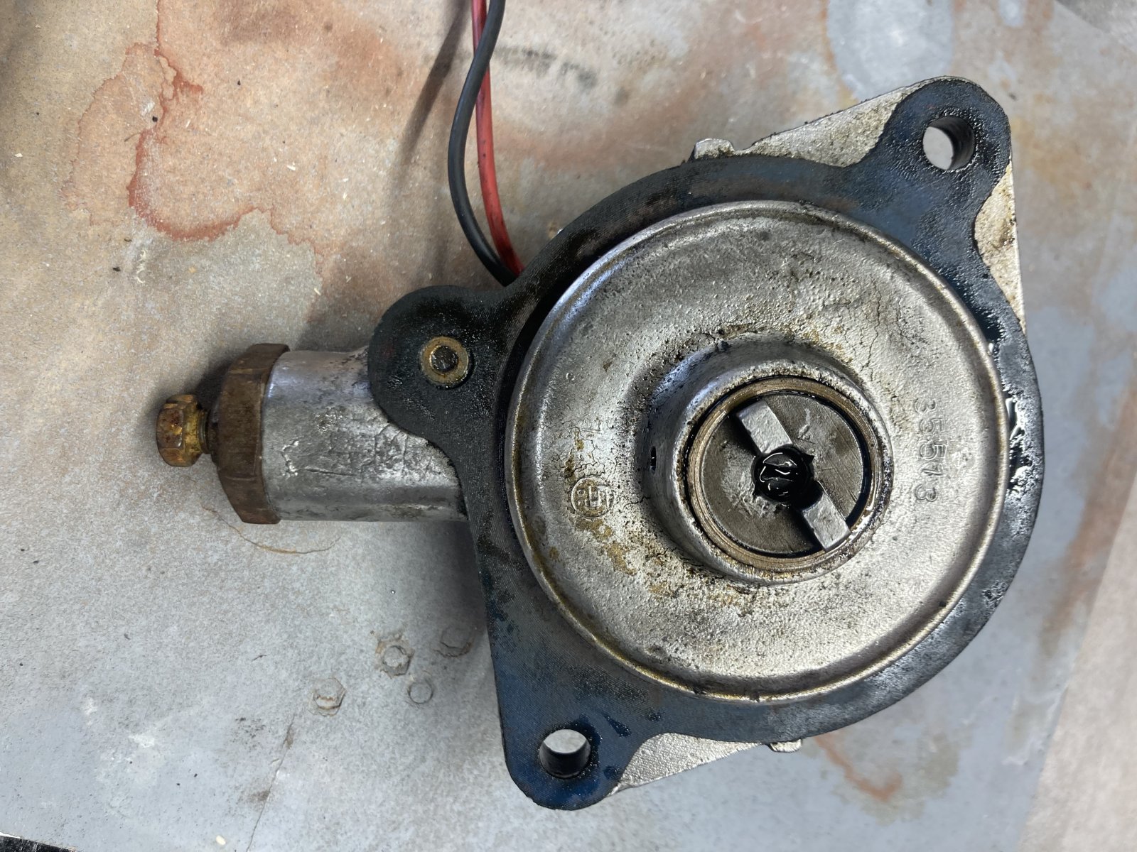

    My 29 roadster began running poorly last week
    manly felt like a lose of power and like it was running on 6 1/2 cylinders
    I have installed new plugs n wires with the addition of a flame thrower coil
    (been wanting to upgrade for a while)
    runs better at low rpms like up to 2000 rpm, very smooth and can feel the power
    After that it stumbles badly, I isolated the secondary 97 and it was the same
    I pulled the distributor (crab style), now I’m not really sure how the advance work but I suspect that the advance may not be operating properly, I need an education of how this little devil works

    Hopefully, someone who is a real expert will chime in, but I'll get you started. The "advance" on these is actually "vacuum brake". It is in the protrusion on the left side of your picture (which looks like it has had no attention for quite a while). Take the big cap off, and there should be a floating piston inside, backed up by a spring. The piston presses on a disc rotating inside the distributor, and the friction keeps the weights from advancing the timing under periods of low vacuum. Under high vacuum, the piston is pulled back, allowing the weights to advance the timing. There should be a tube connecting the intake manifold and the distributor that supplies the vacuum signal to the distributor.
    What could go wrong? The floating piston may be sticking. Freeing it up and lubing it may help. The spring could be missing, broken, or weak. The vacuum tube from the manifold may be missing or leaking. There should be a thick leather pad on the inner end of the floating piston that my be worn or missing. It acts kinda like the lining on brake shoes to increase the friction on the disc. (I procured some special 1/4 thick leather and made some of these discs for myself; I may have one or two extras floating around). The hex-headed screw on the end of the hex cap is for making fine adjustment to the mechanism when you get it working.

    The vacuum brake tube connects to the upper left edge of the front cover, then to the intake. I see two wires coming from your distributor. Where do those go? Do you have some type of electrical controlled ignition?

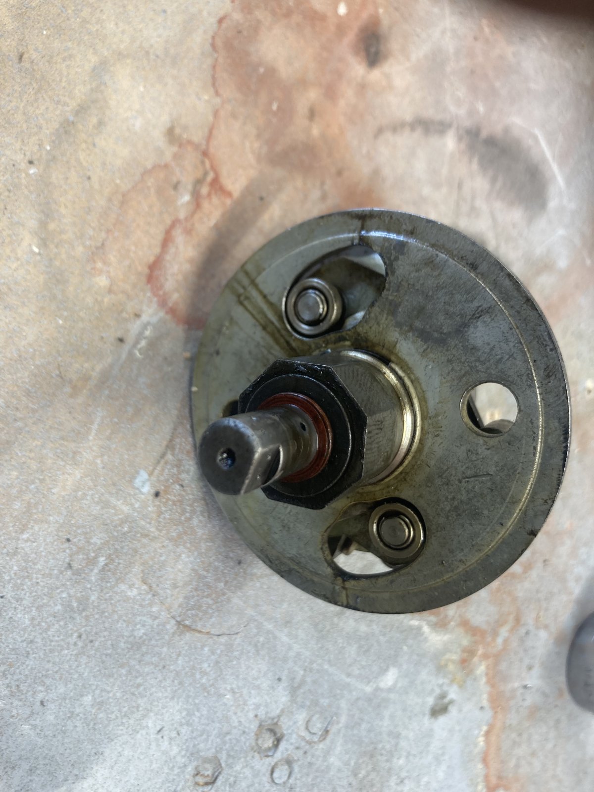

    good eye Mr ripper, I may indeed switch this back to points but for now I would like to either find the problem or most likely suspect at this time.
    It has been my experience that the pertronics either works or you have nothing.
    I have removed the end cap from the vacuum damper and found nothing
    This thing has been modified and fortunately I can contact the original owner and find out what has been done to this distributor.
    I pulled the distributor apart and found no indications of a problem
    so
    Unless the module is breaking down I believe I may be barking up the wrong tree

    Pertronix units either work or don’t work at all if it has failed. Your issue sounds like the problem caused by running the wrong coil for your module.
    Only run the coil Pertronix pairs with your module.

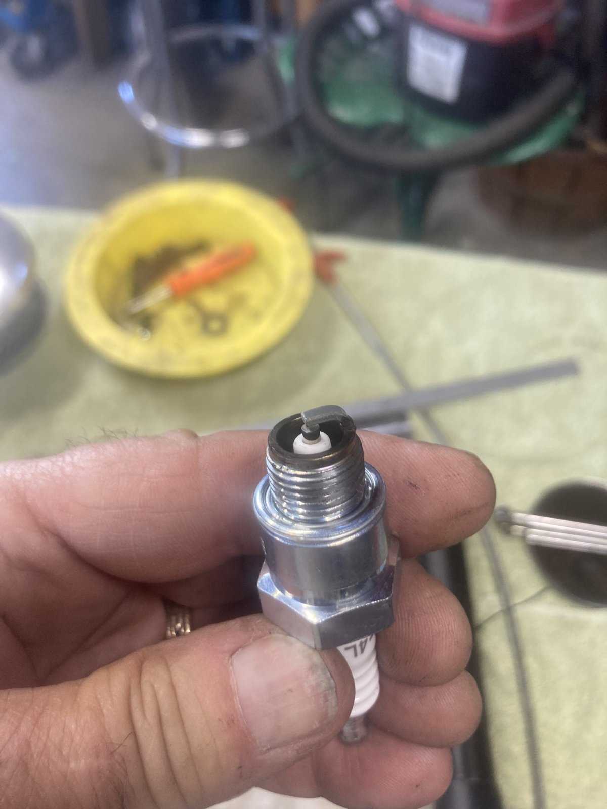

    I'd do a compression check and inspect/compare your spark plugs while they are out.
    If all the plugs look fine, I'd install an exhaust bung and get an air/fuel ratio guage and see what it tells you. Doesn't have to be a permanent install.....except for the bung. I'd also check all your ground connections, and check your float level. Floats have been know to cause the kind of issue you have. Had a friend who crashed his airplane on its maiden flight after a 2 year rebuild because the reconditioned and certified carb had a bad float.

    From what you say and I can see, someone has completely removed the vacuum brake ***embly from that distributor. Henry Ford never wasted money on anything that wasn't absolutely essential to the vehicles operation. Get the Pertronix out and a vacuum brake back in. The way it is, it probably goes to full advance immediately, unless they screwed with the advance ***embly as well. That distributor looks like a disaster. You would probably be better off getting a different one that has been properly set up. And no, I don't mean an aftermarket electronic unit, but a genuine Ford unit, properly set up on a machine designed specifically for the purpose. You might start with Michael Driskell at Third Generation Automotive in Tennessee; they have an excellent reputation. As I said in an earlier post, timing is important.

  11. Whomever built that distributor needs to go back to Flathead school and learn how they work. Pertronix just replaces the points mechanism, the advance mechanism and vacuum brake need to be operational and working just as it was designed to work. When you pull the vacuum brake the advance mechanism will "flop around" and timing goes all over the place.
    BUT - if it was running well before (even if the advance mechanism wasn't correctly responding) and now it isn't, then this is not the problem you're currently chasing. I'd start with a rebuilt and tested distributor from Michael at Third Generation - you'll bolt it on, and the dang thing will work (and have the correct advance setup).

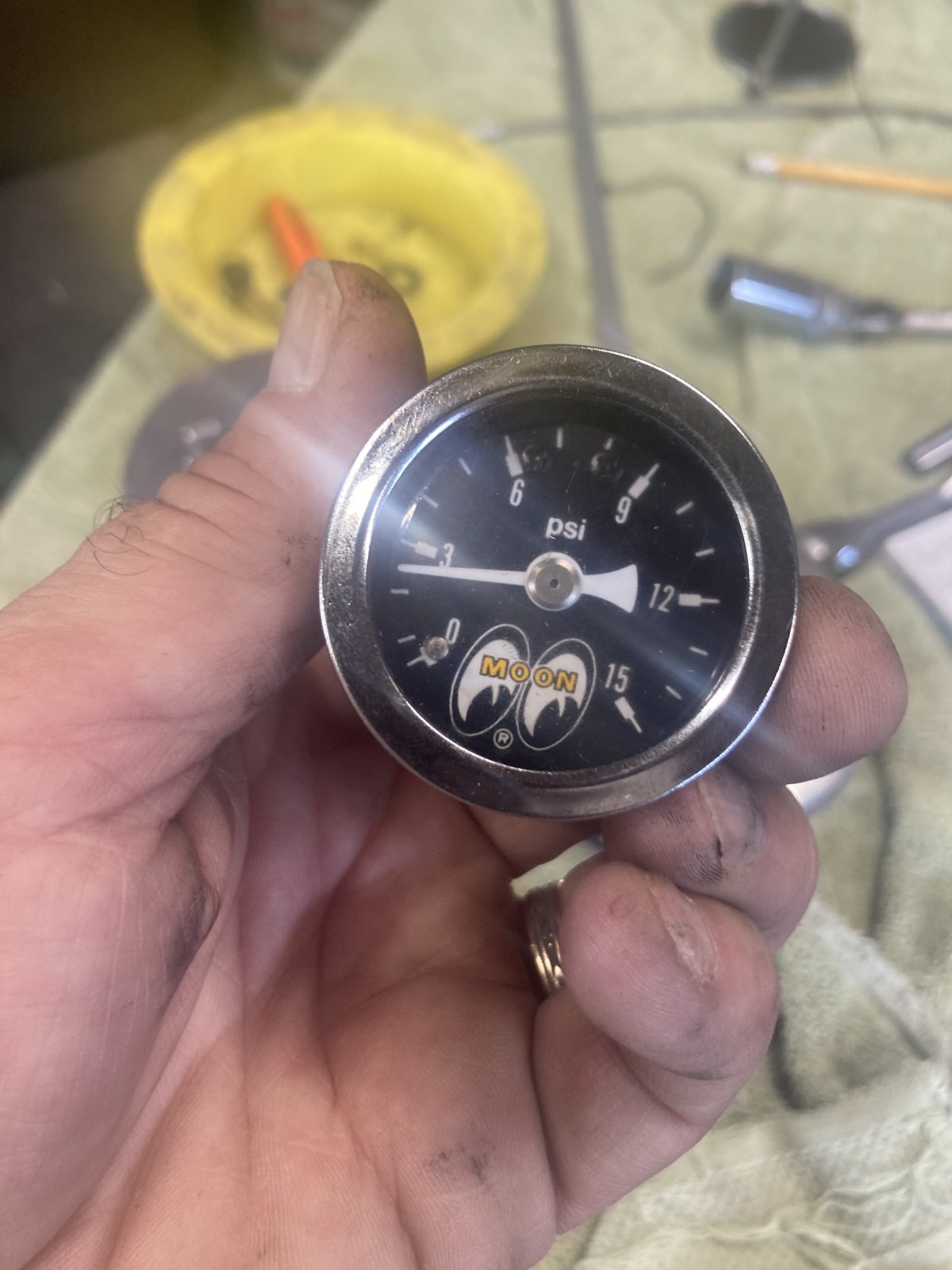

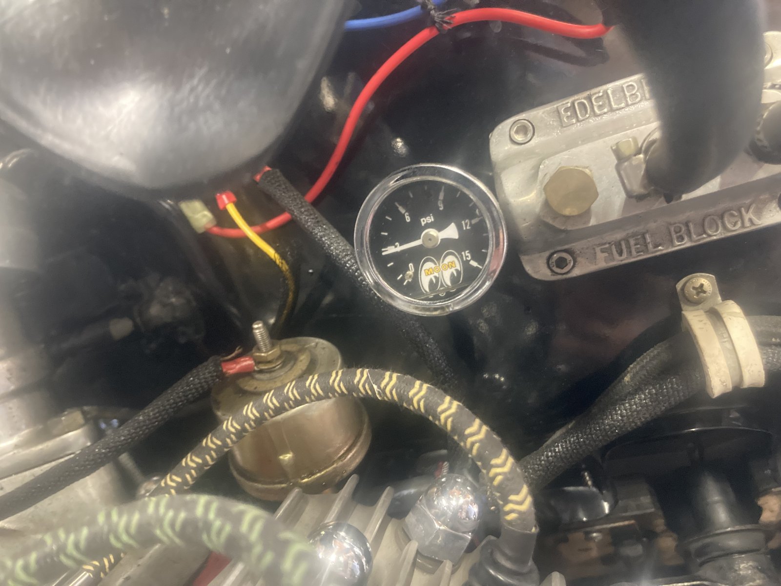

    The fuel gauge on the fuel manifold shows good pressure
    must be a magic gauge
    Unkl Ian and jet996 like this.
  22. That gauge is for fuel economy purposes. It guarantees good solid fuel pressure - without actually requiring there to be any fuel in the system. Please send it my way . . . I need to save on gas! LOL

    Why anyone would start chasing other problems when the distributor is in as bad shape is that one obviously is baffles me. Especially with the fuel pressure that is showing. Trying to solve multiple problems at the same time is a fools errand.

  24. Hey Tubman . . . the joke is that his gauge reads fine . . . when it is out of the car. ;)

    the plugs are showing lean and there has never been any popping out the exhaust or after fires

    I replaced the electric fuel pump and gauge at the manifold (used)
    I have zero psi at the manifold with the new pump, there is flow to the carb but the needle never moved.

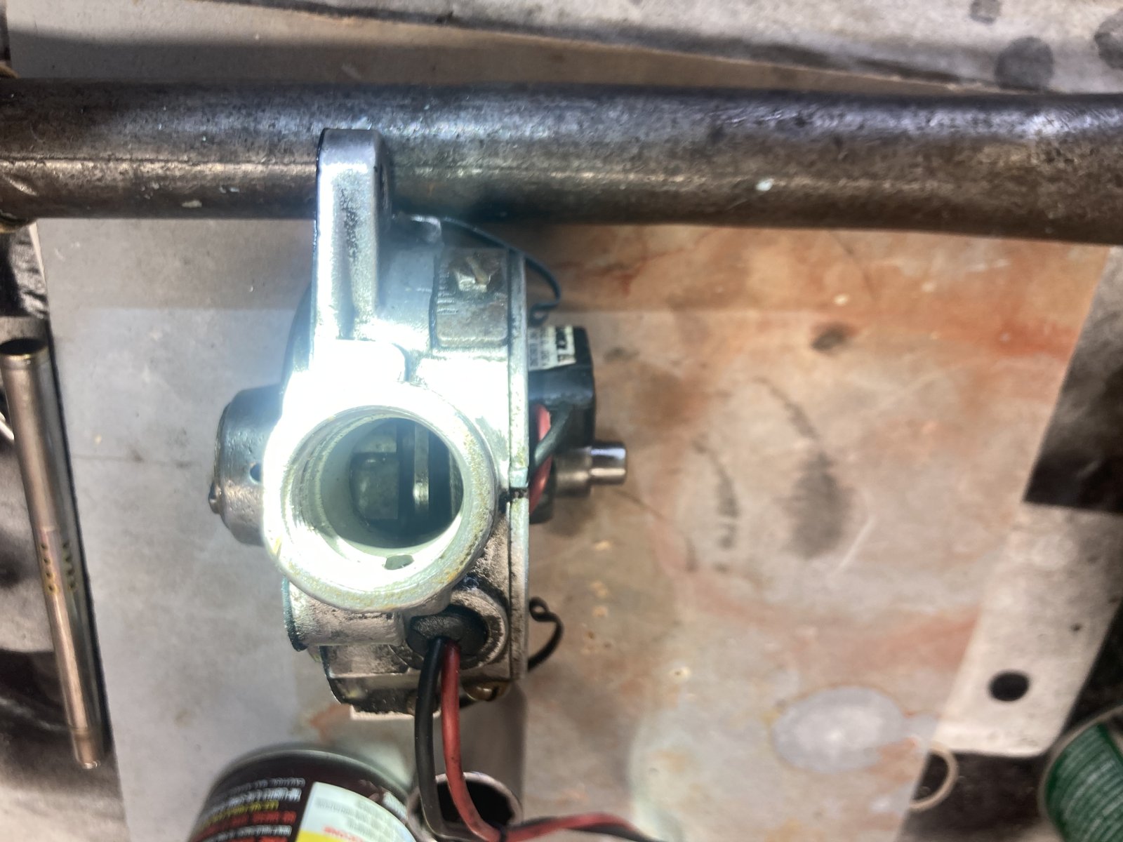

    I have a Holley 12-804 fuel pressure regulator between the electric pump and the manifold
    I wonder if it is letting me down
    Anyone have any experience with these?

    I have one of those regulators too but it has never stopped regulating. Is yours adjusted too low? You did notice the In and Out markings on the regulator, right?

    I installed the new gauge at the manifold and there is 3 psi even at higher rpms
    evidently the gauge I replaced the magic gauge is bad
