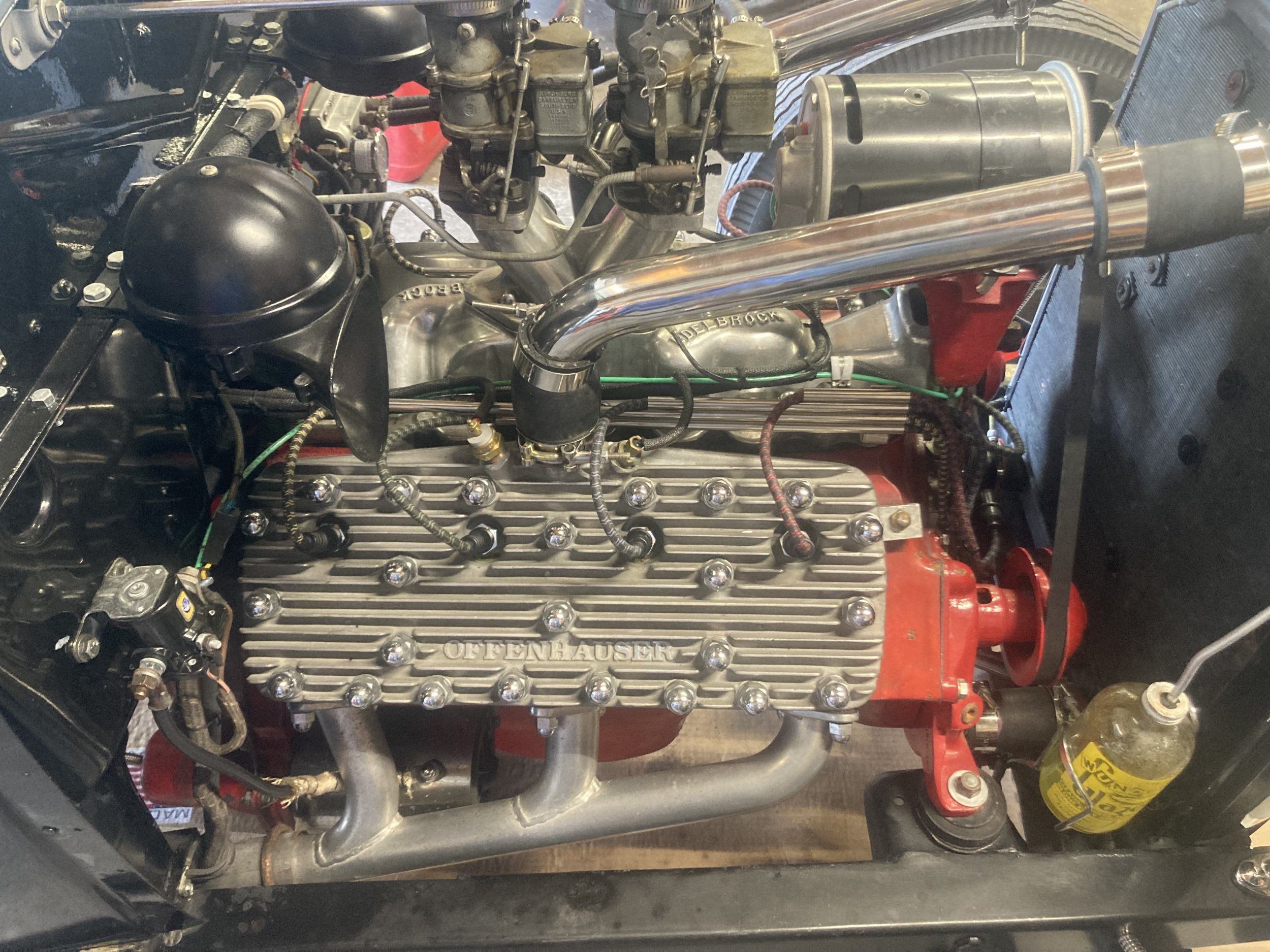

    Im looking in to this as well, @FritzFord may have the answer, the engine was fitted with 3 ohm coil so I replaced it with a 3 ohm Flamethrower coil, turns out it’s for a 4 or 6 cylinder engine. The 1.5 ohm Flamethrower is for a v8 engine. I didn’t want to post this because the mods may delete it.

  3. It is possible - so I'd raise the float level until the fuel is just under 1/2" from the top of the main casting. Given that it started stumbling all of a sudden and the fuel system has not been changed, I doubt this is the issue - but set the float levels correctly anyway.
    It has sounded like a distributor/ignition related issue all along - but it is always good to checkout your fuel system while you're in troubleshooting mode.

    Thank you for taking me seriously Cspidy. I’m not making this up, it is directly from Pertronix. They have good customer support if you want to ask them too. They make great modules, but like many other things, they are designed to operate in a specific way. When you set it up as they instruct, they work great.

    This statement is absolute nonsense. It's about electrical load, not the number of cylinders.

    I spoke to Pertronix tech service, he explained simply as with the 3 ohm it takes a longer time to reach the 40k volts and at higher rpms the discharge voltage is much lower the faster you are spinning the engine.
    Evidently these flamethrower coils are not like the stock coils, I reinstalled my original stock coil and the stumbling is gone.

    I did adjust the float level in the primary 97 to 1/2 inch down to the top of the fuel level.
    I also found the secondary 97 has a bad power valve, so I ordered 2 rebuild kits for another days work.

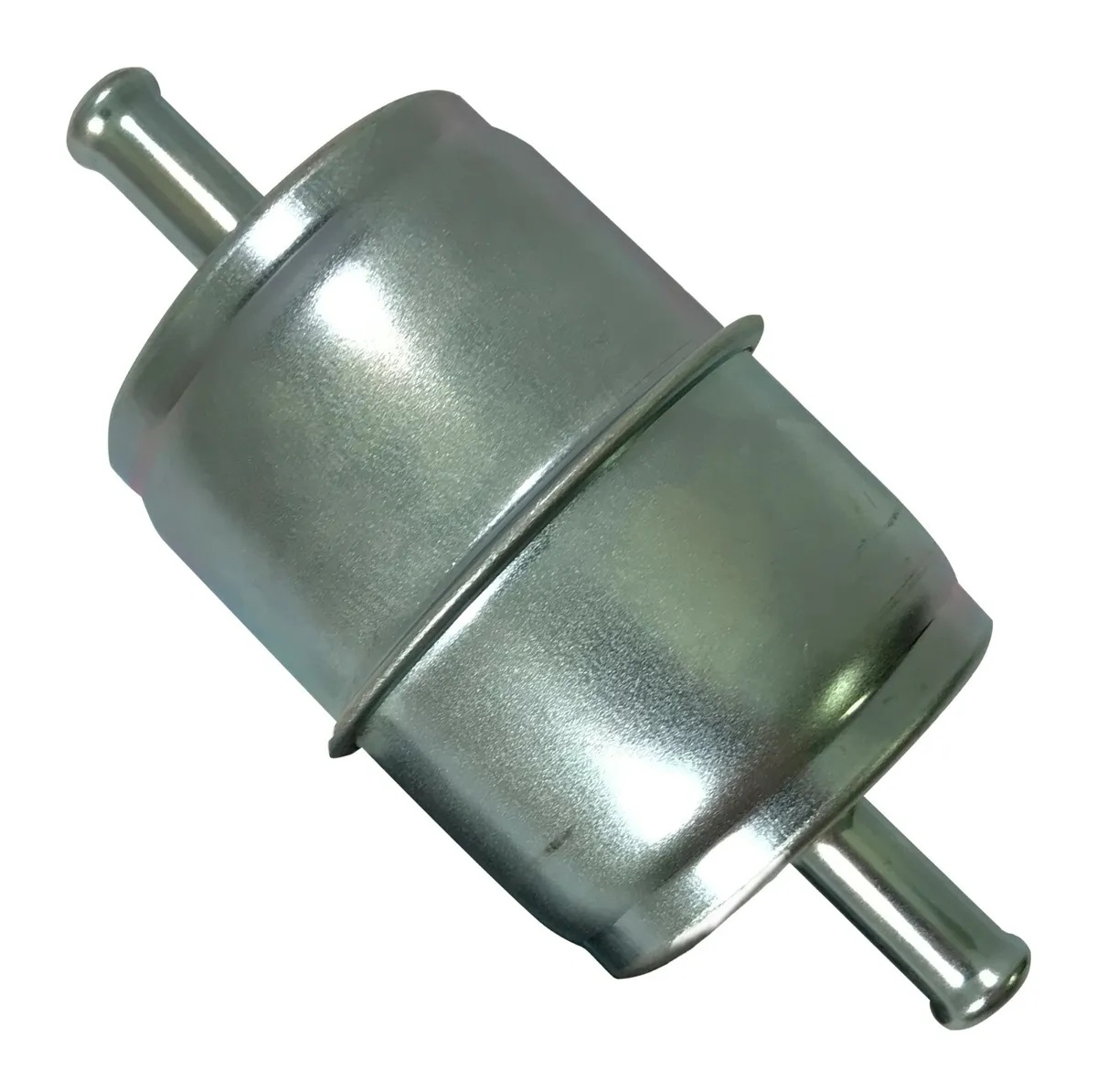

    Are you running an inline fuel filter...that caused me grief like that 2 times...glue that holds the filter disintegrated and choked the inlets on the carb with chunks of glue...but before that the filter periodically settled over the inlet to the pump and choked the fuel causing the car to start suddenly lose power at speed...
    I read it here to take the filter off drain and shake...mine was like like a rattle...

    I am running the inline filter that came with the electric fuel pump, through the troubleshooting process I installed my new spare, but obviously there was nothing wrong with the electric pump that was installed.

    The pertronics igniter module bit the dust the other day
    I spoke with pertronics tech service and found out the pertronics igniter modules don’t like metal core plug wires. They give too much EMI
    so
    I have another module coming as well as a used original distributor with points.
    I will be swapping the carbon core wires back in until I get the distributor with points set up.
    I believe this may have been my stumbling problem

    Well it official
    Don’t use solid core wires with pertronics igniter modules
    The first line in the instructions state this
    Reinstalled the carbon core plug wires with new igniter module
    and
    The engines runs like a banshee
