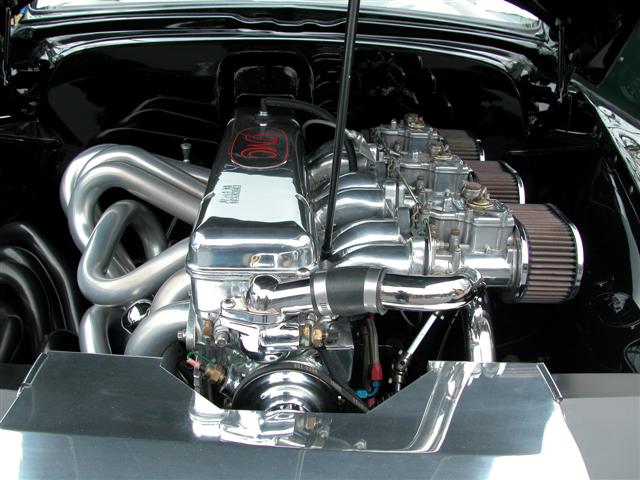

    This may sound stupid...literally. But I have a chevy inline 6 and a thought occured to me, if it would fit what would it sound like with three way headers?? One header for 2 cylinders? May be awesome, may be really dumb. I don't know, what do you guys think?

    Don't know about the sound difference, re: the above suggestion, but if I wanted to create the lowest "extraction" pressure in the two pipe collector, I'd use adjoining cylinder pairs, if their timing was 360 degrees apart. Then you'd have the velocity of each cylinder's exhaust drawing out the next pulse, from it's neighbor. If you want to create torque, you can run a smaller diameter than the typical single manifold pipe, as the volume of gas is less, and scavenging can be enhanced by upping the velocity.

    That's exactly what I did on my '69 fairlane with a 250 6cylinder. Look at the firing pattern and pair 'em up 360 degrees apart. I used 3 cherrybomb glasspacks. My uncle welded them up and it sounded pretty good.:D
