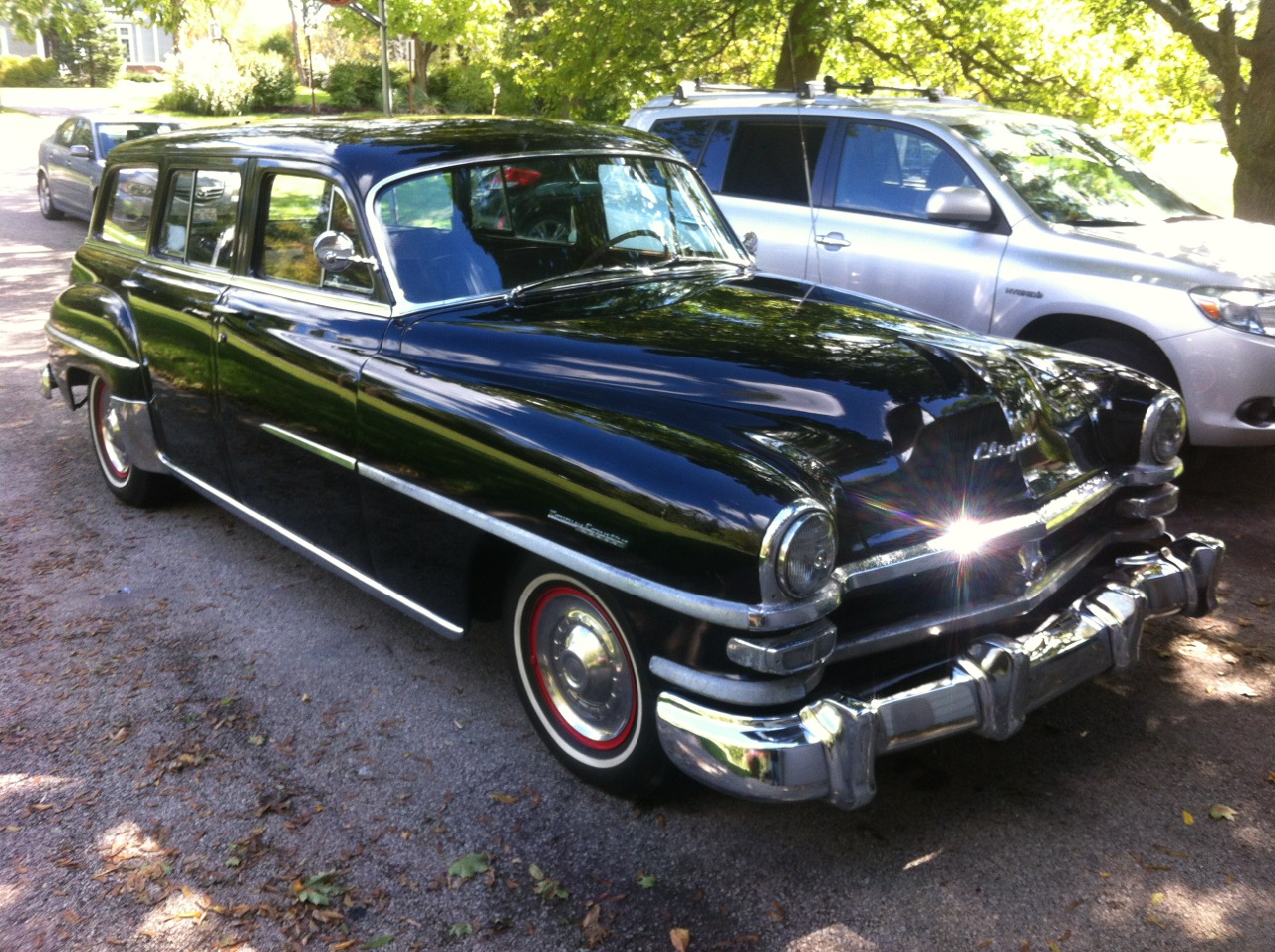

    Thanks Jim! Excited to breathe a bit of new life into it... it's been under-appreciated for a while, and we intend to change that.
  2. Torchie
    Joined: Apr 17, 2011
    Posts: 1,099
    Torchie
    Once you get that wagon and trailer combo together they will want to put it on the cover
    of the Airstream owners ***c. magazine.
    Looks great and have fun!

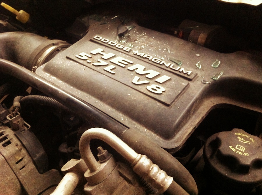

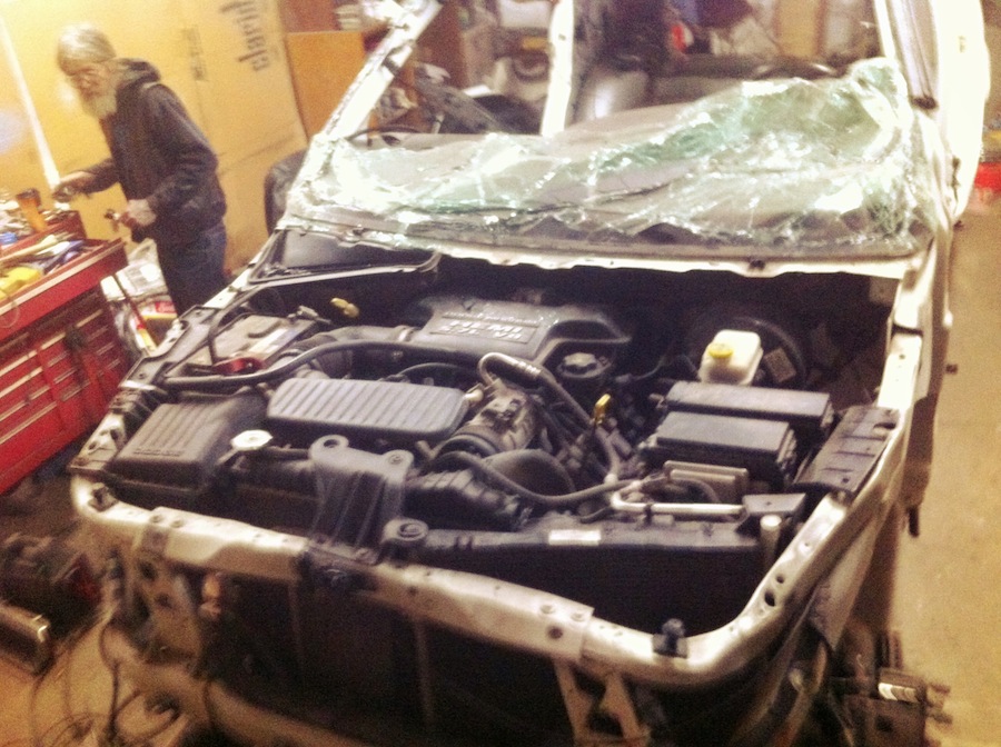

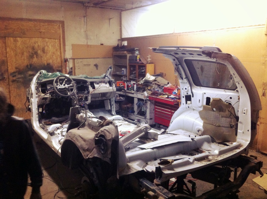

    Little update:
    I began the final push to strip the Durango donor vehicle this past weekend with a great, crusty ole' mechanic I found through a mutual friend. The original wiring harness was so intertwined with the body panels that we quickly gave up and chopped away what we needed to.
    I'm still hoping there'll be a way to keep the OEM computers, but they'll obviously need to be reprogrammed or chipped to ignore the missing sensors.
    The plan is to begin the big swap in a few weeks, early May. I hope to unobtrusively watch and do***ent some of the process with photos / video clips, if possible.
  15. Rusty O'Toole
    Joined: Sep 17, 2006
    Posts: 9,756
    Rusty O'Toole
    Frame swaps are a lot harder than they look. Measure carefully, you may find it better to transfer the engine, trans, rear axle etc to the original frame.

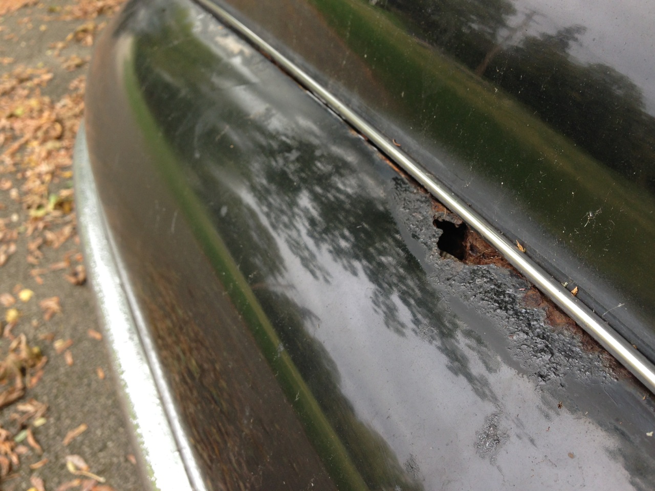

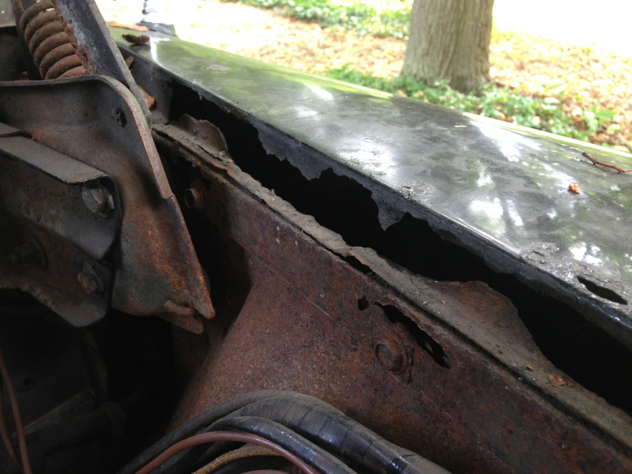

    I apologize to the few who've subscribed to this thread for all the back and forth this project has taken. It's been a long road but we've finally landed on a solid plan that won't require anything particularly extraordinary.
    Here's the outline with a quick recap:
    - The plan for the past year has been to mate the body of our 1953 Town & Country wagon with a stretched 2005 Durango ch***is, because the '53 had a rotten frame and we wanted the benefits of using a whole car and its modern features.
    - We began to realize the time and expense required to modify the Durango frame, and meanwhile discarded some of the original wiring harness in the process of cutting the body off.
    - Because of this, I began looking for an exact replacement frame from a similar-era wagon to sit under the '53 body. In September I found / bought a dry, rust-free '54 New Yorker wagon to use as our new donor.
    - Last week, at the restoration shop, we put the '53 on a lift and pulled out flashlights, magnets and screwdrivers. We found that our baby has lots of bondo, tons of rust, replaced rockers, and only two body mounts remaining. It's a beautiful car from outside... but a nightmare just beneath the skin.
    - Further inspection of the 1954 "donor wagon" proved that surprisingly... it's the ideal candidate. It lacks paint, has cracked windshield and awful interior - but also has no rust.
    That brings us to the New Plan:
    - We'll leave the '54 intact, promoting it from Donor to Project status.
    - We'll replace the rubber bushings in the body mounts and completely rust-proof the whole underside.
    - Then we'll update all mechanicals: Hemi, 5-spd, 12v harness, IFS, rack & pinion, new rear end, discs all around, custom heavy duty hitch, and air bags to keep things level when towing the Airstream. I'll put in as much insulation as I can afford, to try and make this a very luxurious, quiet ride.
    - Lastly, the '53 will now become the organ donor: offering up its perfect interior, headliner, dash, gl*** and trim. After paint, we should have a fun daily driver, and a long-distance tow vehicle that's easy to maintain when we're far from home on road trips.
    Photos show the first impressions... and the pair's fender flanges, which tell the real story.

  22. squirrel
    Joined: Sep 23, 2004
    Posts: 59,928
    squirrel
    Interesting....and proof once again that it pays to do a thorough and careful inspection on any old car you buy, so you know what you have.
    Since this thread was in limbo, I got my own Suburban tow vehicle/daily driver going. It's a 1957 Chevy suburban (carryall), which I've had for 15 years and finally finished a few months ago. I've since taken it on several trips, it has logged over 10,000 miles since the end of July. That includes one trip to Kentucky, towing my 55 Belair. I did modernize the front suspension and brakes a little bit, with an early 70s Camaro subframe, but most of the rest of the truck is quite old fashioned...57 Ford 9" rear, TH400 transmission (no overdrive), the interior is almost completely original, etc. The truck gets decent mileage (stock 350 engine with Qjet carb and HEI ignition, circa the late 1970s) and drives nice. I haven't had to fix much on it yet, either.
    Don't get too carried away with improvement and modernization....just get the damn thing done! I sure wish I'd finished mine when the kids were still at home.
