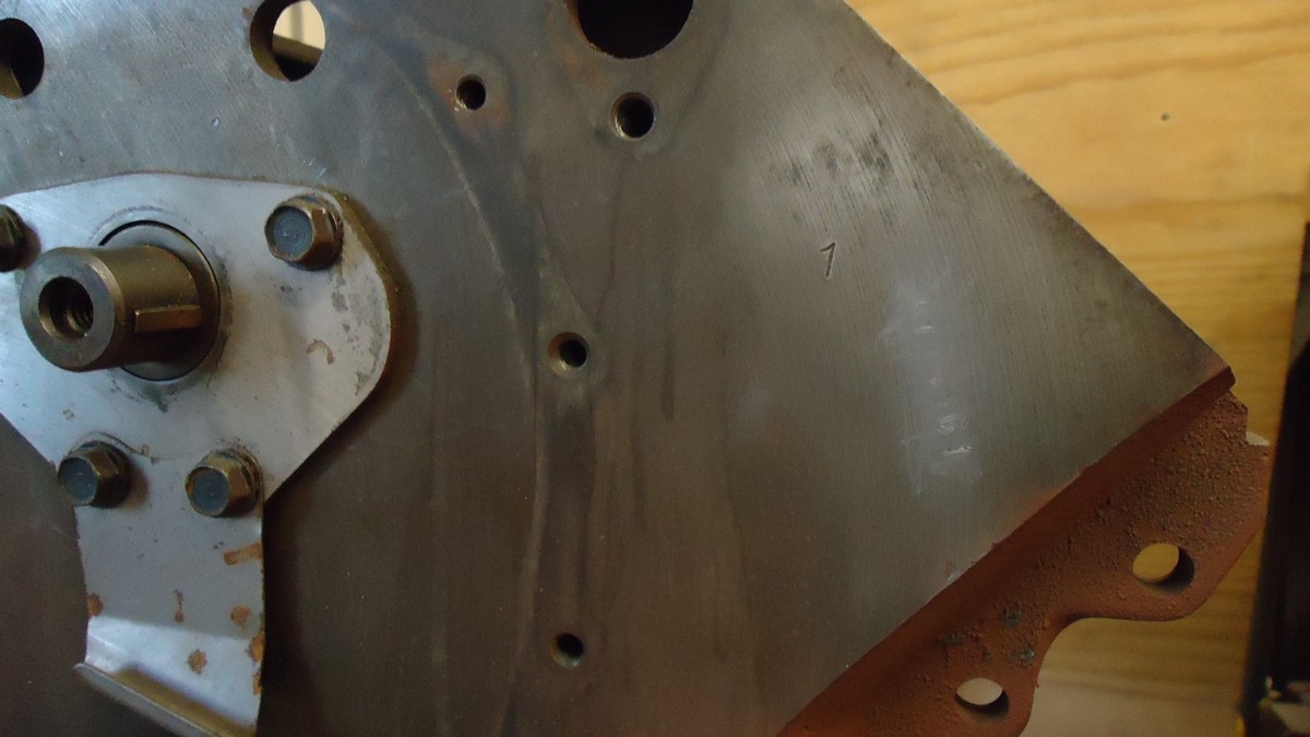

    The 331 Industrial that I bought did not have the number in the "usual" place; rather, it was stamped on the very front of the block on the left (driver's) side....not very deep either.
    ...musta been a Monday morning on the ***embly line 331 HEMI sn 6714561_1.JPG
    I then stamped the number into the block on top at the front in the "usual" location.
    It was "in pieces" when I got it along with the Chrysler Industrial valve covers and there is no reason to suspect they were not original to it. These Industrial engines were frequently used for irrigation pumps in the midwest.

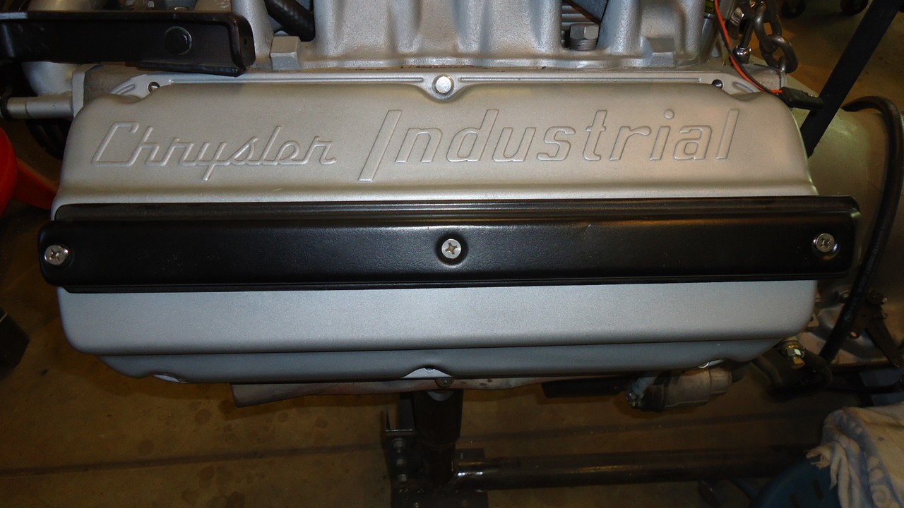

    This is not a long-block engine; I believe it is a '56. Paint scheme is preliminary.... trying to figure out a way to silk-screen (?) the "Chrysler Industrial" black also.
  19. loudbang
    Posts: 40,346
    If the area of the letter is flat or just barley curved cut a chunk of cardboard wide and deep enough to cover the lettering tape of the rest but no need to cover everything just to prevent slop.
    Now grab some spray bomb paint of the color you want and spray a nice WET coat onto the cardboard. Then carefully either place the valve cover onto the wet paint if the area is flat and presto paint on the raised lettering.
    If it is slightly curved do the opposite and after checking to maker sure the paint is not dripping put the painted side of the cardboard down onto the lettering CAREFULLY and them lift it off.
    A small paint brush can be used to fill in any spots not completely covered.
    30dodgeboy likes this.

    Yes, some truck engines have use codes there, 1st report I've seen of an IND having one there. I have a block with random numbers ****tered in that location.

    Was thinking along those lines
    Have some surplus treadmill track that I've glued/attached to a narrow board. Going to try using that, but have to keep it from smearing as it's applied.

    How to hi light the lettering on a valve cover, license plate etc.
    Spray paint the lettering color, paint the whole item with a good thick coat of paint.
    Spray 1 or 2 thin coats of the background color, just enough to cover.
    When it is good and dry rub off the background color from the letters using rubbing compound. It is easy to follow the shape of the letters with your finger.
    You can also try rubbing the paint off when it is wet using a rag, dampened with reducer, wrapped tight around a finger tip. But, it is easy to mess up the fresh paint. If you have steady hands you might remove most of the paint with a quick wipe, come back after it is dry and detail it.

  28. loudbang
    Posts: 40,346
    Yea it takes a steady hand and a lot of looking and checking with the dry cardboard before paint is applied. Try and get everything set go straight at it and try not to wiggle too much. :)
    Some people have had good results using a small roller.
    hotrodtom likes this.
  29. hotrodtom
    Joined: Apr 14, 2005
    Posts: 231
    hotrodtom
    Go to an art supply store and ask for a small rubber roller called a brayer. Works well for transferring ink, paint, etc to a raised surface like a license plate or Hemi valve cover.
