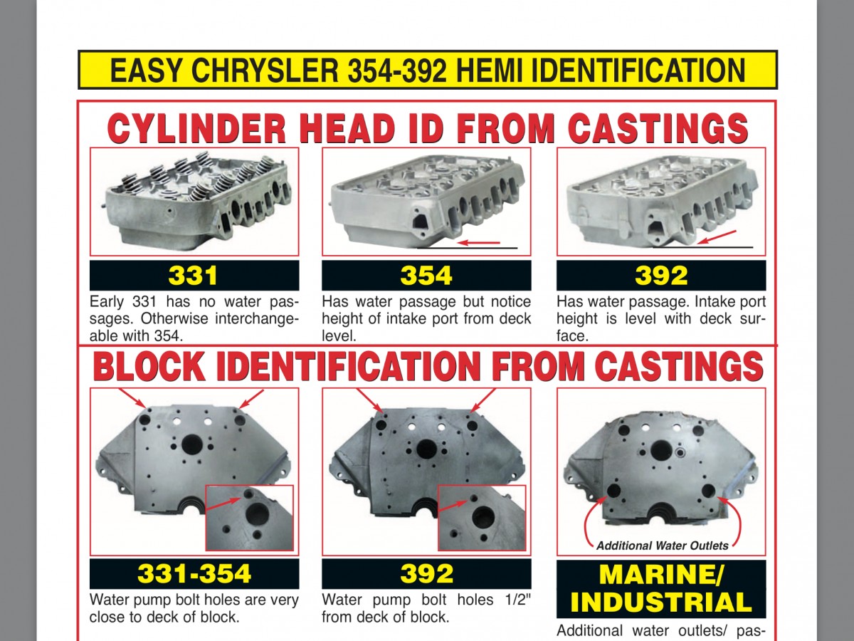

    regarding
    mgtstumpy 's post
    now I'm confused.....

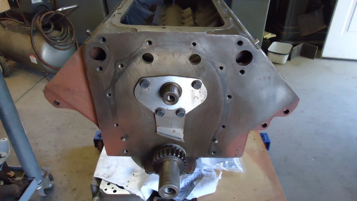

    These are pix from the 331 Industrial that I have. I measured the bore (.030 over) and the stroke.
    Obviously the heads on mine have water ports; whereas the illustration above says that 331s don't.
    Is it possible they put 354 heads on some Industrial versions?
    And this is the water pump that came with the engine.
    Secondly, the illustration above notes that Marine/Industrial blocks have lower water p***ages, whereas mine don't. The water pump didn't have ports there either. 331 engine front.JPG
  25. Yes 354 heads will go onto a 331 block.
    1955 331 heads have water ports.
    What year is your stuff?

    From available information collected on the 'net, the block numbers 1619629 & E175
    indicate a 331 and that it was cast May 17, 1955
    so, that would explain the water ports.
    Thanks

    Many industrial engines used the same timing cover and water pump as p***enger car engines that were being produced at the same time. There are countless myths and tons of bad info out there regarding "rules" of what was built, including the PAW catalog screenshot posted above. I own a few examples of what you have pictured above - a block casting that was intended to be machined to a 354 (3-15/16" bore), but only bored to 331 size (3-13/16"). Keep in mind castings made in mid-1955 were intended for 1956 car model year production. Industrial engine production piggy-backed on what parts were available at that specific time. I have a 1957 331 industrial that uses the same water pump, water crossover, oil pump, etc as a 57 392 engine (which was a car engine, never available from Chrysler as a marine, industrial, or truck engine) would have used. In other words, not all 331s were built one specific way, 354s built another way, etc. The other thing to keep in mind is that over 60 years things can get changed around, so one needs to look at unmolested originals before drawing any conclusions.
